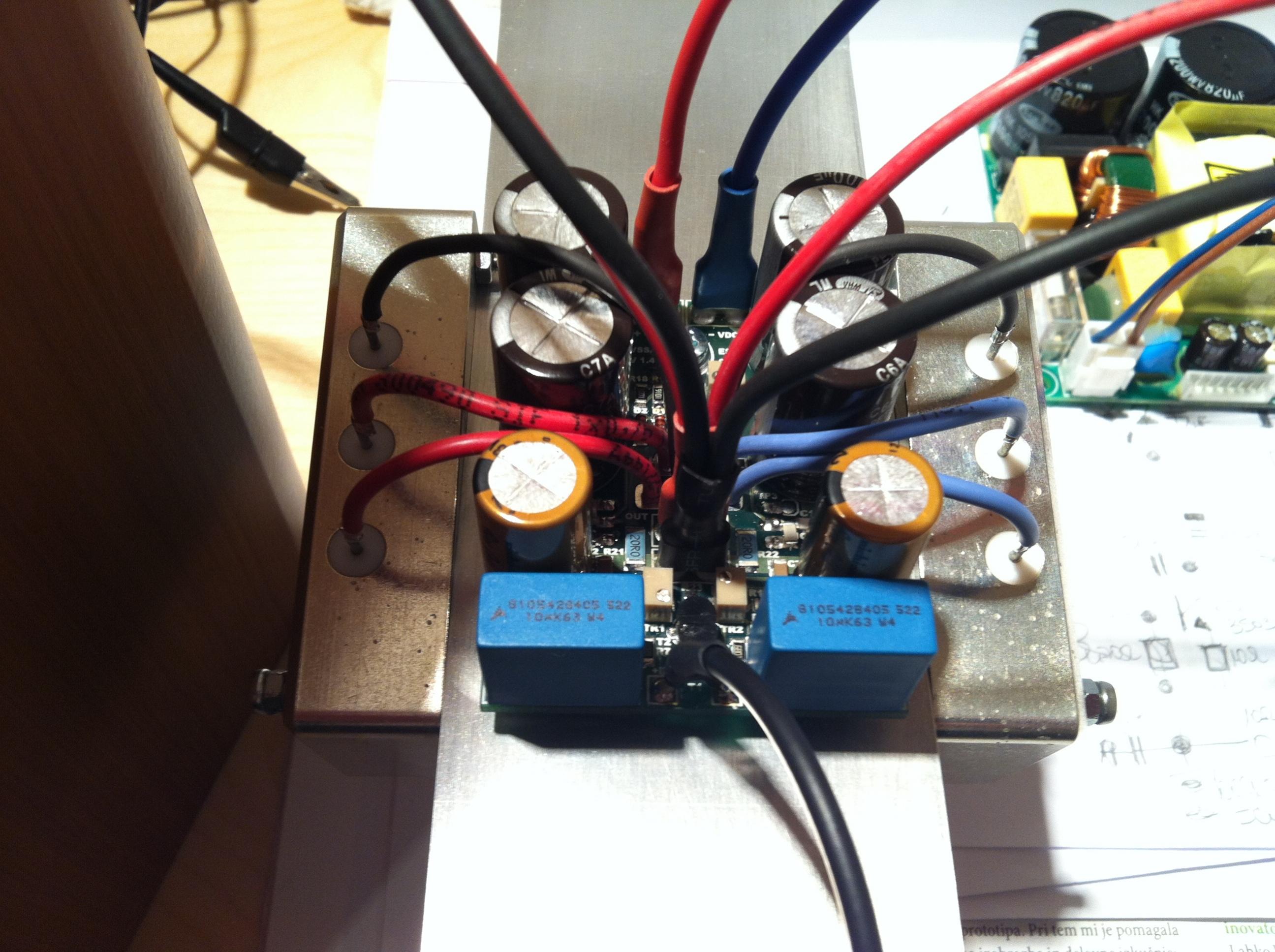

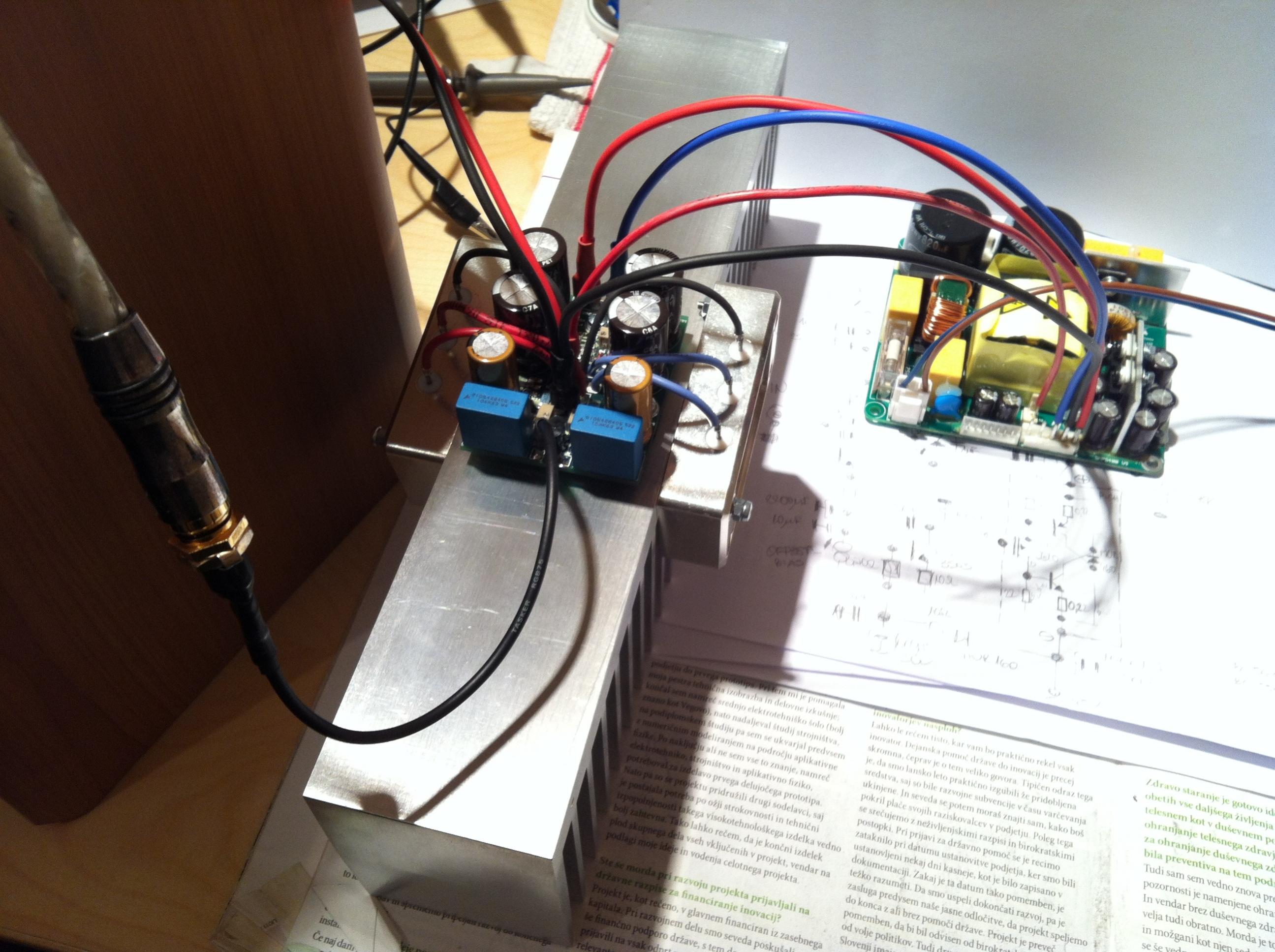

VSSA Lateral MosFet Amplifier
Wow,Maybe is the angle of picture, but those terminals look way too close to those caps. Do you have enough room to connect power to those terminals?
Ya, they're quite close but still manageable.:)
I just received 2 sets of SMPS500R from connexelectronic and parts from Farnell. Looks like this few days need OT to complete it.:D

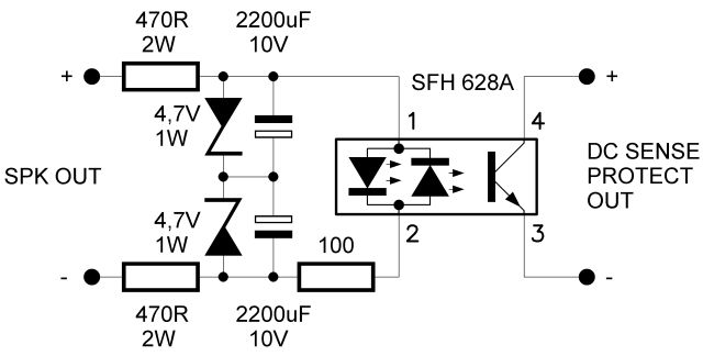

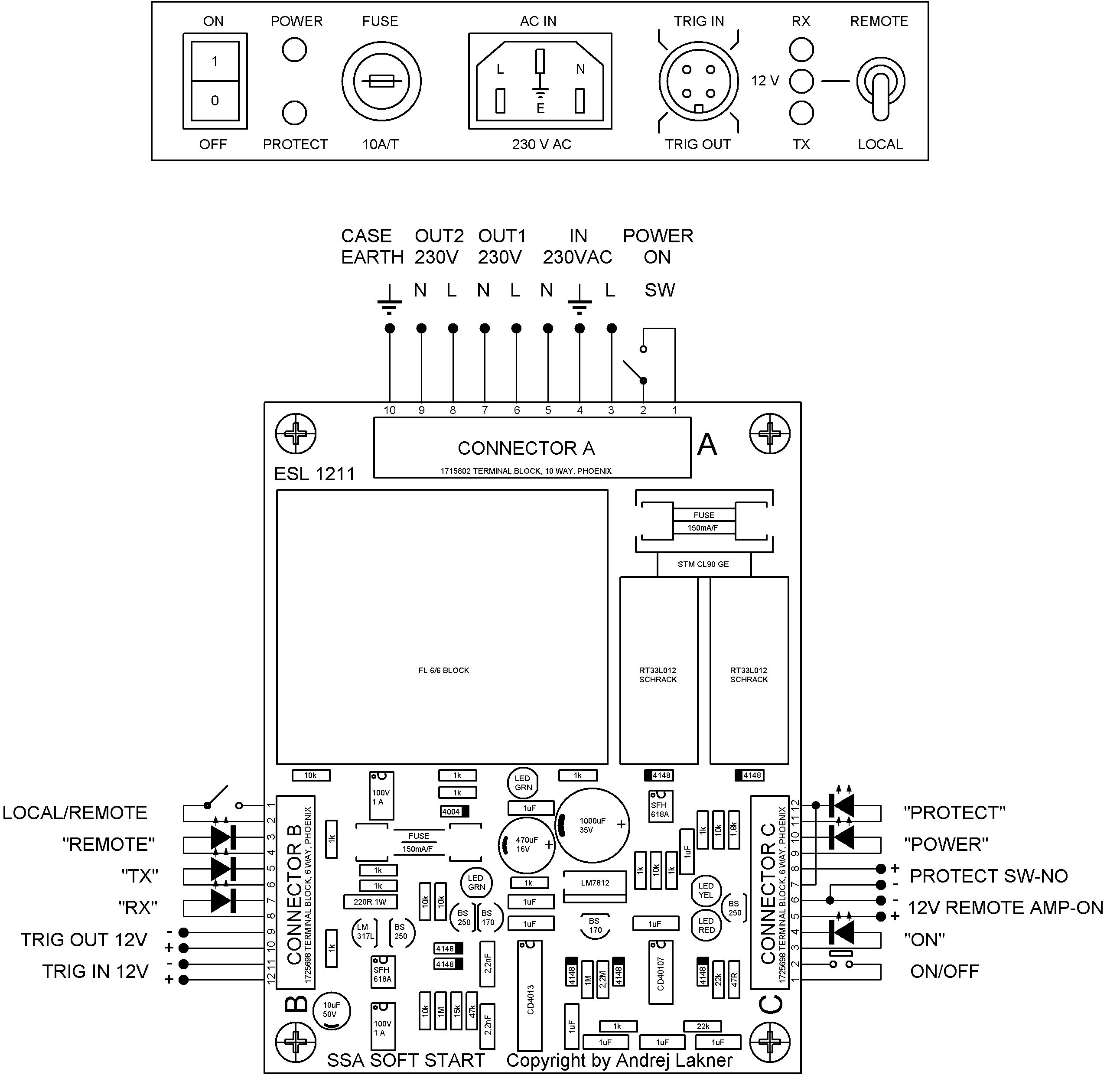

Andrej I need your help, I have the SSA DC SENSE from Supernet (another Andrej :D), can you please let me know how to interconnect to VSSA? Thanks in advance.
Hi Junie :wave:
Here's what would help you out. DC Sense Protect out connect to Connector C pin 6, 8. ;)

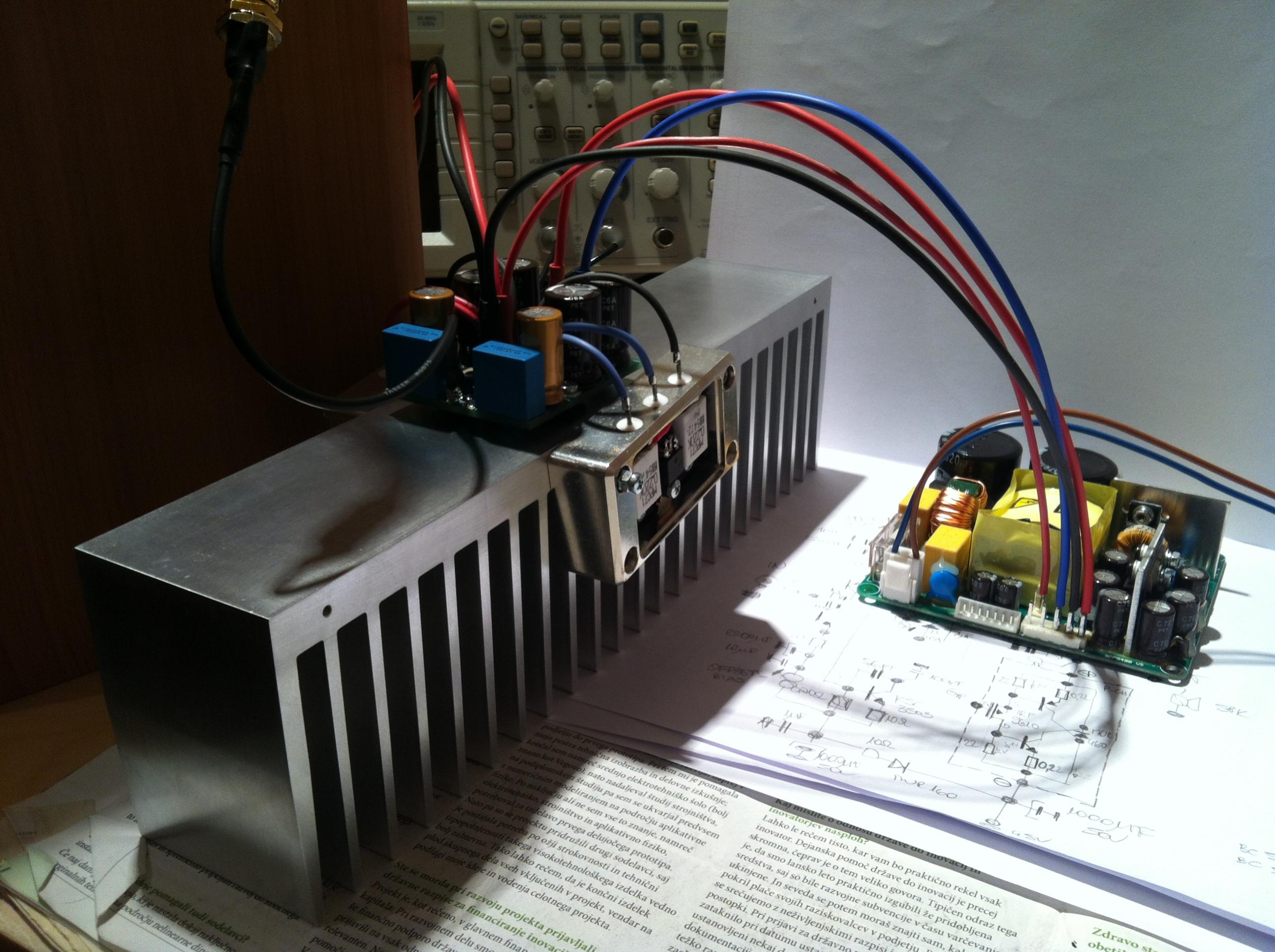

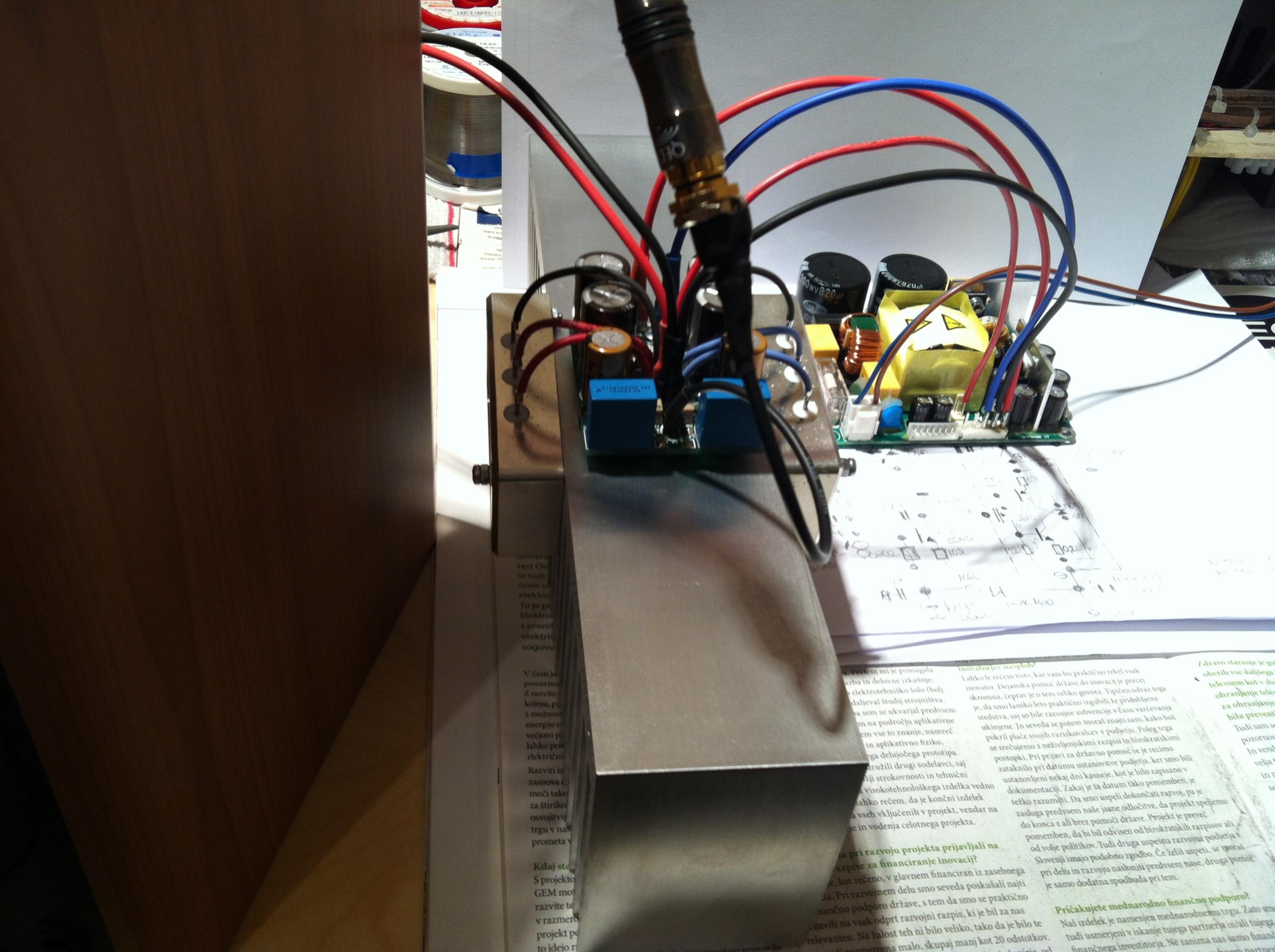

Logical experimental step would be VSSA BIGBT and that's exactly on the menu at the moment. :wiz:
Today's play, VSSA BIGBT with four bipolar outputs up and running. 76 Vpp max on the output when no load connected. Than 4 Ohm load connected and still 76 Vpp on the output, frequency 10 Hz, meaning 180 Wrms/4 Ohm. BIGBT-s connected to VSSA PCB without any compensation modification, no oscillations whatsoever, -3dB/3 MHz bandwidth preserved hehe. :cool:
