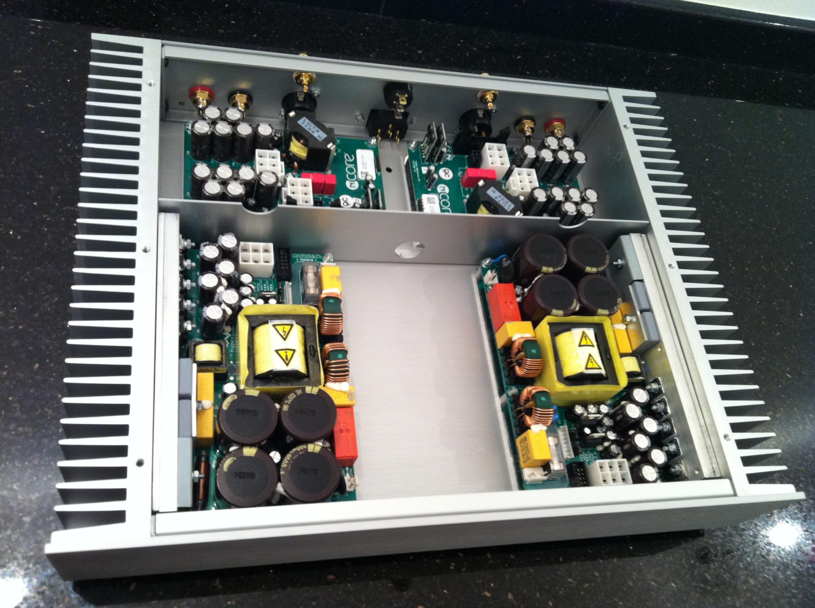

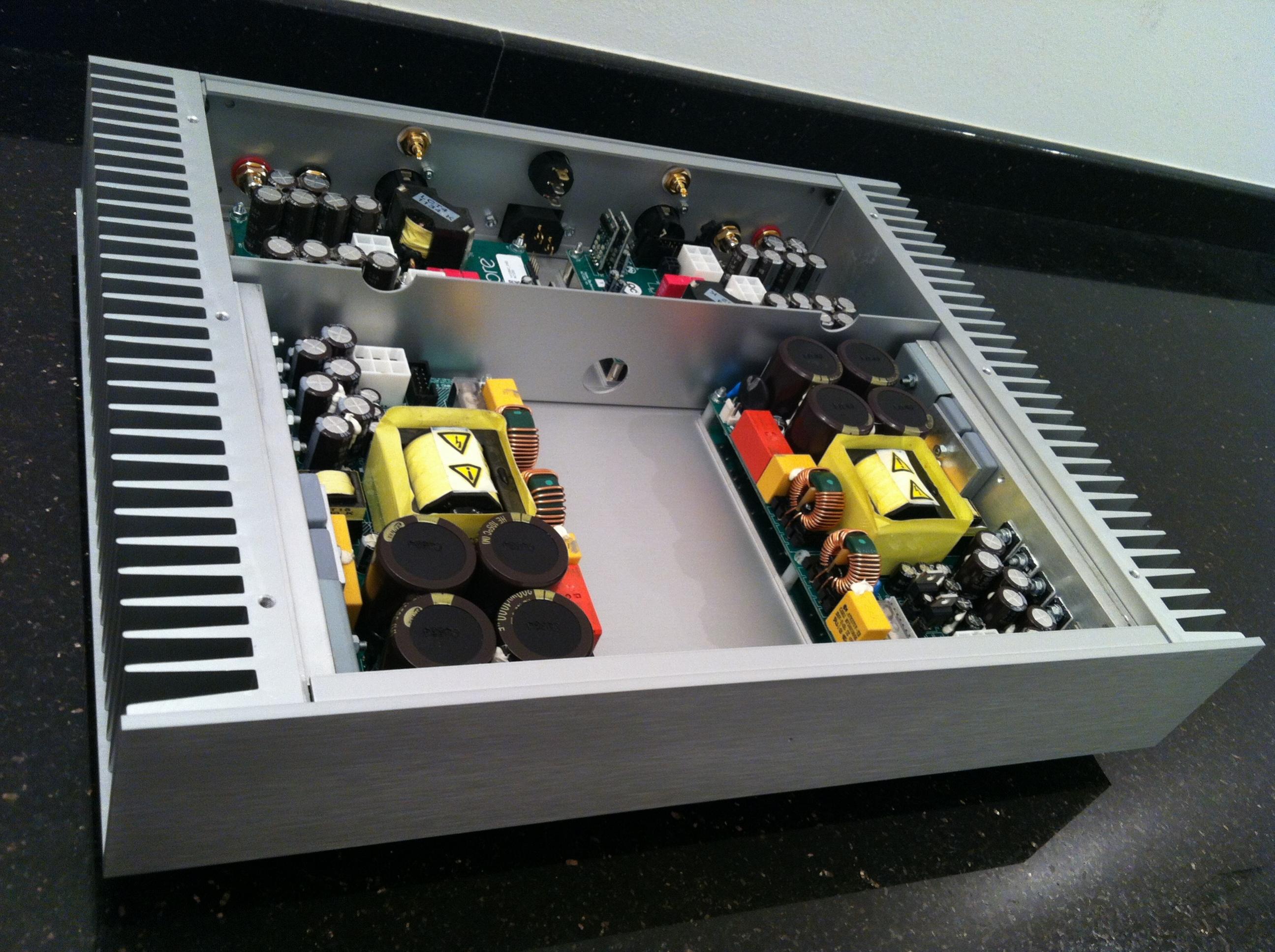

My JC-80 is ready to feed the VSSA. Also, my VSSA modules are ready to be mounted, feed and testing. Still need to decide what to use as the power supply... A toroid that is a bit on the small side (250VA) with 4 separate 28V windings, or a bigger one (500VA) with similar 4x 28V windings. It depends also on the internal size of the case.
@LC, can you please post some details?
Cheers!
Definitely use 500 VA toroid since it can feed more current (lower Z) and charge capacitor bank faster. I suggest to use 4 x 4700 uF/50V smoothing capacitors per channel.
If you are planning to buy toroids I would rather suggest you to go on SMPS either Hypex or Connex.

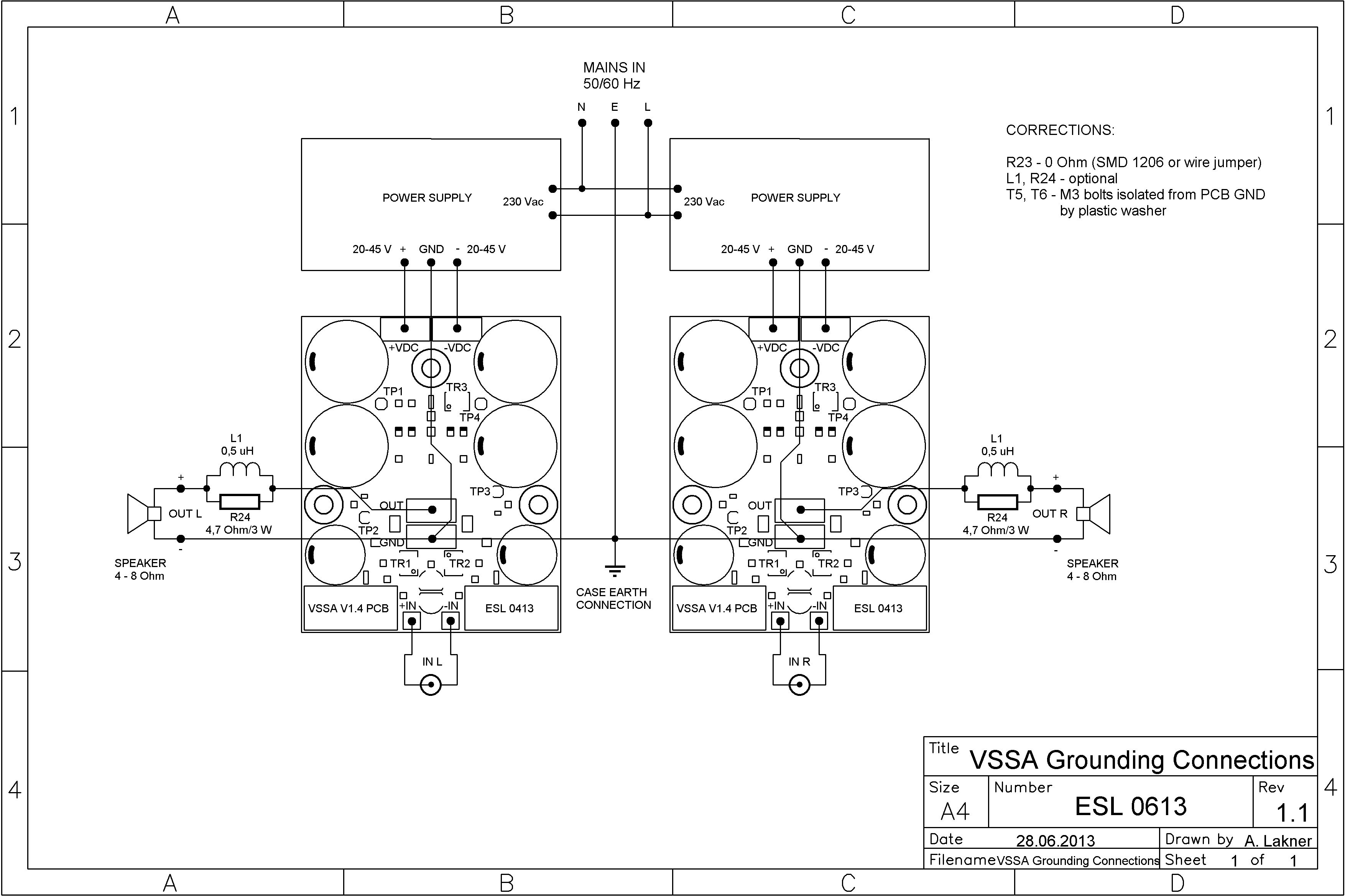

Please follow attached grounding sch. ;)
Thanks! I have both toroids already. Also I have an SMPS800 that offers only +/-30V and that is too low for 8Ohm speakers. (also only one so that would mean no dual mono build).
My choice also depends on the case you will sell in the group by, to know if they fit or not in the case. Or maybe get another bigger case, don't know yet...
I plan to use 4x15000uF on each channel.

Thanks Andrej, R21 and R22 are still in tolerable value but will change it soon.

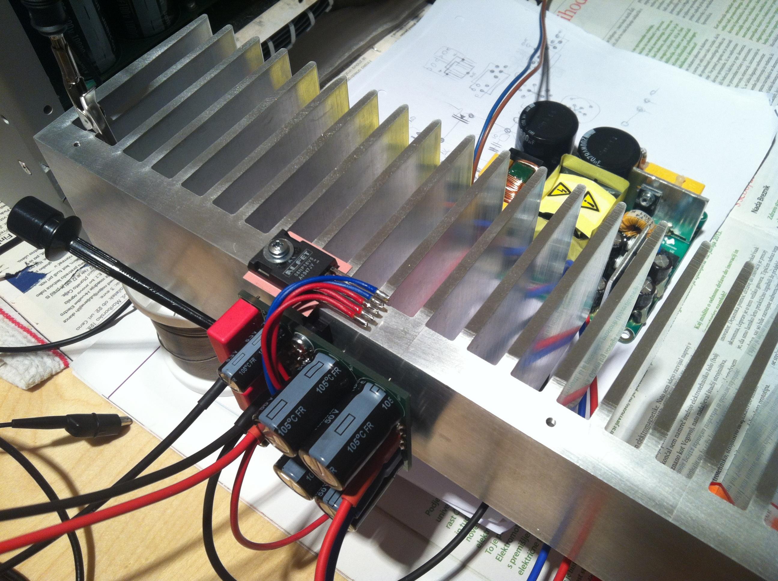

Today's play, VSSA with extra ALF mosfet added in parallel. 68 Vpp max. meaning 144 Wrms/4 Ohm. 68 Vpp remains the same with or without 4 Ohm load connected, so perfect load regulation (very high damping, low Zout), measured from 10 Hz up. :up:
What's most important, the sound remains the same as with one ALF :)
