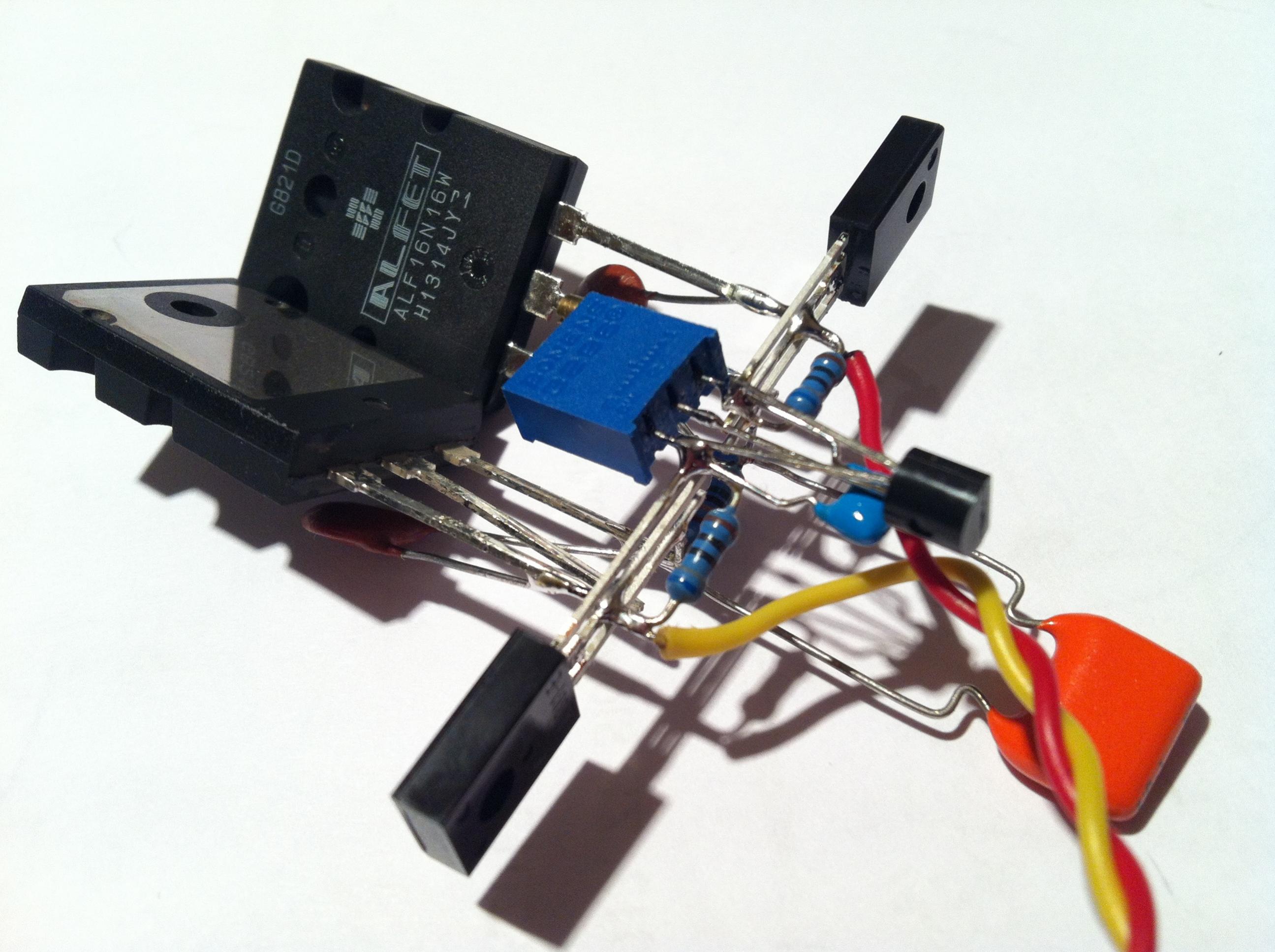

Output bias tested, at room temp starts at 220 mA, 5 W dissipation (without heatsinks) heats the outputs to 90 deg at stable 240 mA bias. Looks promissing without the need of any tempco regulation. :yes:

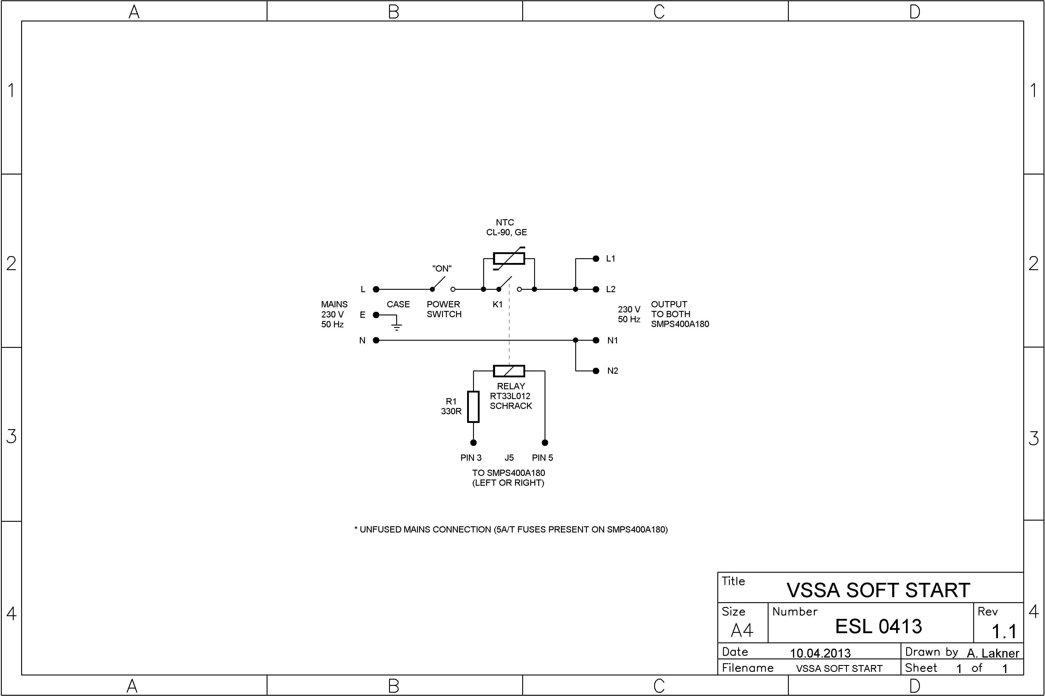

Is a soft start advisable with Hypex dual mono PS?
NTC on each SMPS400A180 PCB has to be shorted. Than connect them according Soft Start schematic.
Sequence starts by powering the switch, inrush current controled by CL90 NTC, after 2,5 s relay shorts the NTC enabling live phase direct connection to both SMPS-s. :up:
