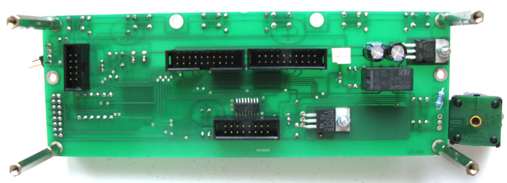

My brain is really starting to hurt on this uC board. I am still trying to get together a BOM for the whole project, because there appears to be some omissions and changes in Cheffs Menu of the Courses, and I have to get this right because nearly everything I need will come by mail to my little town, and anything I forget to order will cost unnecessary postage and packing charges for extra orders.
Could someone please photograph the top and bottom of the uC board with the connectors in place but WITHOUT the LCD in place so I can see what sort of connectors I need. All the photos I have found have the LCD screen attached, and there are no pictures of the bottom of the board ... where all the connectors are. For example, I have the Group Buy board with an ?extra? LCD connector along the top edge 1 row of 16 holes, and I am not sure which connectors go into all the other "connector" pads.

1. Yes
2. Momentary, Farnell ref 9471685 and 6 pieces for the board. For the "on-off" main switch you can take the same so 7 for the full UGS. :clown: Otherwise buy only 6 and another very nice momentary "NO" switch to switch on you jewel.
3. 12
4. yes, 4 pieces but NOT FAIRCHILD !!!! The On-Semi are SDG and the Fairchild are DSG so not pin compatible... But as Cheff said, if you cannot find these Jfet, put a 10k resistor !;) I just have to find where to put these resistor...:cool:
