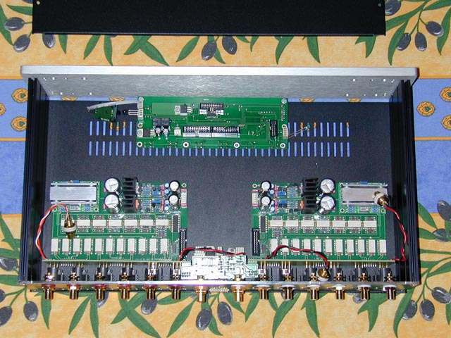

After sorting out the problem with dlportio.sys everything went very smooth :D:D
This is indeed a very enjoing project!!

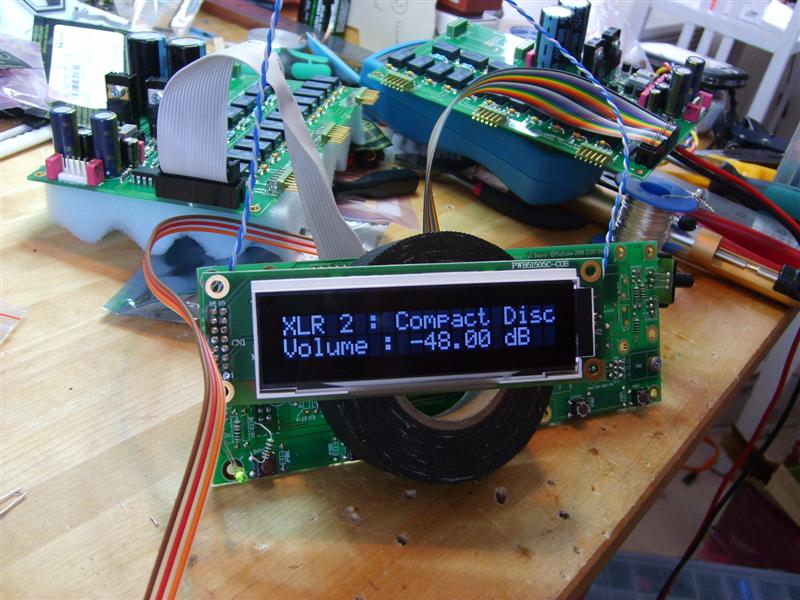

Maousse said:
One funny thing is the attenuation is displayed in dB by default.
You have a binary display.
I think you may have missed the EEPROM loading before flashing firmware.
:D
YES, Maousse thank you ,that was it...reflashed...all is well.
will post pictures later.
Glad i didn't waste too much time checking around the Rotary encoder...i was looking for something that wasn´t there.
But i am extreemly gratefull for Cheff's allways prompt reply.
Got more soldering to do this weekend...after the beach:cool:

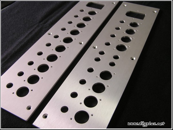

Thanks for the info, CeeVee. Is it possible to get the GB rear panel as of now? The GB has been long closed? How about the front panel? Any GB yet?
Vincent, please go here to check which model you want then email me, OK?
http://www.crystalfontz.com/products/index-std.html
If I cant get the GB rear panel, probably I will go with this chassis instead. It's a bit larger than the Hifi2000 case. The rear has openings for 5 pairs of RCA/XLR plugs. Will have to do the wiring myself.
-finney
Joined 2006
-finney
Yep Finney,
GB has been closed and delivered for some time.
It seems you will get CAD file from Vincent.
Although the ones you have are very close to the GB ones.
It does mean you make new boards for the sockets...but these are simple and single face.....

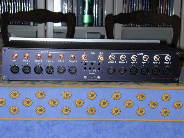

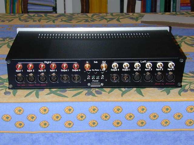

UGS All Inclusive Rear Panel
Hello
I have compiled some files of UGS All inclusive rear panel CAD file from the french GB (proprietary format to read with "front panel designer" software, http://www.frontpanelexpress.com/ )
All the files and photos come from Maousse.
The designed rear panel fit the Hifi 2000 case (see the previous posts )
I don't know about a front panel CAD file.

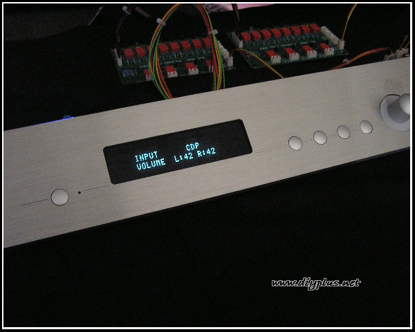

Re: display menu
joho said:
I'm very impressed of the display menu but is there somewhere an overview?
No, sorry. No time to write something. I will, but when ?
How to save a changed input name? I tried input nr.1 but when i go back to the startup, the name isn't changed
:confused:
Once the name is modified, press the menu button for more than one or two seconds, until the "saving" message is displayed
Software version v1.10
