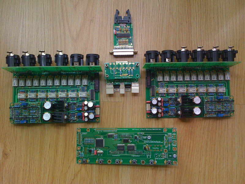

My first reaction when I see all of the pcbs is " Oh no, this will be a nightmare project." It turn out to be a fun project. Soldering smd part is much more fun than I expected. With search from google, a little bit of maditation and just do it, it turn out to a good success. The hardest part (for me) is to acquire all of the parts.
This is what I got so far, power supply, main boards, UGS modules, program module. I am still working on microcontroller board; missing a few parts. I hope the lcd module that I bought can work. The datasheet say it pin compatible and the command seem to be the same.
And I just notice that my notebook don't have parallel port. :headbash: :headbash:
Do any one has the dimension of the real panal. It will be difficult to just measure it and drill.

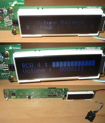

help testing first display
tested my first UGS display yesterday ( doing the Slim version with optrex display first before building the tall one ) ....got that sinking feeling that maybe all is not well with the PIC.
Here are some pictures of what i get:
The Standby/on switches and led brightness change is ok.
Select inputs is ok
IR ...have no idea, what remote should be used ?
Volume rotary encoder....nada!...no reaction.
Initial startup is quite long...but no Thanks Nelson Message...in fact no message, goes straight to last selected input.
How do i navigate user preferences menu to adjust...it does save new settings but these are always the same old ones because i cannot adjust anything:(
By the way...this is the latest firmware: ver 1.10
Hi CV,
I've exactly the same hardware. Perfectly working...
Got the right software (ATmega64/V1.10/Optrex) ?
Checked and set the µC fuse bits as described here (page 3) ?
Remote is RC5 only. System address and codes have to be learnt first.
"Menu" button enters the configuration mode, "Bypass" button to escape this mode (one level up)
Navigation through menus is only possible with the encoder active.
So get it working (volume control) before "menuing".
