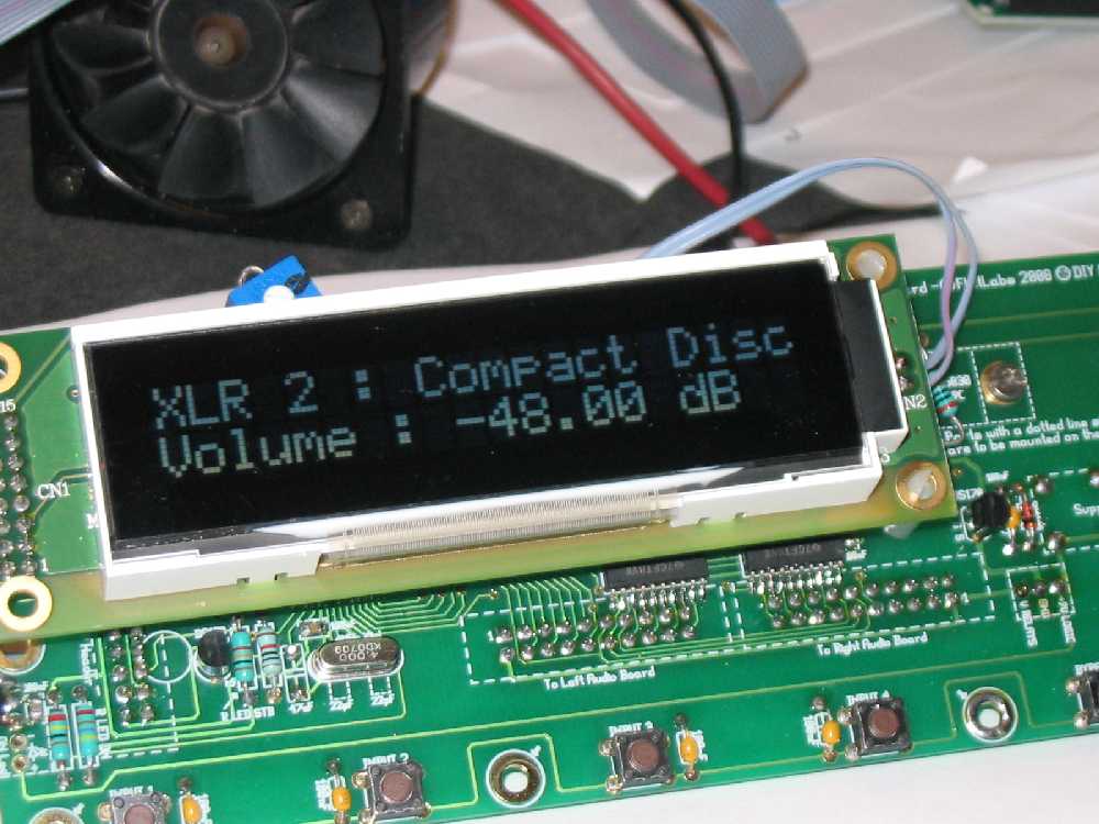

Manu said:Hi,
Here a little pic.
To give a concrete idea of size , I have put next to the display a box of famous Cachou Lajaunie
You certainly want to see it "in action" but unfortunately my uC board is actually configured for Christalfuntz LCD (Backlight current and connections).
As soon as I find the time to make the changes I ll post a new pic.
Manu
Manu's optrex display
The contrast adjustment is a little critical.
I need -700mV for the best result.

Don't you use the onboard contrast adjustment (I see a little trimmer on the photograph) ?joho said:The contrast adjustment is a little critical.
Hi cheff,
It's a long time ago on this forum isn't it?
Yes, for the moment i use 2 trimmers for the display. I forgot to order the integrated circuit. In fact when i put the contrast regulation almost to ground it looks good but you can see the square blocks behind the characters. So i add a negative supply to make the contrast regulation a little negative. But as i've sad, there is a very small "soft spot".
B.t.w. i download you're latest software version for the optrex variant. When i turn the controller off there is some message in a strange language. What does it mean?
Gr.
Johan
