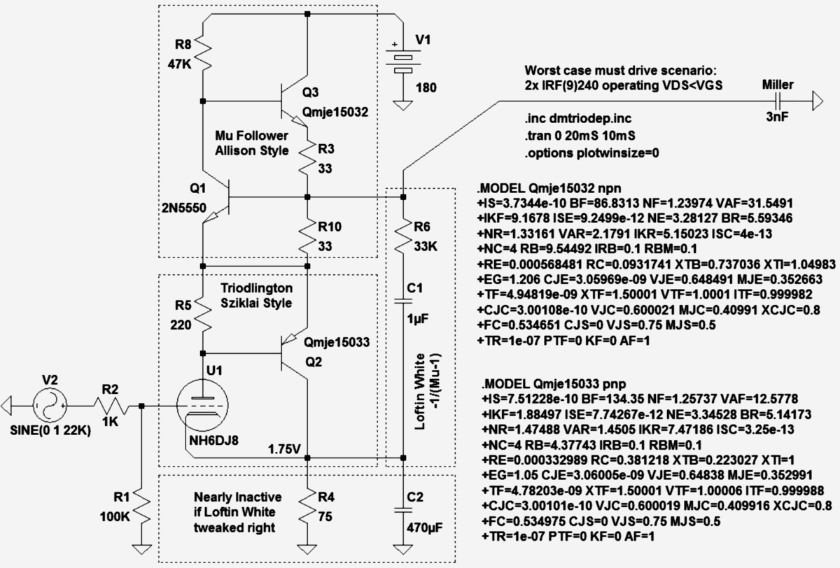

You don't have to use all these tricks at once...
I hope I didn't confuse things by demonstrating
too many unusual things in one drawing...
You probably ought to run the sim to see how
the big nasty electrolytic bypass cap under the
cathode is passing almost no AC. All the bypass
action is on the high quality Loftin White 1uf!
-3db corner frequency for both bypass 4.7Hz
We should now be getting the full value of Mu.
We are down now to a single twin triode for
the full stereo. And no longer have to elevate
heaters to keep top side cathodes safe.
2N5550 might not have wide enough SOA for
this abuse, and MJE15032 is overkill. Maybe
something inbetweenish specwize for Q1?
I forgot, due to Allison fake depletion mode,
Q1 would normally see only 2V VCE, SOA is
fine. Nothing to worry.

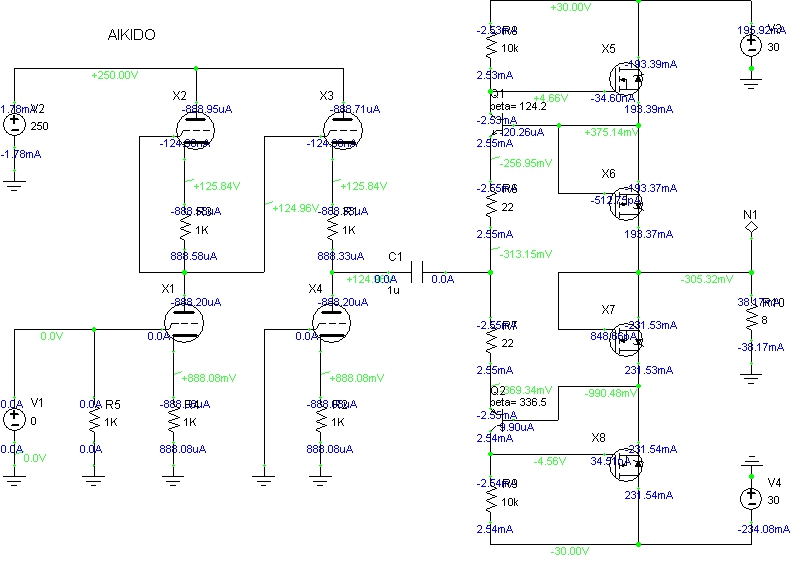

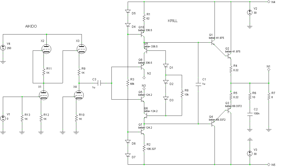

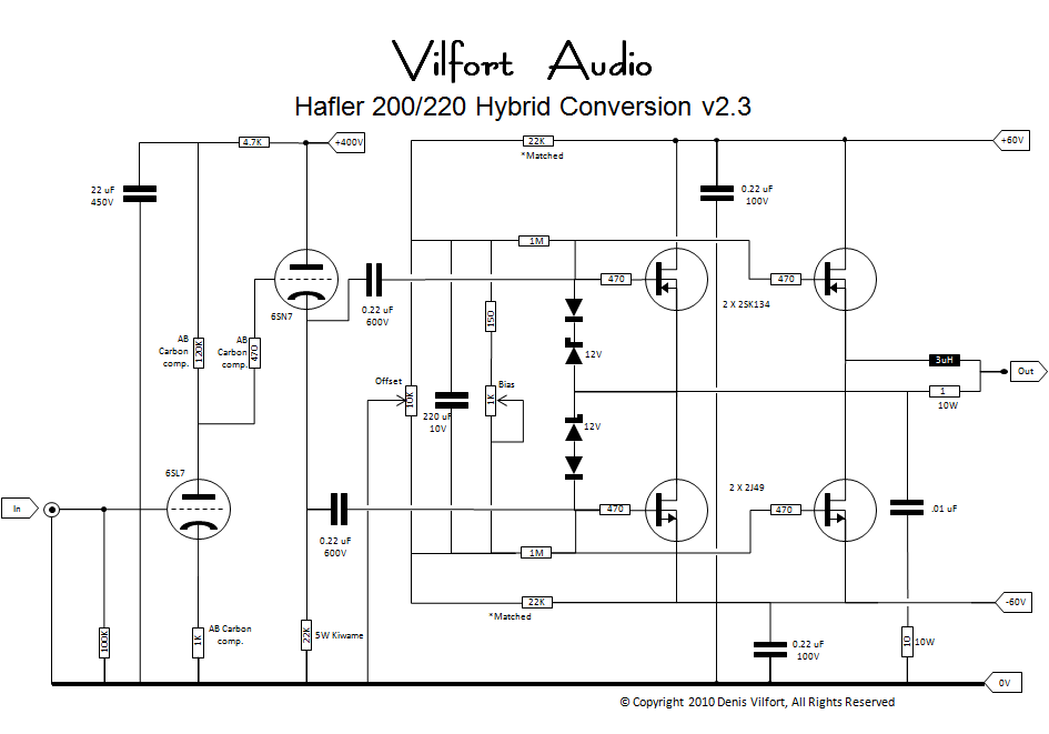

Hi
this is my experiment
when Aikido meets Krill,
only detailed sketch,
worth further imrovment?

Pawel,
Input drawing lacks PSRR cancellation, its not quite Aikido yet.
I'm doubtful it can swing the necessary current to deal with the
challenge of driving the mosfets fully to the rail. Miller increases
to 1500pF when VGS>VDS according to Cordell. You gonna need
to swing about +/-20mA.
Output drawing 2 is almost pefect, except 4 diodes (rather than 2)
should be square law Schottky. And have about 10ohms strapped
across the diode stack to insure the output devices always try to
conduct a minimum 120mA or so. Never suck the threshold charge
off the gate.
This will give you quasi-complimentary Schottky square law crossing,
rather than law of hot mismatched never quite complement IRF(9)240.
Really thinks like class VischB+CCS rather than AB. But power devices
forced to conduct and cross like perfect AB which is all that matters.
Maybe especially important not to have a crossing distortion where
there is no fallback upon GNF loop to fix the defect.
I'm not in favor the opamp driving those emitters, except as a servo.
I still think the emitters should be capacitively coupled to the tubes
without going through the op-amp.

Mosfet/Tube Hybrid Power Amplifier
Hey Apexaudio, you are welcome to try my design (as long as you do not use it for commercial gain). It is really built on a Hafler 200 (or 220) but can easily be modified to run with modern MOSFETs like say Toshiba or Hitachi. Amp-guy asked for off-set, so I added a 10K pot across the BIAS network. This should be adjusted for say +/- 10mV on the output terminal w/ ref to ground (zero volts).
So how does this setup sound? Very tube like. No booming bass, but great vocals and sound stage. It really is a tube amp w/ the output tubes and transformer replaced by a balanced MOSET source follower. To my ears this is a great hybrid approach since it essentially behaves like a 2 X 110 Watt tube amp. I hear detail I never heard before...! - One word of caution: you MUST use good quality parts since this design has zero global loop feedback. Play around w/ different caps and resistors. I found that good old NOS Allen Bradley resistors work well. Kiwame is also OK. You can use Mills WW if you like. This is a great platform to play around w/ parts to get 'real tube sound' from a pair of MOSFETs. - Or the sound that fits your taste.
D.
D.

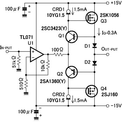

You gonna need to swing about +/-20mA
for IRFs yes - for Krill no!
like before: this is a sketch and a picture with the opamp was only an example how works the buffer with error correction. On the left is a schematic with planned capacitice connection, which I proposed to discuss.

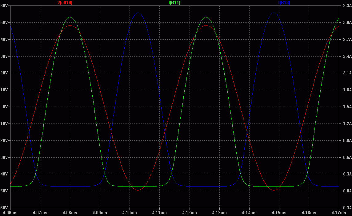

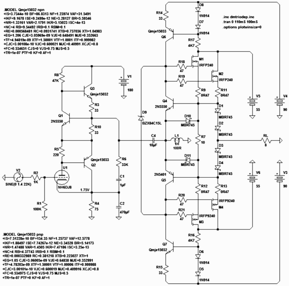

I tried and tried to simulate your OP-Amp based servo.
Both as originally drawn, and with every tweak I could
imagine to try and "fix" it... Maybe some other changes
I've made elsewhere were incompatible w this servo?
Tried several LT op-amp models as substitute for TL071
In desperation, I threw a choke at it, and this simpler
DC solution actually seems to simulate out pretty good.
Its probably OK small core saturates in event of need
to correct severe DC offset, something else is wrong!
Probably doesn't demand big gapped parafeed choke.
More o' my circuit bending wierdness to laugh at...
I wanted to sim w. same transistor choice as Apex,
except I havn't collected all the needed models yet.
You are not seeing vertical MOSFET crossing here. You
are seeing cold Schottky Diode. Mismatch of MOSFETs
and output device temperatures have little effect upon
this crossing's shape. VischB + CCS
Smoove crossing!!! But still maybe something wrong
with circuit behavior near rail clipping (above 50V)?
Or maybe thats just LTSpice math acting strange for
no reason? Does that just to make me look stOOpid..
D10+D11 probably not necessary, I just don't trust
choke misbehavior never to reverse VBE.

Hi Kenpeter,
what for is L1?
Please describe how to make it in practice,
