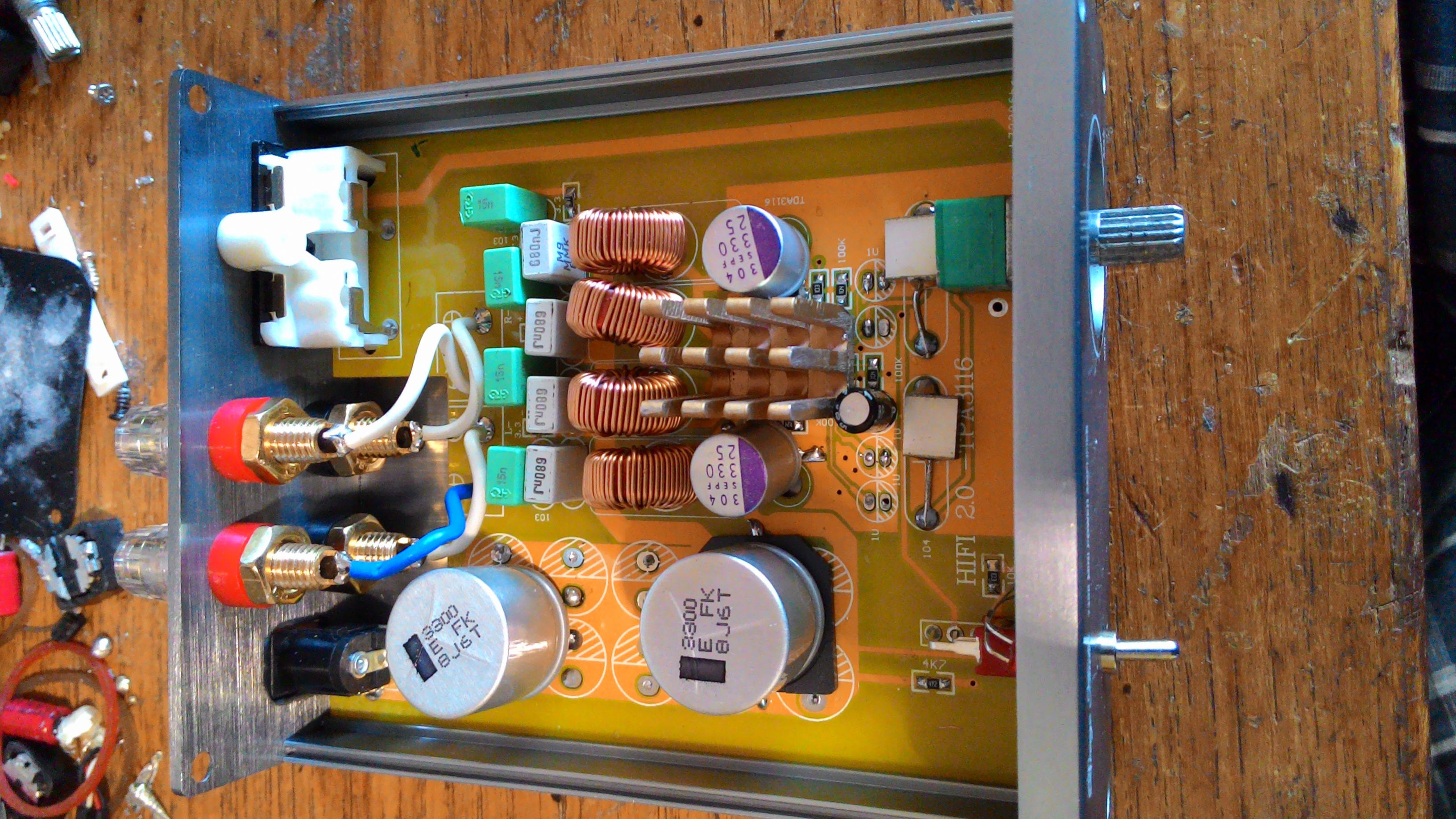

I received my el cheapo hifi 2.0 last week and now its almost ready! It sounds really good! I performed listenening test between each mod to get a deeper understanding of the changes. I started with the large Panasonic FK (low esr and cheap in 3300uF). They helped at lot on noise level and some on dynamics. But I guess they were too far from the chip to really make a difference. Later I added the usual oscon soldered onto the chip legs.. Huge improvement! Just as described in earlier postings!

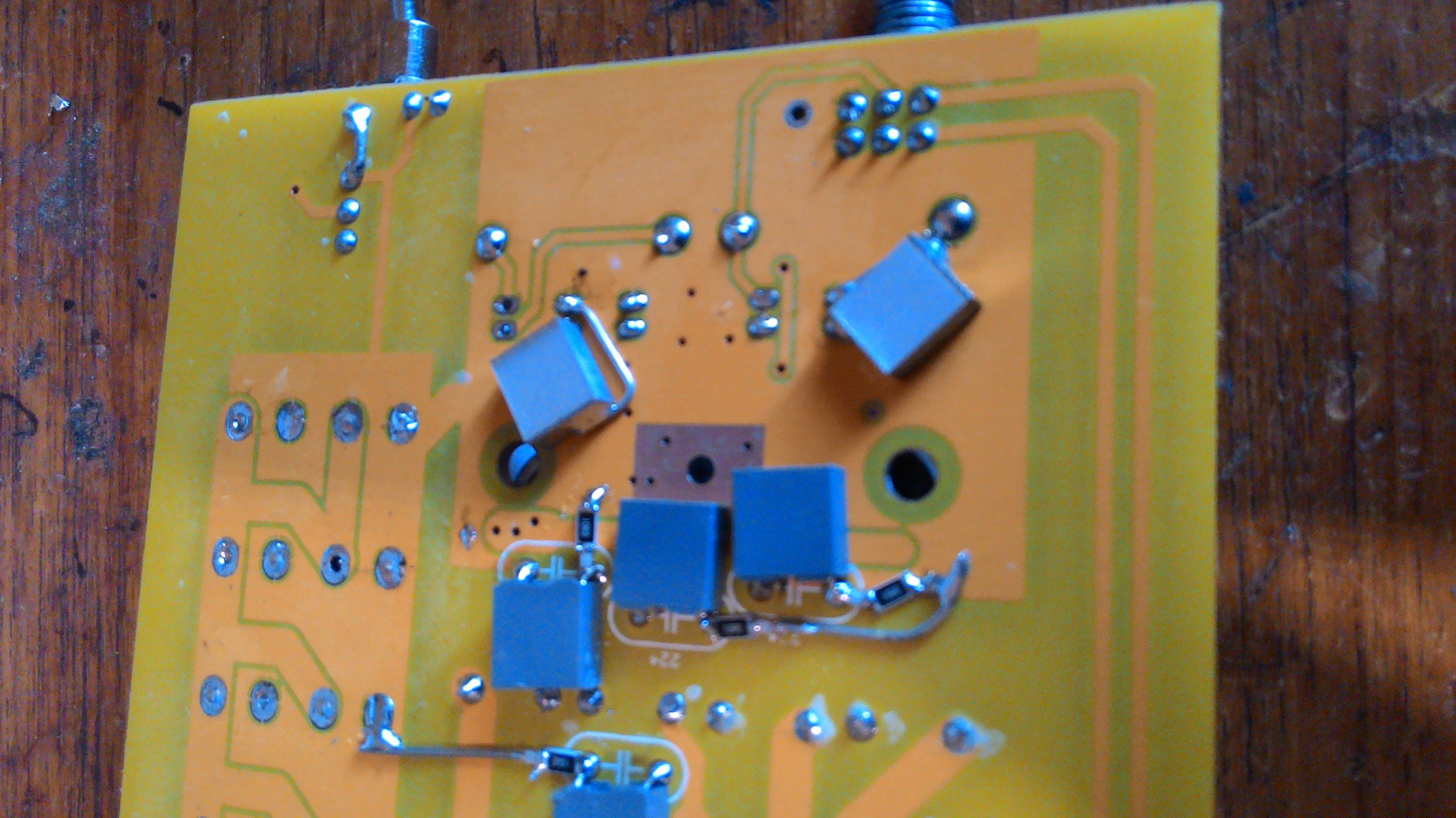

When I added the snubber the harsness on vocals went away! The amp can't sound good with out the snubber mod.
The bootstaps were films from the factory and the amp didn't sound compressed when played loud, so I let them be.
At this point the sound didn't quite have that magic sparkle.. so I changed the input caps to my usuall trusted PPS 1uf smd caps. I am going to solder more in paralell to get atleast up to 2-3uF. That lowered the standby noise to a minimum as well giving the amp the last bit of sparkle and realism! I guess the noise has something to do with them being soldered flat on the pcb close to the ground layer.
This particular board has toroids as inductors and is the only board that plays strings perfect. So I will add toroids of better and larger inductors to my other boards as well:)
The build quality on this hifi amp is really amazing! Even better it costs only 38 usd! Machined alu front plate and knob. Mute knob and screw terminals on the back(too small). 8 screws holds it together and it's really quick to dismantle. The board has good space between the components with trough holes. Perfect for diy! As long as the RC snubber is used the extra distance doesn't matter all that much. I'll add some detailed pics for anyone one who wants to go this route:)
Other positive things I've noticed with this board:
+wide traces on the power side and output.
+nice bootstraps
+space under the pcb to add smd components
+usable inductors
+space which allows normal size input caps
+space for psu filter caps(with large trough holes)
+large rubber feet
+really good brushed case finish

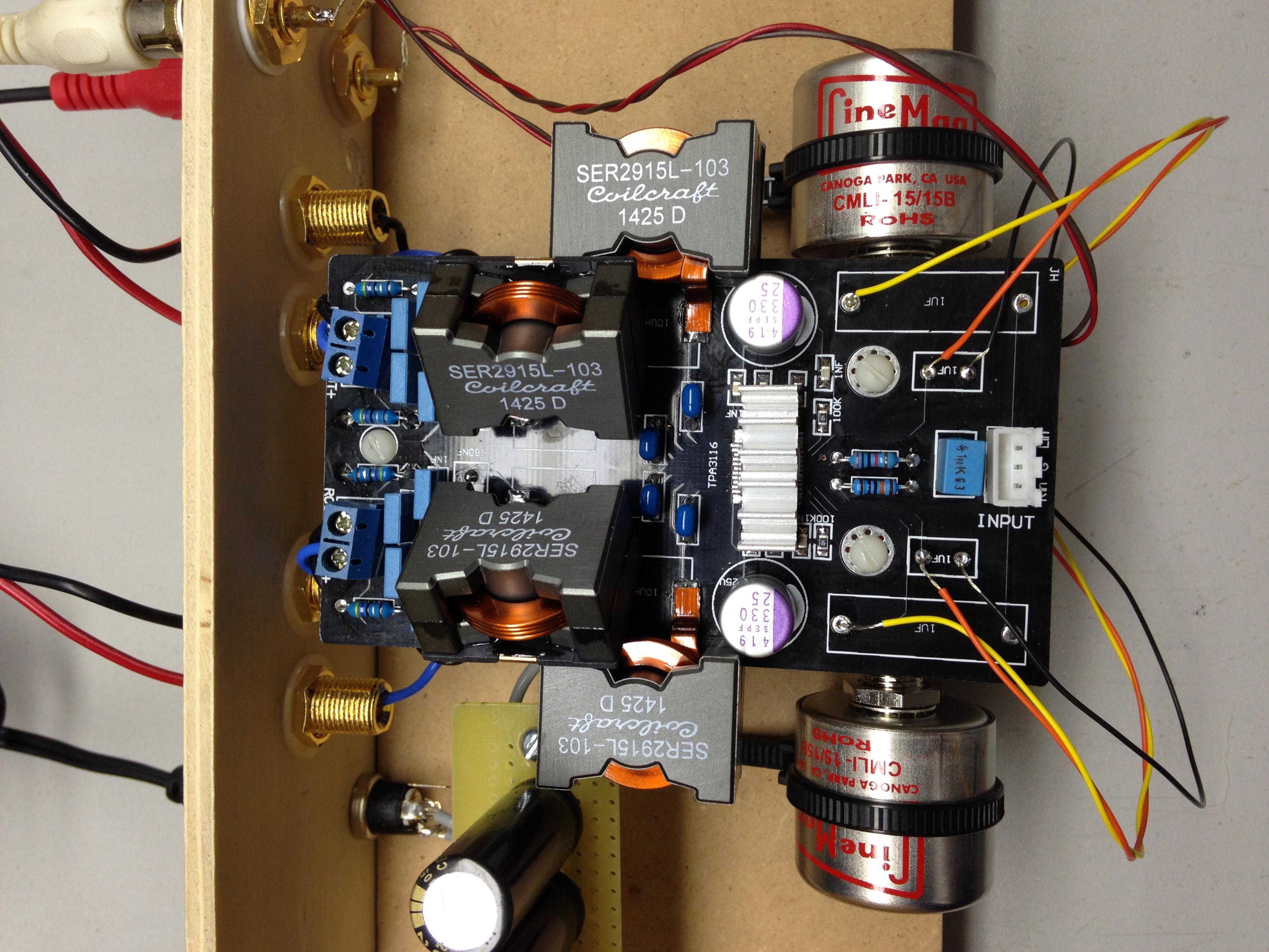

..... Now back to the Class D fun, I finally wired up the CineMag CMLI-15/15B input transformers to my modded YJ blue amp. Keep in mind this is a temporary test bed build, and I will tidy up the wiring, but those little silver cylinders were talking to me to install them since they arrived two days ago.
Originally, I was going to do the bootstrap snubber mod, but I decided to do this first. I will get around to doing the snubber mod, so don't flame me. I spent $120 on these things, so I was going for the big buck mod first.
All I can say is this amp sounds pretty awesome playing Patricia Barber's "Cafe Blue." Just as dboy and sharp31 have previously reported, the input balancing transformers really open up the amp. The sound is definitely clearer with some incredible inner detail. The soundstage is substantially larger and the bass is punchier and more articulate. This is noticeable on kick drum strikes. If you want air, the transformers will give it to you.

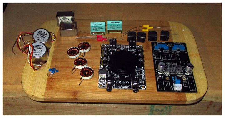

Input transformer?
Could I get somebody to look at this and tell me if suitable as input trafo for the 3116 please? If suitable how to wire up.
Bought as an output trafo for a DAC from fellow DIYAUDIOer, this was said about them:
"They are 1:1 ratio but deigned to be driven from a source of about 100-200 ohms into a load of about 10K or more. Typical of a voltage out DAC into a preamp or power amp.
DCR is about 50R. But that is NOT the impedance seen by the load - except at DC. At anything about 15Hz, the source will see the approx. the impedance on the secondary."
It isn't text book perfect for the application, but should work very well. Go for it!
