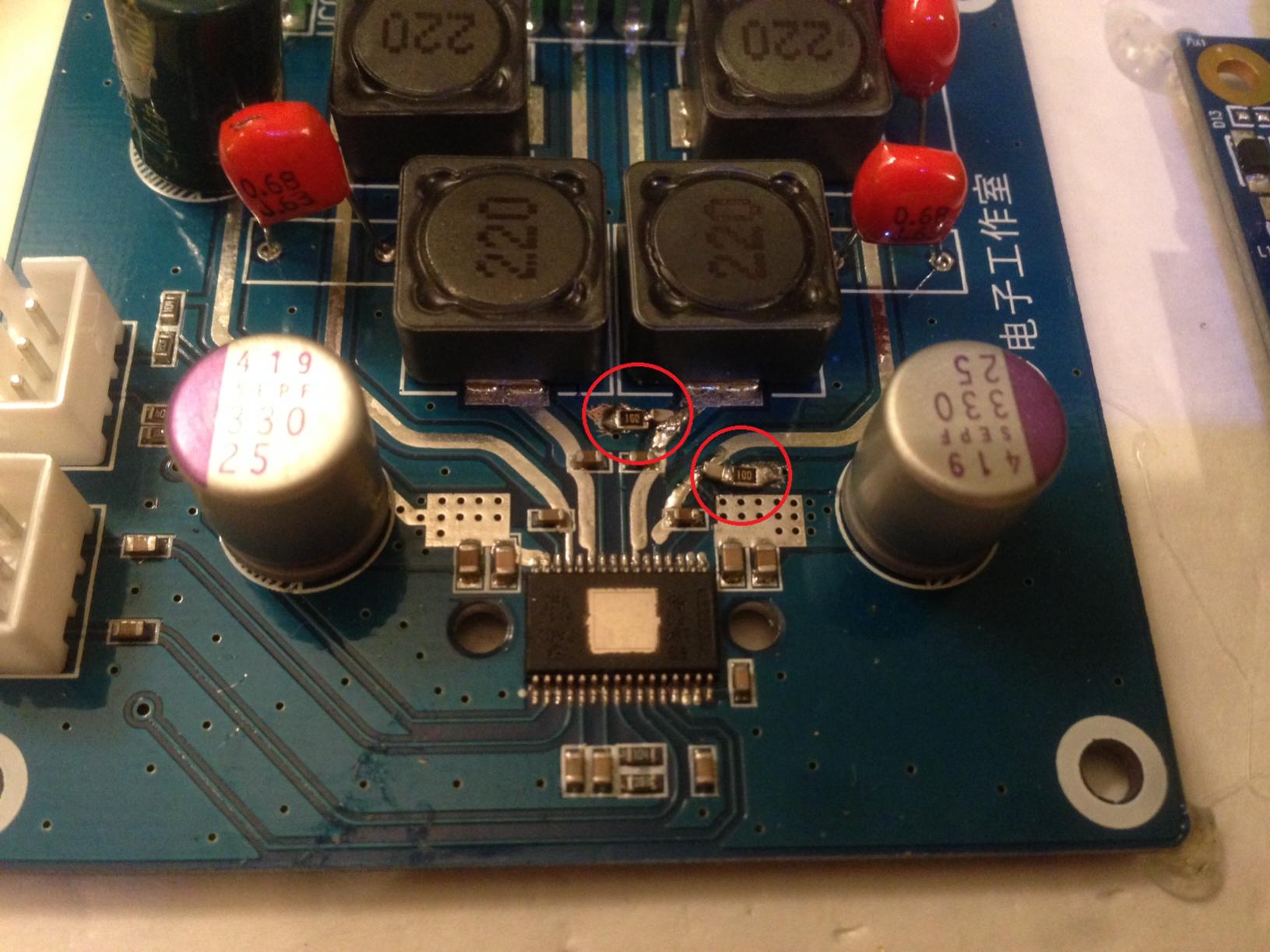

I found out that I still had the Murata 330pF 50v C0G SMT caps and 10R 0.4watt metal film SMT resistors from my original dead bug amp BOM. However, I only had enough for one amp (or two speaker outs). Being impatient, I decided to mod half of each of my vertically integrated active biamps. I went with the mod on the full range channel and left the bass/sub channel as is. It was a little tricky to do, but there is enough room underneath the heatsink area to scrape off some varnish for ground pads. Here is a photo of one of the amps. Not the neatest soldering job considering I have too big of a tip on my soldering iron.
It sounds very clean now, it helped to remove some sibilance, vocals, cymbals/high-hats, snare drums, piano, all sound better.

Word of caution with SMT snubber
Here is a sound clip of the amp now with the bootstrap snubber and the OSCON's.
I just wanted to give a heads up that of you are doing this mod with SMT parts by scraping away varnish to expose the ground plane. Make sure you do not scrape away too much that both ends of your resistor sees ground and you inadvertently connect your 330pF cap to ground. I did this accidentally and noticed a degradation in sound quality. It is not obvious unless you use an ohmmeter to check your resistor as 10ohms after install. It will still play music but will be obvious that it sounds like it is veiled and will clip at moderate volumes on percussive strikes.

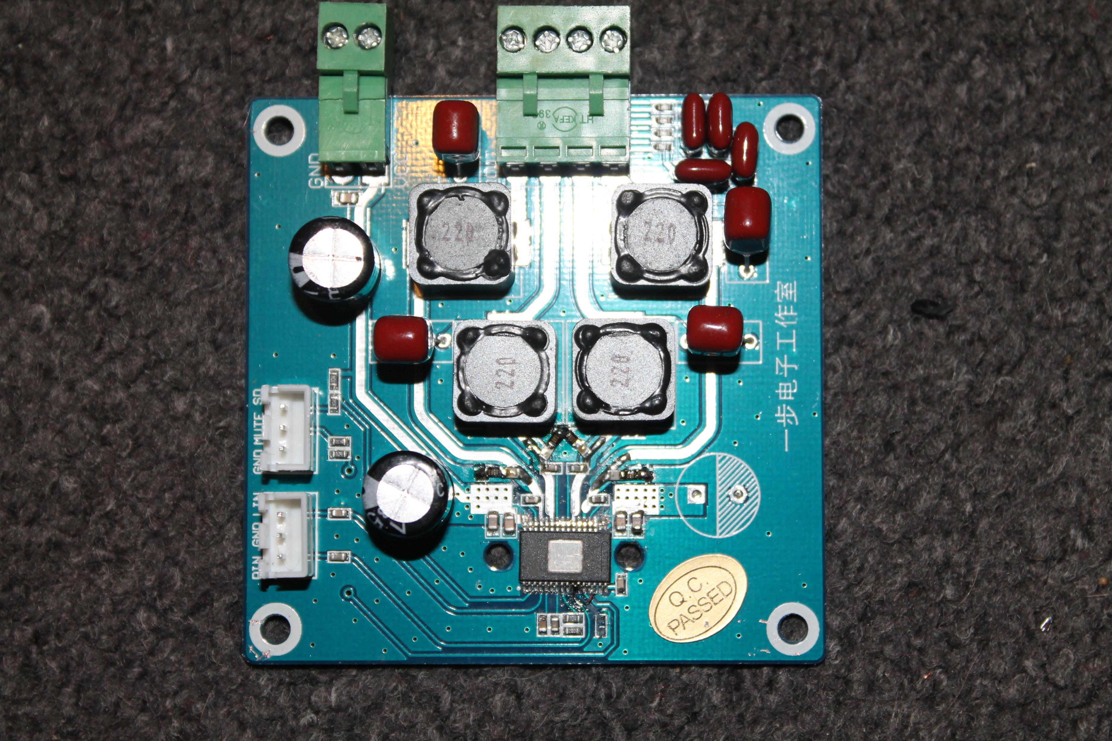

Some shots of differences between the smsl SA-36A PRO (TPA3118) version 2.2 board.
These film caps changed between v2.1 and v2.2, and the silkscreen + actual wiring to the output jacks is different. Could also be other differences, but those are the obvious changes. The smaller green caps might leave enough room for a nice small pot.
