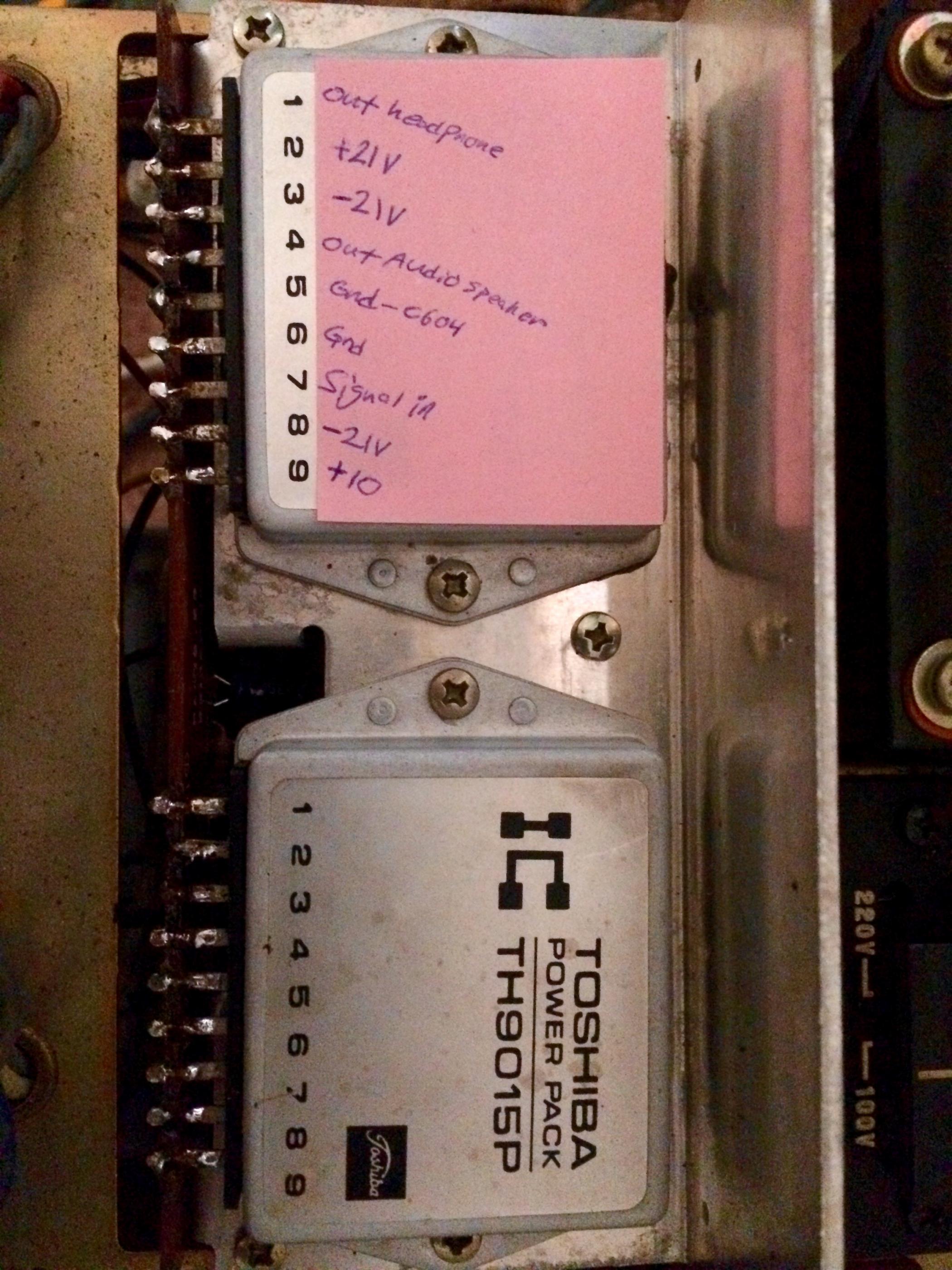

i still am interested in finding any info on the power ic, but it seems there is still no information on these things or even what they could be supplemented with
part# TH9015P
This IC was also used (4 of them) on the quadraphonic Toshiba SB-404 amp. Unlike the early STK IC's, it is a complete amp (differential input, VAS, complementary drivers, quasi-output stage), so it can be replaced by a mono chip amp. I used to have a rather fuzzy datasheet for the TH9013-9015 chips, I see if I can find it...

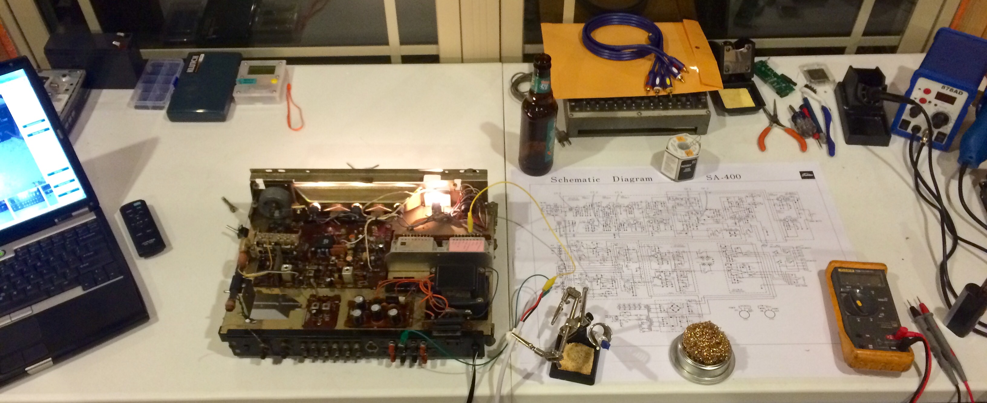

so after running a 1khz sine wave through the amp and finally connecting my pc scope to the output, it appears that the right channel has nothing coming out of it, the only sound it produces is in mono and the audio i was hearing out of the channel appears to be bleeding through from the left channel at high volumes.
-feebz the audio path tracer i made was made from this post > Troubleshooting your amp with audio signal tracing |
and the scope is just a usb behringer soundcard with rca in/out
im about to take another stab at this today and hopefully come up with something promising.

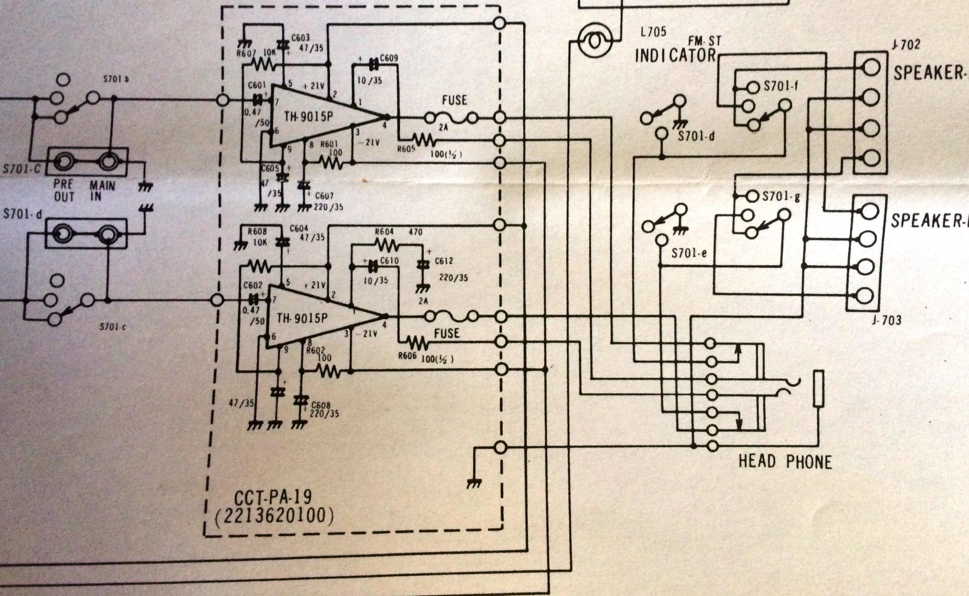

in the meantime, this is what i found with my multi-meter and kinda guessed based on the schematic what pin does what (see attached)
