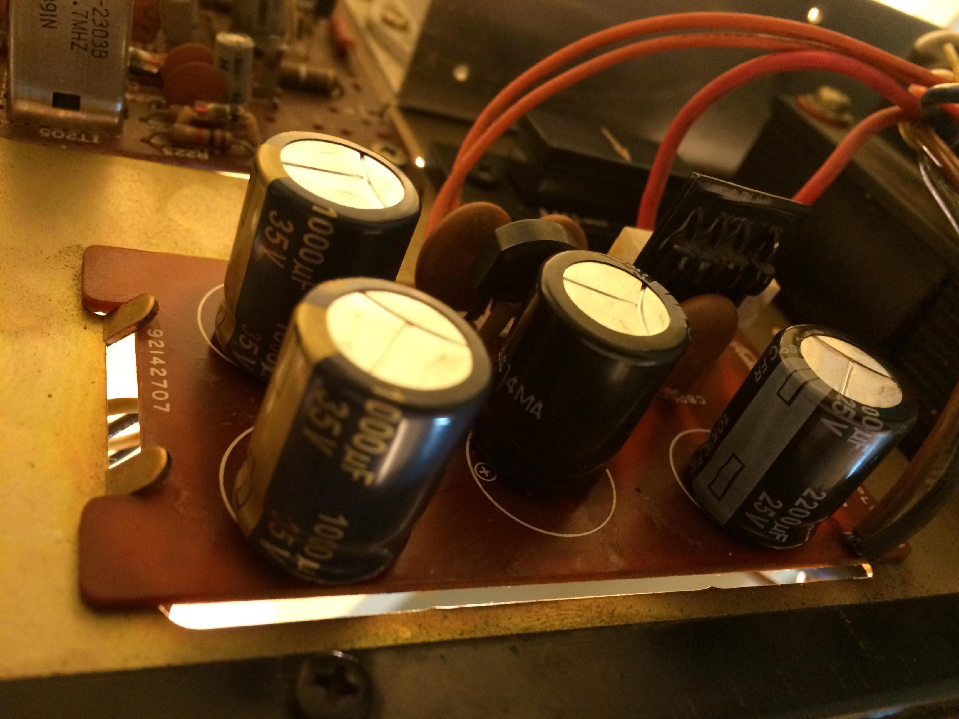

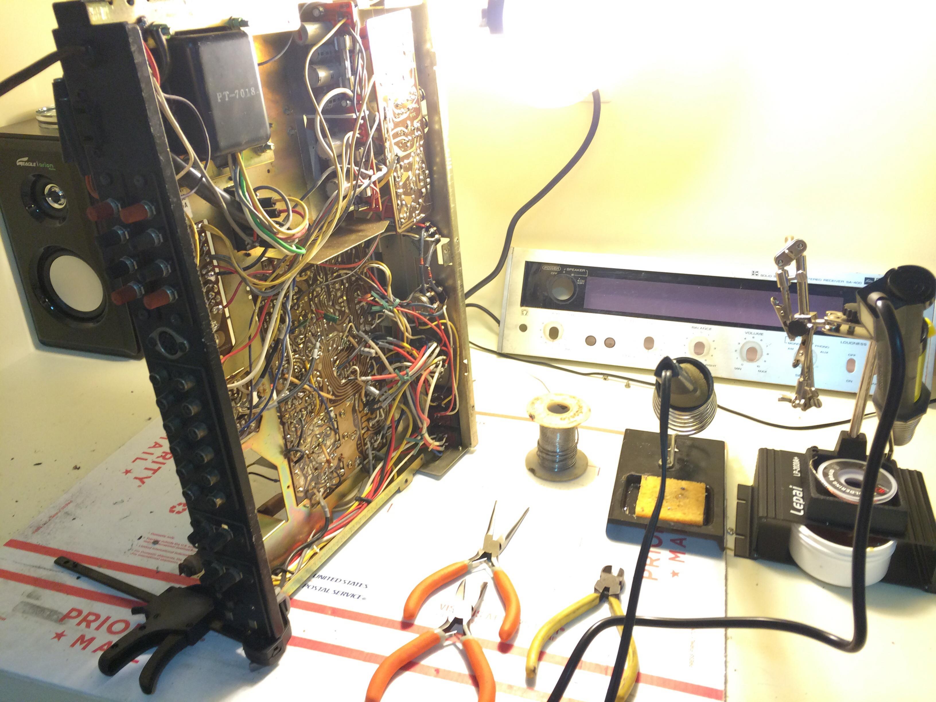

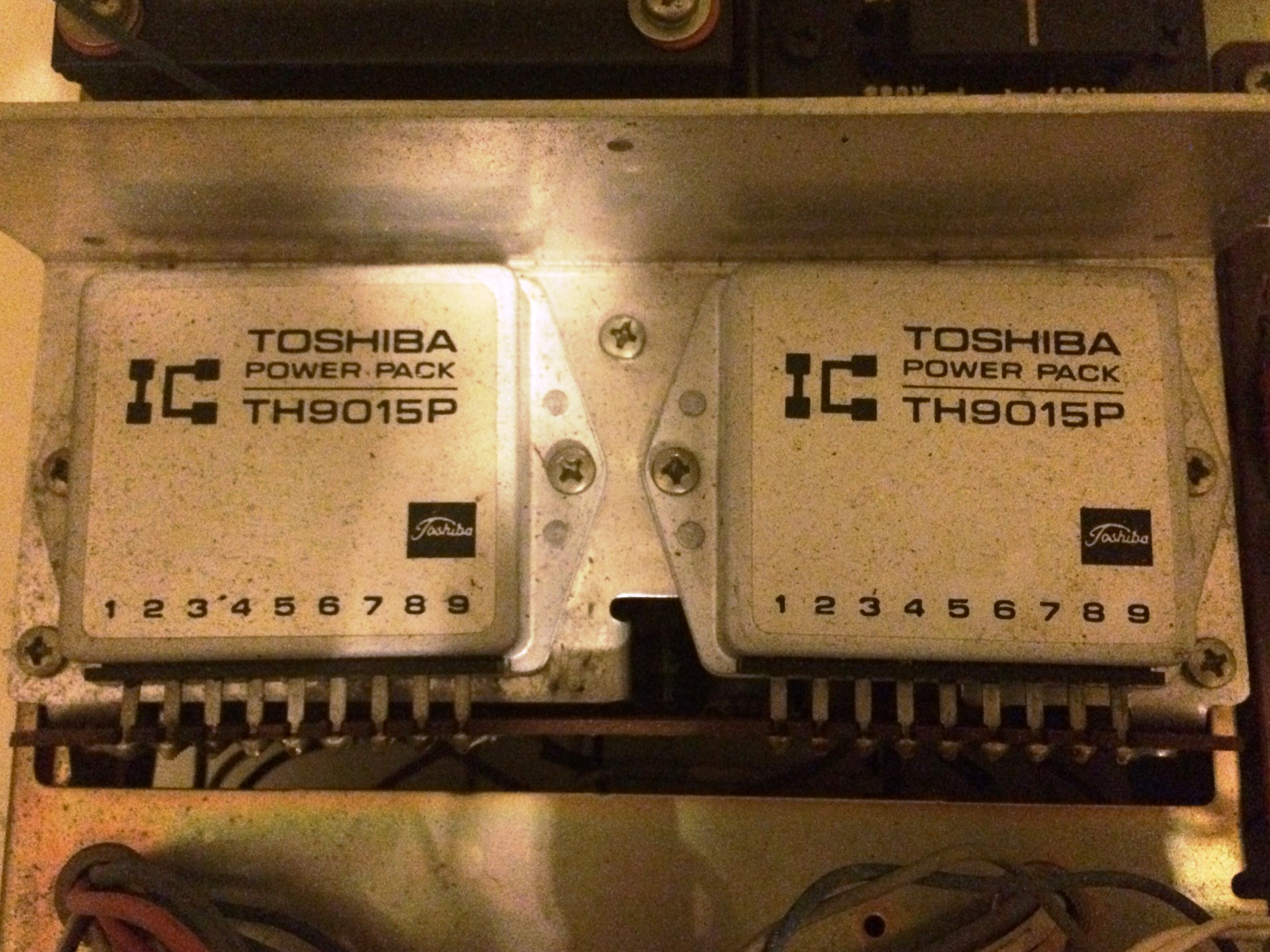

Ok now I'm finally satisfied with the unit being functional. Next up, cosmetics
The root of the single dead channel issues came from the tape monitor switch. The issue will be finding a replacement. It's a DPDT from SMK. If I can't find a replacement, I might just have to bypass the tape monitor.

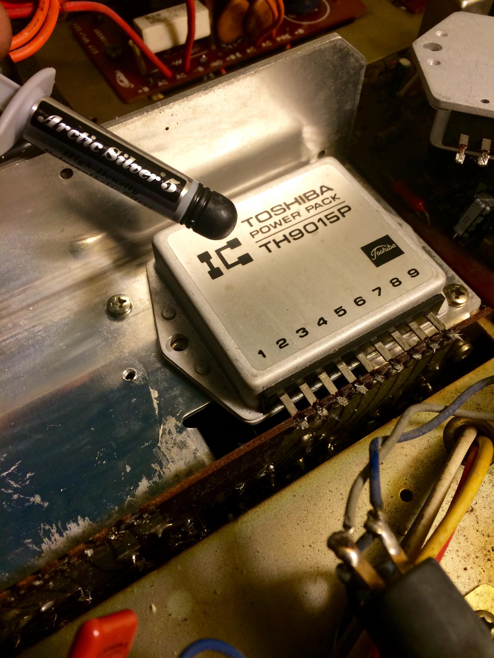

Btw I have not measured the power output yet, the radio has a ton of wattage due to the chip amp swap! And I hooked the headphone jack up as it was on the original IC style chip amps. The radio was rated for something like 18wpc. I'm well over that now!

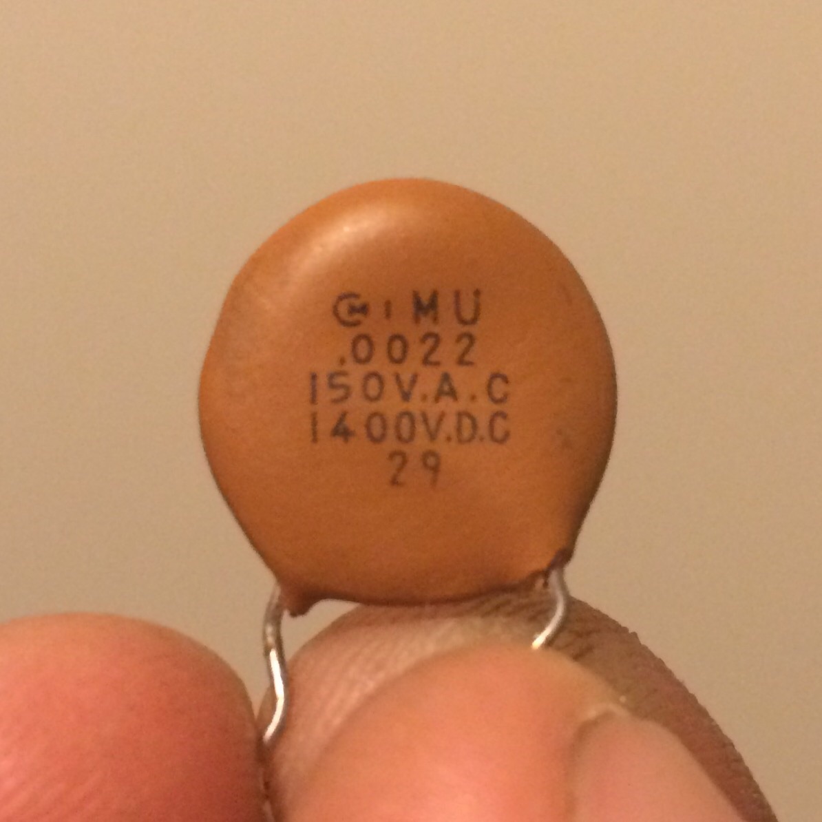

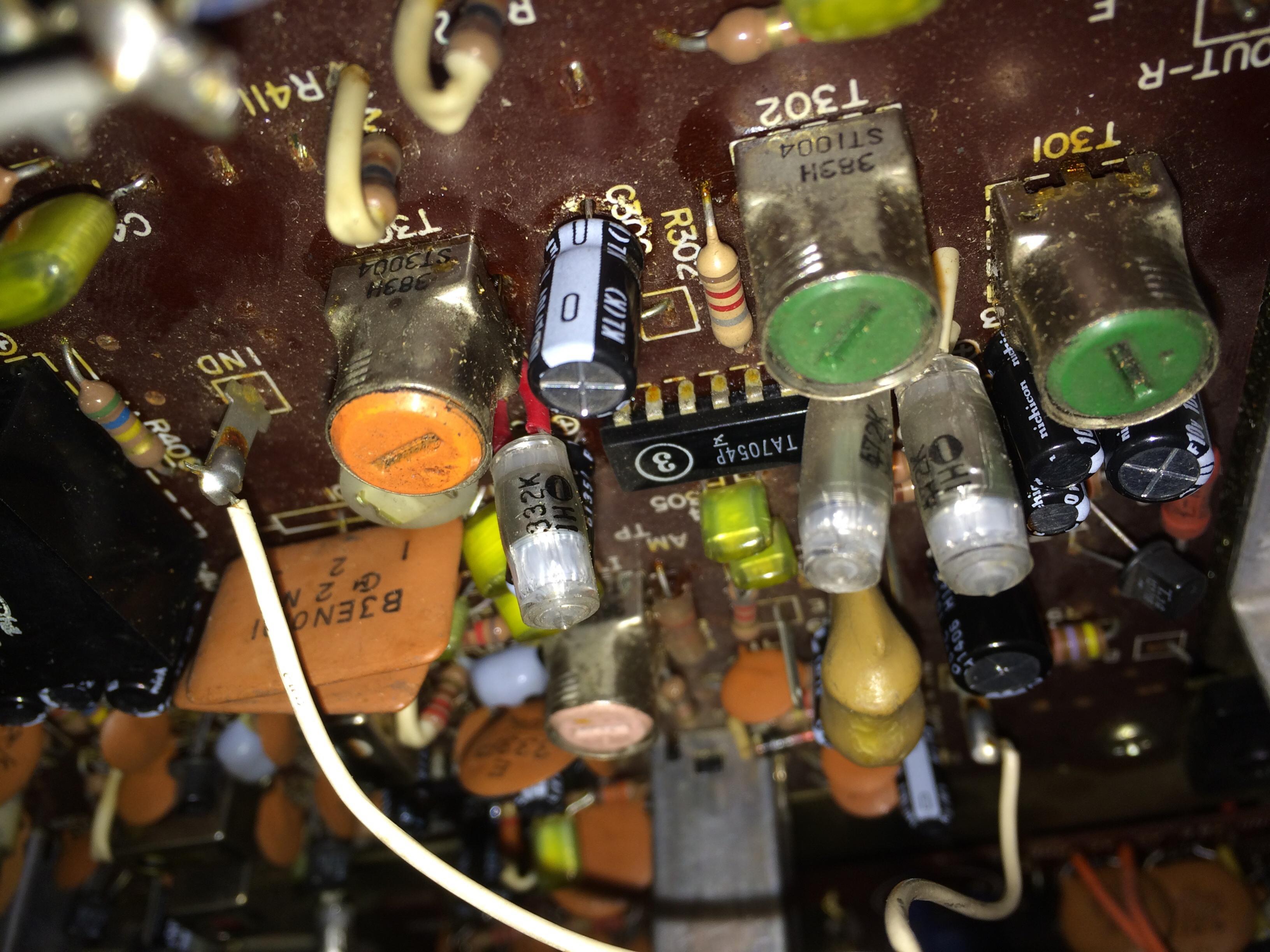

a few zip ties here and there and some replacement parts...........
this thing looks basically brand new! except the fact that its going on 44 years old and contains better parts with the bonus of 30ish watts per channel vs the stock 18!!
