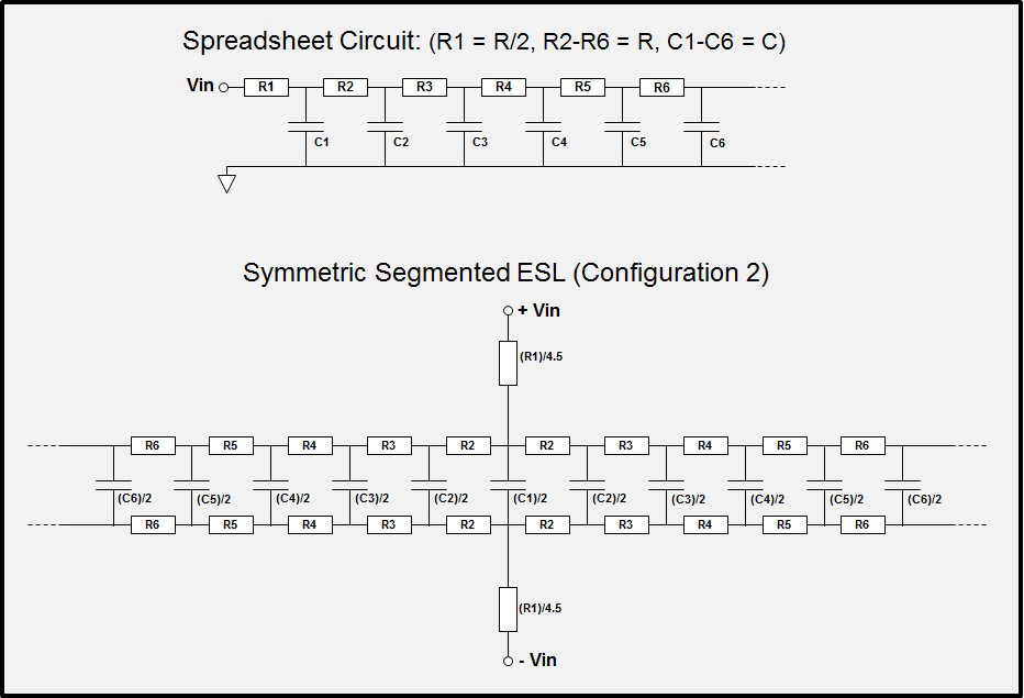

Your omitting of the first resistor and using the same R value for all remaining segments is fine.
However, R = 80.66 Kohms sounds too low.
Can you post what values you used for inputs #1 thru #6 in the spreadsheet?

Spread sheet inputs 1-6 are:
1 > 47.5"
2 > 10.5"
3 > 0.0625"
4 > 3.5 M
5 > 11
6 > 200 Hz
Giving: C/section = 81.97 pF
R/section = 80.24 Kohms
aaaAaah…ok. You incorrectly used 11 segments in the spreadsheet since you plan to have 11 physical segments. Remember for a symmetrically segmented ESL, the number of electrical segments = (number of physical segments + 1)/2. I attempted to clarify this back in post#79
http://www.diyaudio.com/forums/plan...-segmented-wire-stator-esl-8.html#post4192217
For your 11 physical segments you should be modeling with 6 electrical segments in the spreadsheet. The top figure in the Attachment #1 shows what the spreadsheet is using to model the on-axis response shown in the plot. Each of the segments has the same size/capacitance = C shown in the spreadsheet. Each of the resistors has the same value = R shown in the spreadsheet except the first, R1 is half of R.
Now, if you want to place these 6 electrical segments into a symmetrical configuration to improve polar response you start by placing the first segment in the middle. Then you take the second segment, split it in half, and place each half on either side of the middle segment. Next take the third segment, split it in half, and place each half to the outside of the second segments halves. Etc…
To further improve dispersion, you can cut the size of the center segment in half so it is the same size as the outer physical segment portions. Since you have reduced the area of the center segment, the HF response would droop if no other changes were made. To keep flat on axis response, you can adjust the value of the resistors feeding the center segment down. This is Configuration 2.
In your case, with N=6 & fL=200Hz, R= 147Kohm; with fL=220Hz, R= 133.7Kohm.

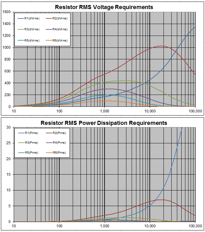

With 40Vrms input and 1:75 step-up ratio, the worst case RMS voltage and power dissipation requirements for the resistors are shown in Attachment #2. Remember you don’t need to consider R1 since you are moving that to the primary side. Obviously music does not contain continuous HF tones, so these values are rather conservative. If it was me, I would probably use two 68K/2W resistors in series between each segment. If you plan to do a lot of high SPL testing, you might consider three 47K/2W resistors in series.

I now understand clearly the difference between electrical and physical sections, but I'm still trying to figure out how the sketch below is equivalent to the configuration 2 sketch in the spread sheet-- specifically, why the R value in the idealized upper schematic isn't 2R as shown in the spread sheet.
(I'm working from memory here since I'm at home right now without and I can only open the spread sheet on my work computer)
I'm a little depressed right now …having to rethink whether the (11) physical segments / (6) electrical segments sufficient.
I think you are just fine as is. You will not be disappointed with the dispersion.
Remember Configuration 2 with (6) electrical segments is nearly equivalent dispersion-wise to Configuration 1 with (12).
Configuration 1 is what the AES paper design formulas and my rule of thumb are based on.

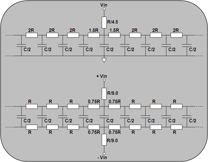

The 2R value you are thinking of is if you only segment one of the stators.(top pic)
In practice dispersion is improved if you segment both stators(bottom pic) even though theoretically there should be no difference.
This is the "standard" segmented stator configuration that most people use.
Basically, going from top pic to bottom pic, you are moving on of the 2Rs to the other stator.
It is a series connection of 2R & C/2, so it is electrically equivalent with one R on either side of C/2 or 2R on just one side.
