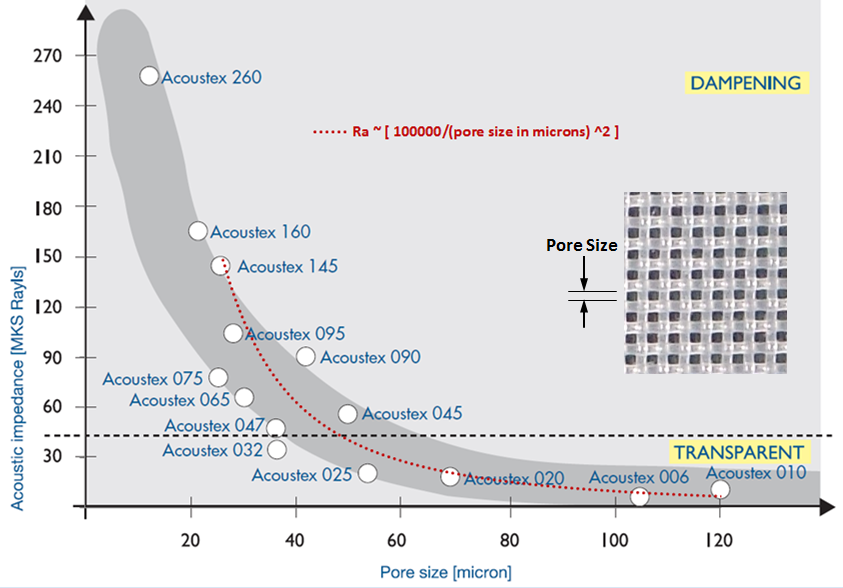

From your pics, I think your thread count estimate is about right ~ 100/inch.I had Mom get some of that really fine material used for Window curtains but I haven't had the chance to try it yet. I have no idea what its mesh number is, I think she told me but I forget what it is.
It may be around 90 to 110 per inch.
Unfortunately, the thread size looks pretty small resulting in the pore size being relatively large so it will likely not provide a whole lot of damping.
To a first approximation, acoustic resistance for thin monofilament mesh is inversely proportional to the square of the pore size. Mesh thickness and % open area are important terms as well, but the pore size is the dominant term for the range of resistance we are interested in. The 110 and 160 count mesh I measured in the post linked above had acoustic resistance of about 8 and 18 Rayles respectively. I would estimate your cloth would be less than 5 Rayles. For good LF damping, you need something more in the 30 – 40 range. If you use mesh on front and rear stators like I do, the resistive damping is additive. It also provides a decent amount of protection from dust and cat hair getting into the air gap.

Mesh made for silk screening with 160 – 200 threads per inch would be a good starting point.

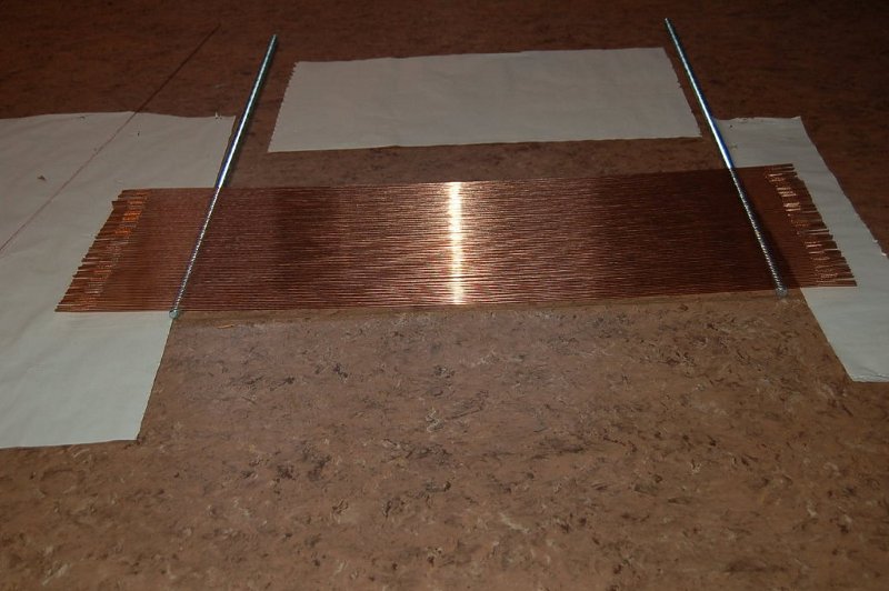

cutting rods
Simple method for cutting large amount of rods.
I used 4 hose clamps to bundle the 10 lbs of rods about 1 1/4" in dia and placed them in my cut off saw.
Now I have 32" long precision cut lengths. Now
have to decide on 32 or 64". Gonna try rod end fusion
using my big 400 amp welder. Gettin the current set will be the big trick.

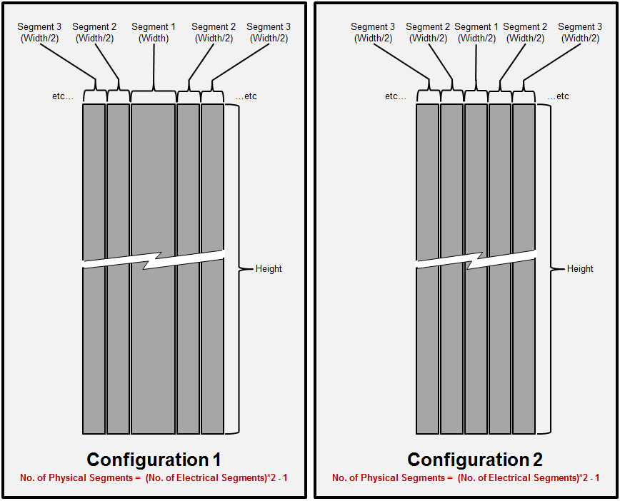

13 segments of 5 rods each looks pretty good to me.
0.060" rods spaced at 50% would give segment width of 0.6" (15 mm) . The rods will be a bit thicker once you include the dielectric coating and pull the open fraction of the area down to 40%, which is about right.
According to Bolserst's rule of thumb for good polar response (horizontal dispersion):
lowest frequency=100 kHz/4N^2 (=149Hz),
so it should comfortably perform down to 200 Hz

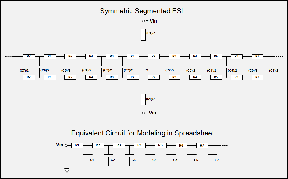

Just need the panel (or segment) capacitance now to determine the correct intersegment resistors.

Just to clarify, the “N” in the rule of thumb equation is number of electrical segments(not physical segments) in a Symmetric ESL using Configuration 1. If you have 13 physical segments of 5 rods in a symmetric ESL, this would be a Configuration 2 symmetric ESL with 7 electrical segments. (see Attachment #1). Recall from post #39, that using Configuration 2 provides nearly the same dispersion as a Configuration 1 ESL with twice as many electrical segments. So, I believe your conclusion is still correct that 13 segments of 5 rods is about as good as you can get with fL = 200Hz.
Attachment #2 attempts to clarify the width and number of segments(physical and electrical) for the two symmetric configurations from the Excel spreadsheet calculator posted here: http://www.diyaudio.com/forums/planars-exotics/48120-experiences-esl-directivity-9.html#post2218526
The width and segment numbers in Attachment #2 corresponds to the "W(sec):" and "N:" row entries in the spreadsheet's design table.
