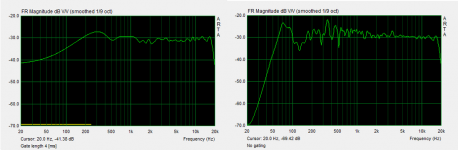

I've not built any panels with light diffusers before. I'm wondering if a .375 plastic grid with tiny .035 rods will have enough mass to resist audible ringing. I've not heard anyone say that's an issue so I'm hoping it won't be. I'm expecting to have the diffusers early next week.
My experience is that this is not a problem. If I tap on the 3/8" panels the predominant frequency is the resonance of the diaphragm. There is also a lower component which is the resonance of the panel itself, but that is lower than the diaphragm resonance yet. In the case of the 15x36 3/8" panels I built, the diaphragm component was at 83Hz, the panel resonance was at 31Hz (with the extra stiffening rods on the back).
The panels I made with 1/2" louvers were considerably stiffer and I was not able to even measure a panel resonance.
