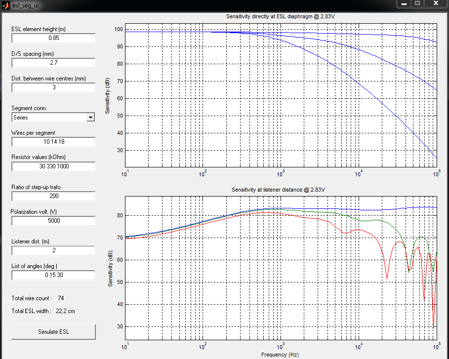

Usually stretched wire stators are glued to a framework rather than light louvers. (pic #1)
Concerning crossbar spacing:
It is important to consider crossbar spacing when selecting wire size.
The thicker the wire, the further apart you can space the crossbars. Here are some recommendations based on building experience:
22 AWG, Crossbar spacing = 2” max
20 AWG, Crossbar spacing = 3” max
18 AWG, Crossbar spacing = 4” max
These spacing recommendations assume that you stretch the wires to strengthen(cold work) and straighten them,
and then release most of the residual tension before gluing wires to crossbars.

Concerning spacing & stretching of wires:
The two most common methods of spacing the wires is with threaded rods, or pins.
Bazukaz has posted a few pictures of his wire stretching jigs using threaded rods. Wire spacing is determined by thread pitch.
Two pics attached below, and a few links with additional jig pics(both rod & pin):
http://www.diyaudio.com/forums/planars-exotics/96020-esl-welding-rod-stators.html#post1134067
http://www.diyaudio.com/forums/plan...vre-panel-solvent-acoustat-2.html#post3722626
http://www.diyaudio.com/forums/plan...nel-efficiency-first-build-4.html#post3403359
http://www.diyaudio.com/forums/plan...stators-plastic-like-esl-57s.html#post3375308
http://www.diyaudio.com/forums/planars-exotics/71171-wire-stator-gluing-method-11.html#post3717541
http://www.diyaudio.com/forums/plan...sl-project-file-translated-5.html#post2249055
I chose to use pins rather than threaded rods so that I can have more control over the layout, adjacent wires are already attached to each other(no tedious soldering required), and I can include longer lead-out wires for connecting the segmentation resistors. Wire spacing is determined by pin spacing and pin diameter. Dowel pins work great for this application as they are strong and come in a range of diameters. Pics attached below show one of my pin stretchers before and after loading, and one from Wrinex.
If I remember correctly, it took about 30 lbs of force to stretch a single 22AWG wire, 50lbs for 20AWG. So, if your panel has 80 wires and you want to stretch them all at once the stretching jig will need to withstand 2,400 lbs of force for 22AWG and 4,000 lbs of force for 20AWG. The end blocks or threaded rods holding the ends of the wire will need to handle the force too. Each pin needs to handle the force for stretching 2 wires.
It takes a bit of time and thought to construct the jig. But once completed, it takes less than 15 minutes to string the wire between pins, stretch them, and have a perfectly insulated wire stator element ready for gluing to the stator frame crossbars.
