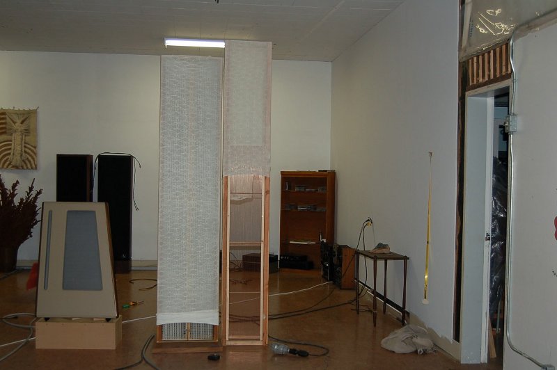

I've still not got my head wrapped around how many segments would be optimum. I don't want to compromise treble response or give up too much SPL but I don't have a feel at all for what is the optimum number for "N".
I'm thinking my panel, having 10.5" x 46.5" emitting area, should have 11 segments with 12 rods per segment, 132 rods total. Does that sound about right?
Actually 13 rods /inch x 10.5 gives 136 rods, and if I omit the 2 outer rods that still leaves 134 rods. I hate to not drive every bit of useful diaphragm area so I would like to use 134 rods. So where would I put the 2 extra rods ? Would it make a lot of difference if I used 14 rods in the center segment and 12 in all other segments? Or would it be better to add 1 extra rod to the edge segments?

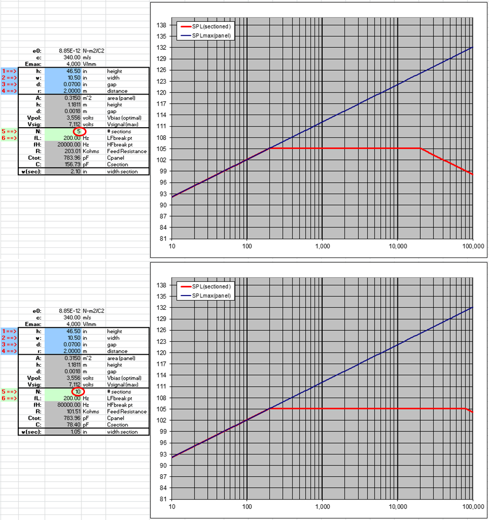

SPL level is set by panel dimensions and choice of fL.I've still not got my head wrapped around how many segments would be optimum. I don't want to compromise treble response or give up too much SPL but I don't have a feel at all for what is the optimum number for "N".
In your situation, your panel dimensions are set and you have chosen fL=200Hz…so SPL level is set.
Changing N will have no effect on SPL, only the HF dispersion and extension.
See attached screen grabs for your dimensions with N = 5 and 10. Notice SPL level is unchanged, only HF bandwidth limit changes.

Reason for seg build
Hi The reason I'm building these panels is to have crystal clear vocals in the lower registers, My Acoustat 2+2 are slightly veiled, it drives me buggy, I planed on stacking these panels 3 high to sit beside the Acoustats , Acoustats being the bass panels, Will this work , or am I wasting my time? I will be bi-ampg using a dbx driverack 260 or 482
