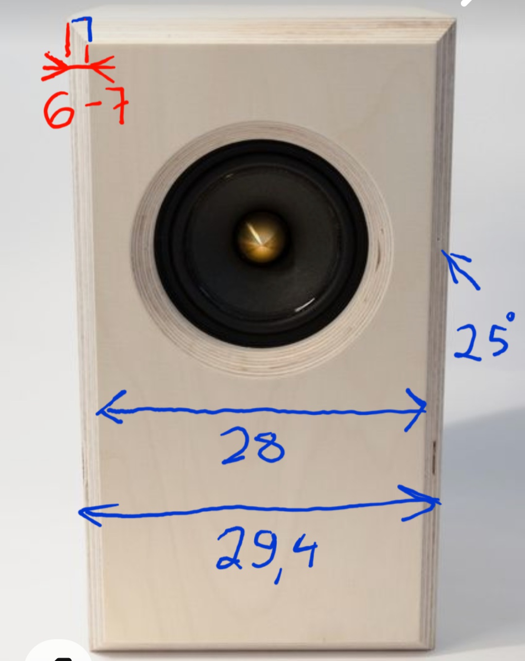

hello joe, i would need your help again. I have finished my basic housing and planned to put the 18mm front panel on individually approx. 7mm wider and beveled at 25 °. The original 28mm dimension was retained on the front edge. At the rear edge of the 18mm front panel I would set it to 29.4mm. Would a correction of the frequency crossover be necessary for this? or is this still possible area? An example in the picture below. best regards Steff

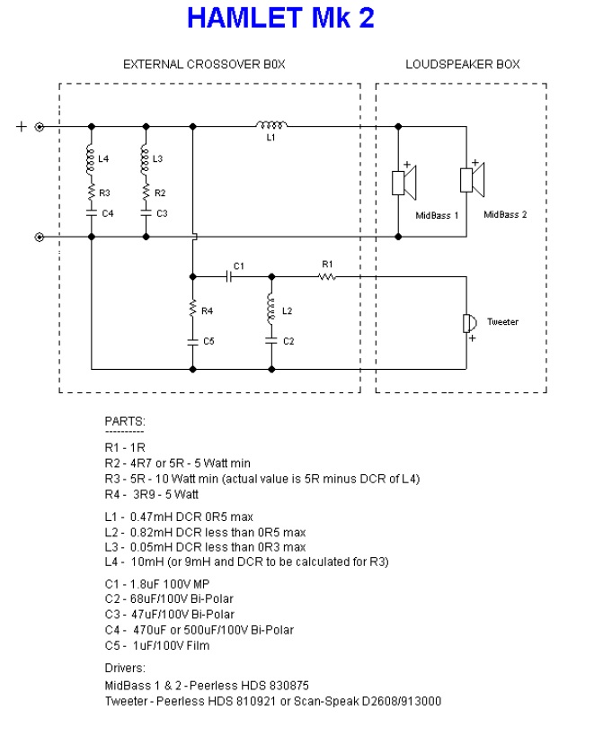

Sorry, a couple other questions re: the Mark II Hamlets..
The original posted xover schematic had the tweeter high pass after the RC networks of the low pass filters... which is how I connected it... I have noted that it seems like sometimes the voices seem a little muffled... not certain whether this would potentially be the cause? Also, I used a solen air core inductor for the 0.47mh inductor rather than a corresponding Jantzen copper foil inductor similar to those suggested for the elsinore xovers.. not sure if this would've affected the speaker sensitivity, as the Jantzens are listed as allowing for high current capability? Maybe this would be important as the mids on the Hamlet V2s are connected in parallel?

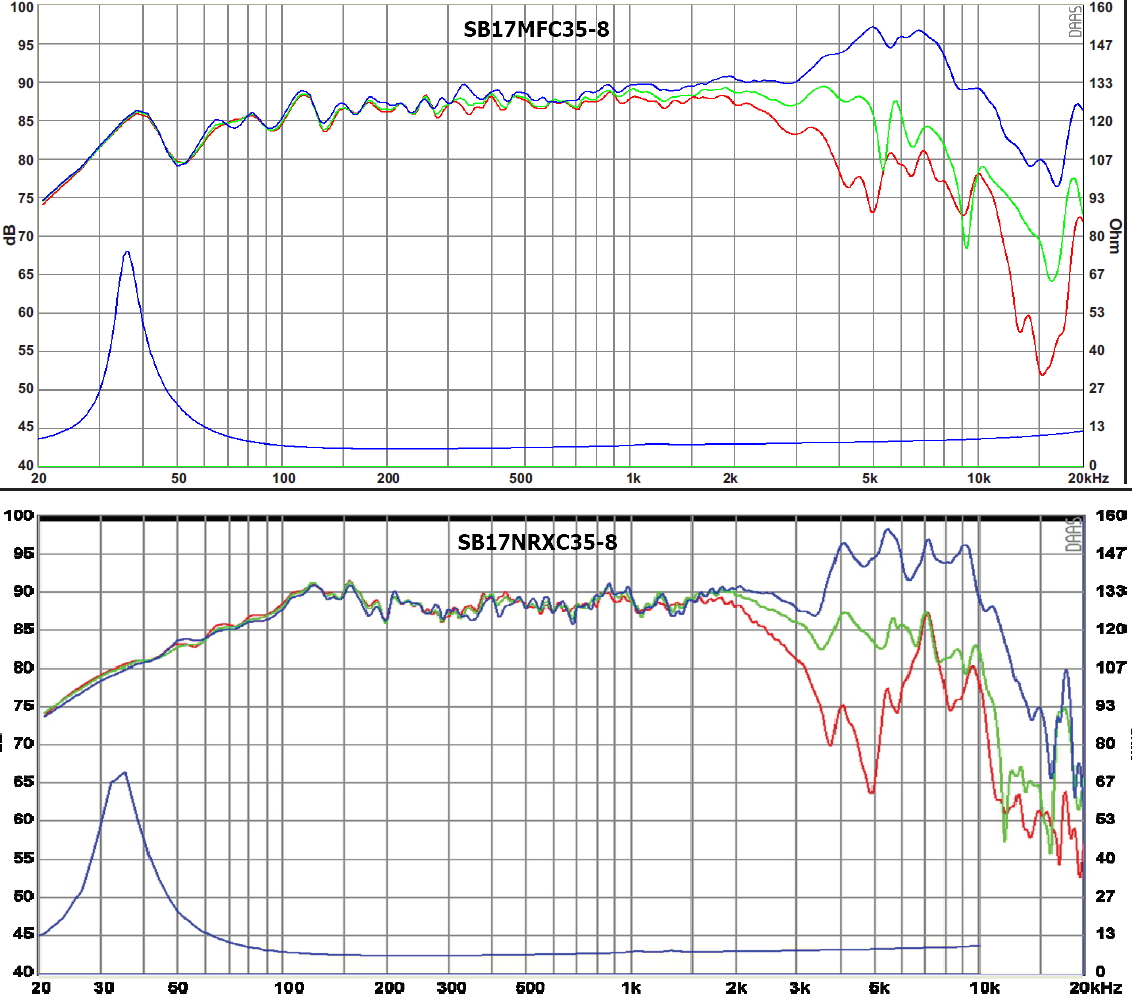

Regarding the differences between the NRXC and the later MFC.
- One can see two major differences between the MFC and NRXC respons curves : 30to60Hz and 3to10kHz. (And a smaller one from 100to250Hz).
>>> Some values of the crossover were changed.- Qts and Vas are not the same, was the case (+port length) changed ?
sb17nrxc35-8/ : Qts 0.34, Vas 44.5 l
sb17mfc35-8/ : Qts 0.37, Vas 39 l
