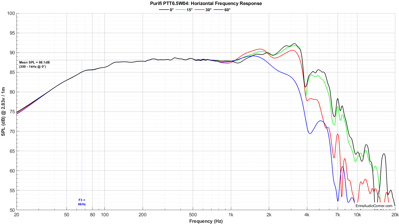

Erin's Audio Corner and HifiCompass have limited off axis plots of the first Purifi 6.5" driver.What is interesting about that ring of mass-loading, it will decrease the surface area of the cone with increasing frequency, particularly above 1KHz. It should also improve off-axis response (and roll off in a more controlled way), but I haven't seen Purifi publish those. Maybe I will be the first one to do that after measuring them?
I stand corrected.
This is not the exact same driver, this looks like the earliest version, the long throw. But it should look similar. I like what I am seeing!
Look how close 0-30 degrees, how consistent. That I think would largely be due to that perimeter mass ring.

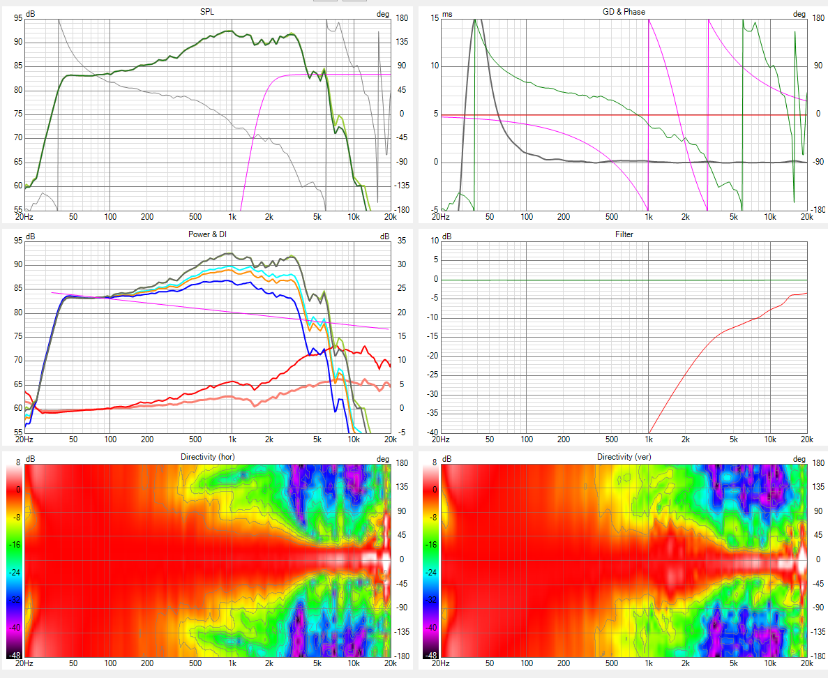

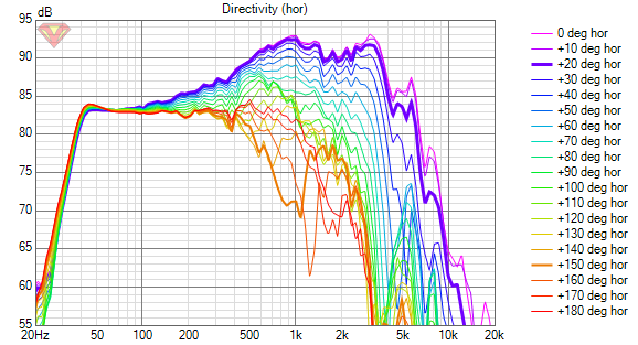

This is Klippel Nearfield Scanner measurement of the driver in the enclosure shown with the passive radiator.
The DI kink is from the 150 degree off axis (and other angles) measurement which I have highlighted here

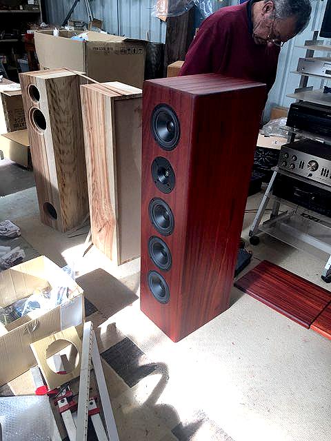

Below is the photo of the Elsinore that replaced that Raidho speakers, near the end of it being made by a real artist, some kind of South African hardwood.
