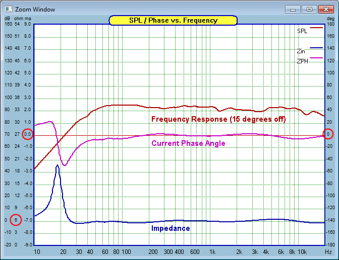

http://sound-au.com/articles/boxstuff.htm
With a rear mounted port, the upper pipe resonance peak in the combined response seen in Rod Elliott's test above is usually not much of a problem, don't go overboard with damping material...

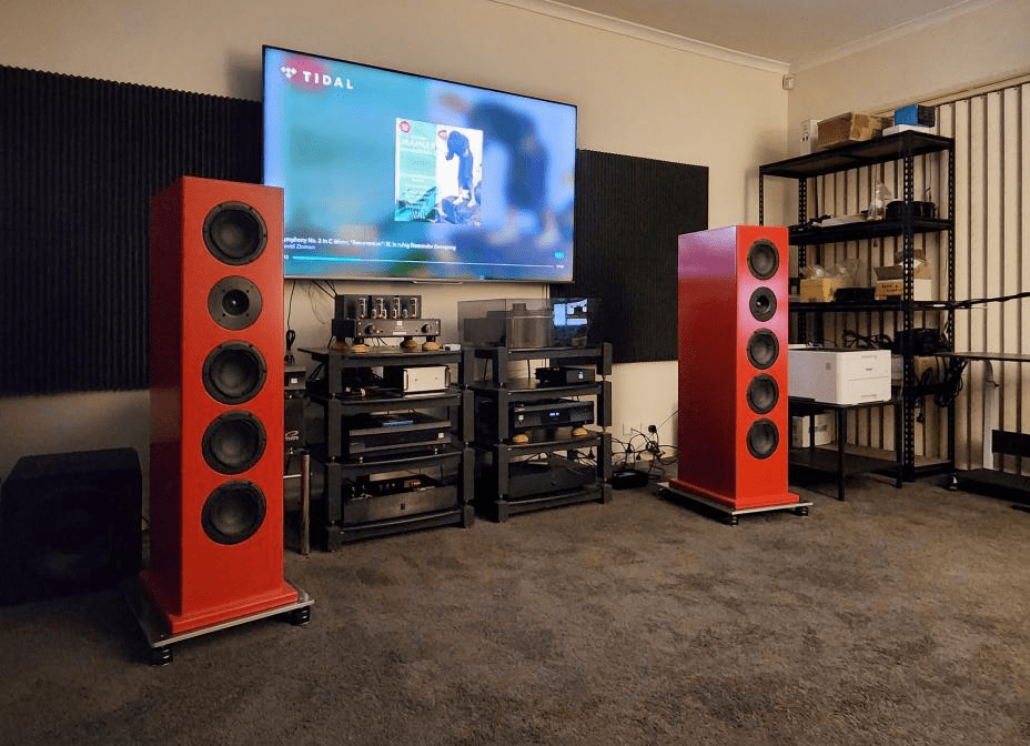

Finally getting everything in hand to start on a ULD Elsinore build after a couple of months waiting on drivers. I have two packages from PURIFI coming tomorrow (finally!) with the 8 drivers, the crossovers are already built, and have wood in hand. BTW, I am using 1” thick bamboo plywood countertop for the top, back and sides with some 3/4” bamboo plywood for the baffle and plywood or plywood/MDF laminate for the bracing. All in all, not that much more expensive than BB plywood. I still have a couple pairs of 211 SET amplifiers to finish for friends/clients, but after those are finished, I can begin on the Elsinores. Progress reports in a couple of months (hopefully).
Reactions: 1 users
Well, I do have a pic of the crossover boards. I decided to separate the crossover into two boards, one for the tweeter and upper mid-bass drivers that will be mounted between the braces on the back panel, and the one for the lower two mid-bass drivers to be mounted at the cabinet bottom.
The 211 amps that are keeping me from starting on the ULD Elsinores is shown in this gratuitous photo, next to my first Elsinore build. It is a Class A2 25W 211 SET of my own design with Tamura output transformers, D3A CCS loaded input, direct coupled EL34 pentode follower driving the 211 grid. I built one pair as a one-off, but people who hear them keep asking me to build a pair for them, so on pairs 4 and 5 right now (I did sneak a pair in for myself). I really need to put together a construction article on the design and build. But not in this thread or forum.

Elsinores, of course. It seems these amps and these speakers are an incredible sounding combination, they really completely disappear so that music is just present in the room and one is emotionally drawn into it. The Elsinores are really easy to drive (flat impedance curve) and work great with a 20W amp.
