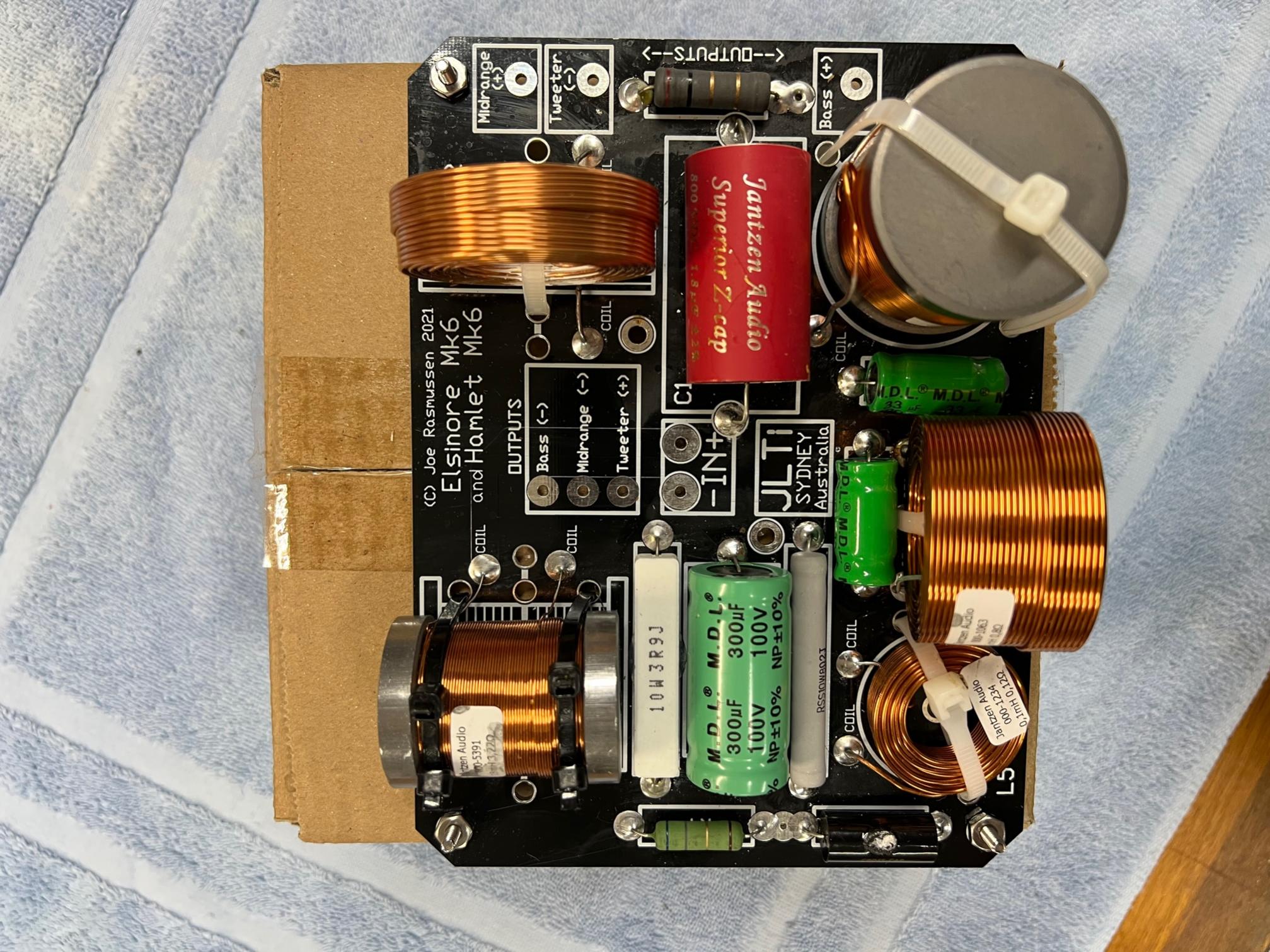

Folks,
I recently completed my 2 Elsinore crossovers using the "black" circuit boards. I have not started on the cabinets yet, but I decided to hook up one of the crossovers to the 4 SB Acoustics drivers and Scan Speak tweeter to make sure that I had not screwed up the crossover build.
I noticed that the tweeter polarity is opposite the bass and mid polarities...so the tweeter is 180 degrees out of phase with the rest of the speakers?
I verified the polarity shown on the schematic with the actual board -- to make sure that the tweeter was marked as opposite polarity. Can someone explain this please...???

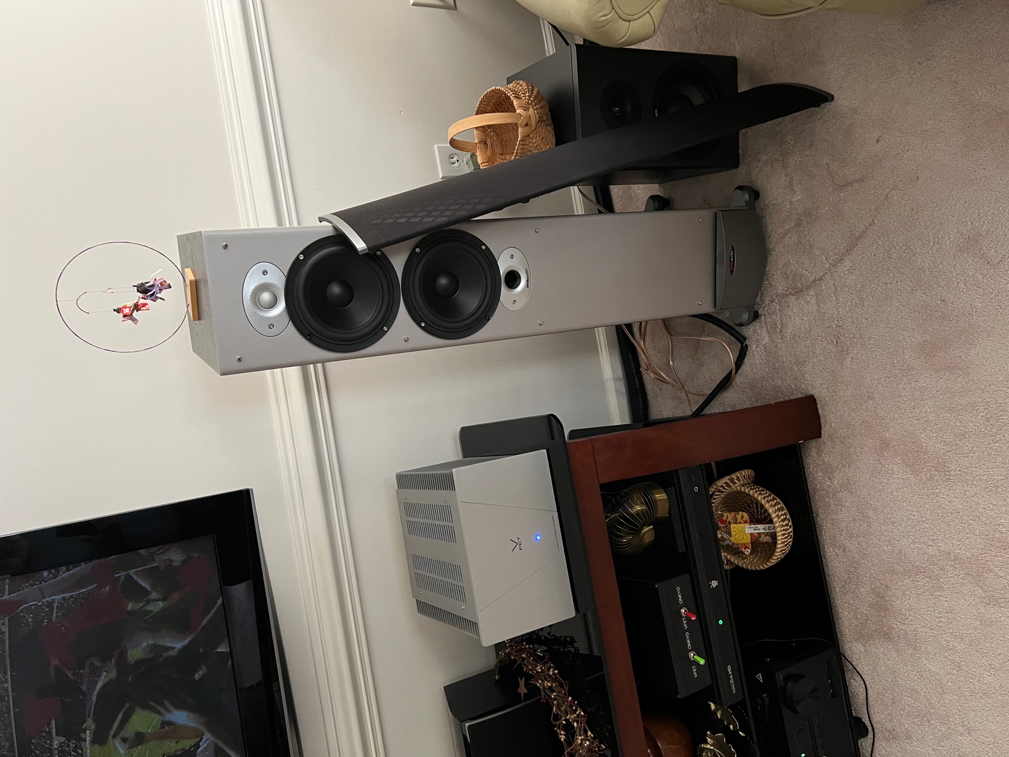

By the way, just for fun I opened up my Polk RT-8 2-way speakers, pulled out the 2 "6 inch" drivers in each cabinet, and replaced them with 2 of the SB's...could not swap out the tweeter --
Even though the Polk drivers seemed to be of pretty good quality (acoustic suspension and quite a large magnet -- heavy!!) the clarity and depth improved tremendously with the SB's in those cabinets. (I did notice that the SB Acoustics drivers had a lot more "throw" to the cone when I verified the speaker wiring polarity with a 1 1/2 volt D cell battery??)
My next iteration will be to cobble together the SB's in the Polk cabinets with the Elsinore crossovers and see how that sounds!!.
I'm Still waiting for winter weather to start the Elsinore cabinets but in the mean time, I think I'll enjoy my "hybrid" Polk speakers coupled with my Sony Vfet amp and Amp Camp Preamp -- and Elsinore crossovers.

Tweeter polarity
Thanks ScottG --
I arrived at the Elsinore party quite a bit later than most of you folks -- so I was not aware of the Renegade Tweeter Theory -- Now that I'v read it a few times, it kind of makes sense --
But how much of the phase shift effect is due to the fact that the drivers and tweeter and crossover and case are all tuned to together?
In my case where I hijacked the drivers and crossover and put them into my Polk cabinet (and used the existing meager Polk-installed factory tweeter) does the phase reversal wiring still hold?
By the way, I know that this setup is sub-optimal -- but patience is not one of my fine attributes -- I'd have a hard time waiting for the cabinets to be built -- sub-optimal is still way better than factory Polk...

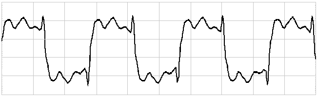

I don't fully agree with that theory. If you look at the square wave response of a full range driver that is running in phase, it will have the leading edge go positive first and drop off gradually. The time it takes for the wave to drop off is equivalent to low end extension. An overshoot is indicative of ringing like a metal dome tweeter has. The more perfectly right angle the leading wave edge is, the more linear and ideally dampened the HF response is.

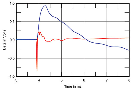

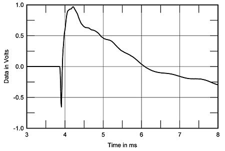

The Lipinski L707 speaker also uses this method:
Above is the combined step response.
Below are the traces of individual drivers:
These examples are from Stereophile and John Atkinson's comments shows he understands exactly what is going on:
"In the time domain, the L-707's step response (fig.7) surprised me by indicating that the tweeter is connected in inverted acoustic polarity to the woofers. Despite the setback of the tweeter subbaffle and the low-order crossover filters, the speaker is not time-coincident. This was confirmed by looking at the step responses of the individual drive-units (fig.8). But what is important to note from this graph is that the overhang of the tweeter's inverted step (red trace) blends smoothly into the woofer's step (blue). This time coincidence correlates nicely with the excellent frequency-domain integration..."
What you get is 1st order electrically that sums at -6dB rather than Butterworth 1st order that sums at -3dB (that's bad).

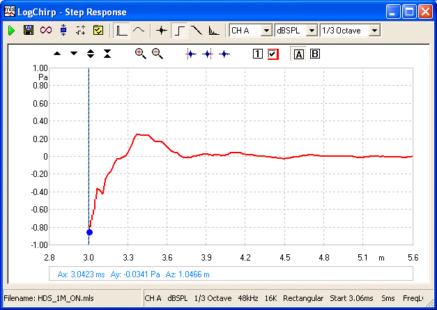

What do you call this?
Note the rounding at the leading edge and the small narrow peak on the trailing side. That peak is where the tweeter shows up, but above 10KHz.

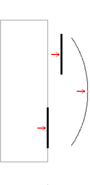

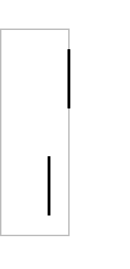

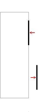

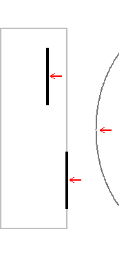

It's relative to the acoustic center/setback of the midrange.
Basically, to get good integration the tweeter must be physically deeper into the cabinet relative to the midrange. (..of course the net result of the high-pass/low-pass for each driver (mid. and tweet) is also critical.)
Joe does this with a waveuide, but you could also do a stepped-baffle (tweeter inset) with some foam around the tweeter to decrease diffraction.
