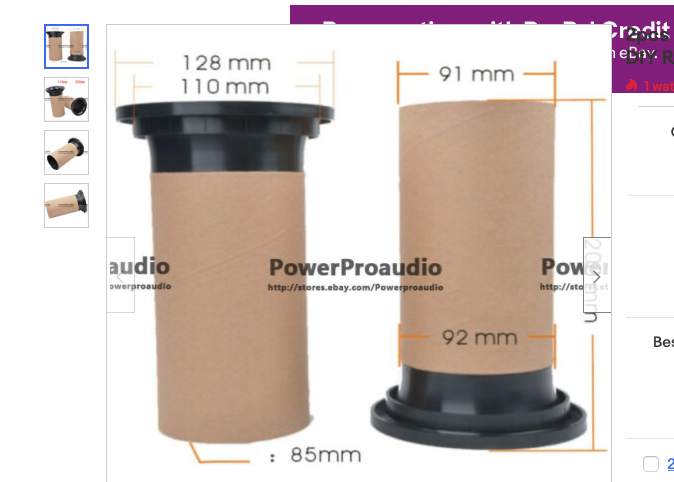

Incidentally...I used these not sure which diameter,
Speaker Cabinet Port Tube 2" ID Adjustable
I cut the hole to the I.D. of the port and used a round over router bit, and screwed the port to the inside. Troels Graveson has some info on rounding over the inside of a port...let me just say...I do paint and body for a living and I have worked on at least thousands of plastic bumper covers, if not tens of thousands, and it didn't work for me. That doesn't mean it won't work....just not for me.
But I haven't really noticed any port noise from my Elsinores, but I used I believe the flared 3 3/4" ports from P.E.
Looks to be close to perfect ID.

Thanks for the reference -- these port tubes look to be pretty close to perfect-- Inner diameter of 85mm...
I'll order a pair later today -- I'm still gathering parts for this "winter project" speaker build.

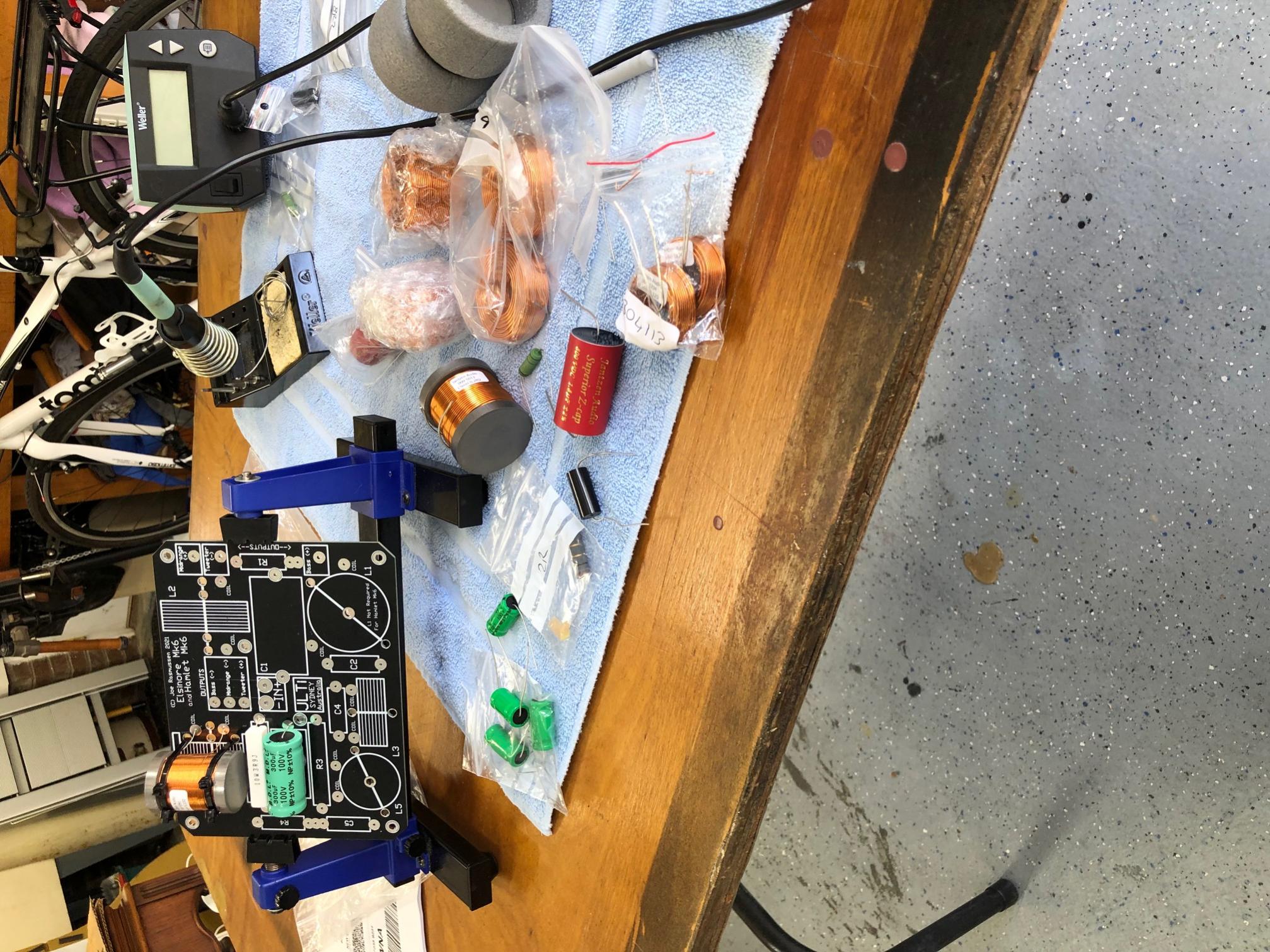

I got my "care package" containing 2 ea black crossover boards from Joe a couple of weeks ago.
Yesterday I got all of the crossover components I need to complete the crossovers for the Elsinores -- from HIFI Cooperative in UK -- received 2 days after the package was shipped. Amazing delivery speed during this time of COVID shutdowns!!
It took about a month from the time I ordered the parts to the time HIFI Coop was able to gather them all up and ship them out. But I got everything I needed from one source (and only had to pay 1 shipping bill)
I plan to complete the crossovers next week and set them aside.
Next step after that is to start on the speaker cabinets.
By the way, it's really good that these crossover boards are robust enough to hold all of the inductors -- the boards are going to be pretty heavy once loaded up with components...
(sorry about the sideways picture -- Apple iPhone picture opened in Preview got saved to my desktop in the incorrect orientation...and I can't figure out how to delete it from the preview post and reattach it to this post???)

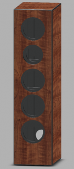

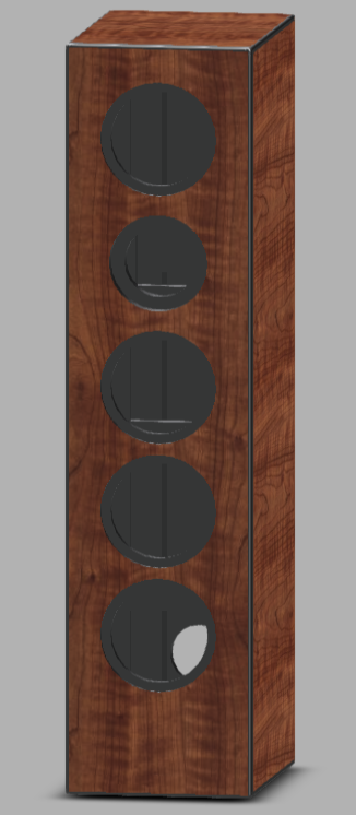

Using this project as an inspiration to get a working knowledge of fusion 360. I think I am at a point where I can share it for some feedback.
Here are the points where it differs from the Original:
  • All panel are 18mm (3/4" stock more common than 1"); keeping the ext. dimensions the same; result int. volume will be slightly different. I am assuming the diff is not enough to warrant any Xover/port changes.
  • Includes a Rabbet/Dado design (started more so as a way to learn and test parametric modeling; I suppose it also helps aligning the cabinet for assembly/gluing, does it add strength/stiffness to the end product?)
  • Did not include port/slot for connection terminal/wiring harness. (leave it as end user's choice [Terminal plate, speakON, etc])
  • 5mm radius on all corners of the finished box.
An interactive view of the box can be found here You can view it 360, explode view it, cross section analyze, measure it etc [Note Link may only be available for ~30 days]

Looks nice! The advantages of the rabbets are it limits the amount of edge grain that you have to deal with while also strength to the joints. I suspect the extra strength in the joints isn't really necessary. However, the edge-grain being limited really does help the finish work.
I also like how the top panel doesn't have any edged showing.
