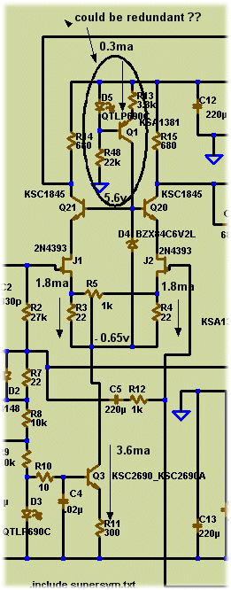

Re: Suggestion for C7
Very low voltage swing at collector of Q6 because of Q7 connected as a diode.
However, I was wondering if C7 does any good job. Despite my preliminary reservations, it may.
I just remember a discussion here about the power supply rejection at high frequencies of the standard blameless amplifier. I think Edmond Stuart proposed to improve it by connecting a capacitor of same value as Cdom in series with a resistor about 100 Ohm, from the diode side of the input current mirror to ground.
So here, C7 may have some influence on the design by providing a better PSRR at high frequencies and then should not be removed. This is only a supposition and should be checked.

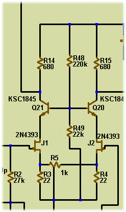

Most of the discussion we have done so far is correctly referenced to the thread front page schema. (1 schematic)
Any others are someone else's or "clips" to share ideas.
I will present the final cascoded one here.
The base amp's device numbers have not changed , the new additional cascode's device numbers are added on after the fact.
I will update the "page 1" schema to this one soon.
OS

Hi ostripper,
The Pioneer is too simple. But that is the concept. You can use an IC shunt or low noise zener (as opposed to the normal types). The resistor from the top supply could be a current source, why not? Might reduce noise in practice.
Your second diagram looks good. You should not need R5, I'd leave it out. R48 = CCS, R49=shunt reg. You only need to add the current injected by the CCS at R48 to the total and it will mostly cancel out, leaving you with your original tail current.
You're looking good there! BTW, the cascode reduces gate leakage currents if you keep it to 8 or 9 VDC abs. max. Running anywhere around 6~7 VDC would be good, the major consideration being a low noise shunt.
R5 is gone , that was tested on the "Guinea pig" (real amp) , the zener shunt (replacing r49) is an improvement. The use of a second CCS instead of 220k (r48) is redundant , only 1DB more psrr. The tail reference is rock solid at only .001ma "slop", and the cascode is locked to that through the zener. If we are going to allow for the use of a separate VAS/LTP power supply anyway, it would be definite overkill.

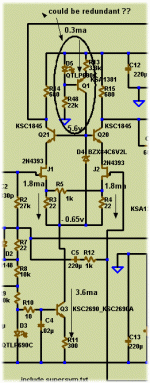

Hi ostripper,
But then again, maybe not. In real life the CCS may actually be noisier than the resistor (I doubt it, but could happen), depending on the resistance of your shunt regulator. If it goes up with frequency (common for IC's), then your PSRR might go down the tubes at higher frequencies. With a regulated supply for the voltage amp stage, I don't expect to see much in the way of noise or ripple on the rails. Possibly some audio though.
How much current do you have running through your 220K (R48) resistor? I am just trying to make sure that you have enough current flowing so that base current draw from Q20 and Q21 doesn't cause too much variation. Those devices normally have a beta of around 68 ~ 80, don't they?

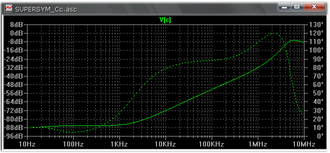

In the event that someone (probably many) do not go for the separate voltage amp regulated supply, can you simulate this with and without the CCS for R48. I just love little red LEDs glowing away in the chassis! Just put an AC voltage source in each rail of your sim, on the output transistor side of R44 and R45. Make it a sawtooth of a couple volts. I am being nice about the amount of ripple to expect under heavier loads. For those who decide to go for a voltage amp reg supply, just make it so the CCS can be replaced with a resistor if desired.
Sorry for putting you to work this way ostripper. The answer is of value for any design, so while you are at it ....
Thank you, Chris

Completely!The use of a second CCS instead of 220k (r48) is redundant , only 1DB more psrr.

Attached is the PSRR plot , both rails with a 1V out of phase swept sine (I made it so the phase changed with the sweep). also tried it with fixed square "filth" on the rails. 85 - 88 DB was the result over
most of the audio range. This is absolutely confirmed in real life ... NO crosstalk , at least not audible.
