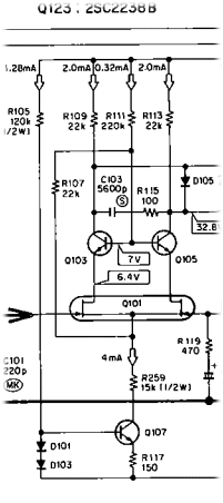

Hi ostripper,
Reference the cascode to the common emitter of the diff pair. The entire idea is to lock the C-E (or D-S) voltages. Why allow a common mode signal to upset the apple cart? A common mode signal could be even signal peaks at high volumes where you are comparing input to feedback.
For more information, look at many Japanese amplifiers (this is one place they do it properly), or even Doug Self's book. My lowly bench experiments years ago showed this to be better at higher signal levels. A cascode arrangement seems to sound cleaner to my ear. This could simply be that the input pair are running cooler and isolated that little bit from the rails.
Please, don't reference to ground for those. Sim some other successful designs to see if there is something about your simulator. Unless you are messing with the tail current big time, there should be not effect that would cause it to be unstable. Try increasing your tail current to compensate for the reference current for the cascode voltage set supply?

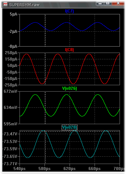

Suggestion for C7
Ostripper -
The earlier discussion on C7 resulted in what might be its premature removal from your design. As pointed out earlier, C8 gets the benefit of the Miller Effect because there's voltage swing at the collector of Q5, while C7 does not show the same effect because there was very little voltage swing at the collector of Q4. Have you tried connecting C7 between the base of Q4 and the collector of Q6? That's where the voltage swing is.
Here is the Ic across C7 with Q4 base to Q6 collector (attached) I- C7. there is a little more "swing" there , but just 1.4v, since it is cascoded. The Ic on C8 ... I(C8) is 100 times greater. I don't think
C7 is needed with the cascode. With the original otala or hitachi design ,(resistor instead of cascode -Q6) C7 would have miller characteristics.

by anatech - Reference the cascode to the common emitter of the diff pair. The entire idea is to lock the C-E (or D-S) voltages. Why allow a common mode signal to upset the apple cart? A common mode signal could be even signal peaks at high volumes where you are comparing input to feedback. For more information, look at many Japanese amplifiers (this is one place they do it properly), or even Doug Self's book. My lowly bench experiments years ago showed this to be better at higher signal levels. A cascode arrangement seems to sound cleaner to my ear. This could simply be that the input pair are running cooler and isolated that little bit from the rails.
Do you mean like the pioneer M90 ?? (attached) It seems so simple how they did it with a simple voltage divider from rail to tail , but it simulates perfectly and even shaves a hair off the THD.
