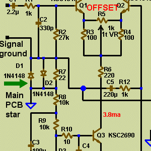

Signal Ground is part of the input flow and return circuit.Rafael.luc said:what is the function of these diodes and resistor 22 Ohms?
The Ground can be exposed either at the amplifier or at the far end of the interconnect.
This exposed part must be connected to the Safety Earth.
The diodes should provide the high current route from Signal Ground to Safety Earth.
Signal diodes are the wrong choice for this duty.
1n4001 would be better.
1n5401 better still.
Do we need the 22r?
What effect does it have on the amplifier's performance?

I do not understand why anti-parallel two diodes, do to improve Safety Earth.
Discussion started here:
http://www.diyaudio.com/forums/showthread.php?postid=739086#post739086
But, I do not agree with the use...
Antiparallel diodes will isolate the chassis (and the AC noise picked up by the house wiring and case) from the circuit until the diodes conduct....which hopefully will never happen. So if there is noise on saftey earth it will not show up in the circuit.

I had forgotten that discussion.Rafael.luc said:I do not understand why anti-parallel two diodes, do to improve Safety Earth.
I agree that the Signal Ground can benefit from some form of Audio isolation from the Power Ground.
I insist that the Signal Ground (if exposed at any location) must be connected to Safety Earth.
What I am asking is:
Can we just use a pair of inverse parallel diodes to connect the input circuit to the Safety Earth?
Does the circuit/amplifier NEED the resistor from Signal Ground to Power Ground?
If an unsafe voltage accidentally contacts the Signal Ground somewhere along it's route then the diodes conduct, with either polarity, to Safety Earth when the voltage >~600mV
Without the resistor a potential difference between power and signal ground of up to ~600 mV can build up. That would offset the correction signal and affect the NFB function. The lower the signal voltage, the worse the effect.
E. g. with the feedback combination 27k/1k shown in the last schematic 60 V output signal should give 2,14 V correction signal, but can give anything between 2,14 and 2,74 (up to 28 % difference). 6 V output signal should give 0,214 V correction signal, but can give anything between 0,214 and 0,814 (up to 280 % difference). 0,6 V output signal should give 0,0214 V correction signal, but can give anything between 0,0214 and 0,6214 (up to 2800 % difference).
I would think that the differential amplifier at the input does not need a connection to Power Ground.pacificblue said:Without the resistor a potential difference between power and signal ground of up to ~600 mV can build up. That would offset the correction signal and affect the NFB function.
The NFB ties the output to the input. The output is an amplified version of the difference at the input.
Do we really need the resistor?
