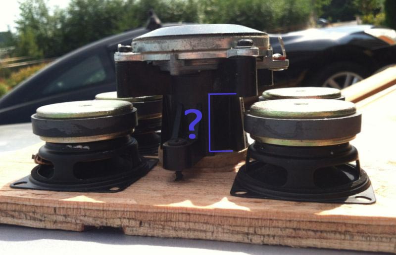

Hey Patrick, can you measure the distance from the bottom of the driver to the bottom of the back cap bolt flange on the Celestion?
The two buck midranges are 1.25" deep, and they don't quite fit under the Celestion. So that's about 1.125" deep. My CDX1-1425 is in pieces right now, so I can't measure it. In the pic I've inserted a 0.25" space beneath the Celestion.
