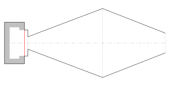

Here is my concept. I cheated and used a 3D modeling software. The overall path length, 1/4 wave length, or what ever you wanna call it, is 6.75". The panels are 1/4" thick. The mouth opening is also 1/4" wide. I'm still working on it. I'm planning on adding some mids to it as well. With a little horn at the mouth I'm hoping to load this thing down to 200Hz. We'll see.
Front shot
Iso view
Bottom cross section
Side cross section
I hope I'm doing this right.
Front shot
Iso view
Side cross section
Your plan seems to be missing two important parts, the parabolic conical reflector at the throat entrance, and the 45 degree exit reflector.I hope I'm doing this right.
These things are so easy to build, I say just dive in and make one. No need to make this too complex.)
It gets a little trickier trying to get the path length math right when I've only got 10 fingers and 10 toes. I guess I can wing it and put something there. Would something be better than nothing?

The object of the deflector in the initial throat area is direct the wave into the open guide and reduce or eliminate the reflection back into the throat of the device. The reflector at the end of the guide is directing the wavelength to pass out of the guide into the lens and not to just return through the path back to the driver also. /Think of these as directional control, where are you attempting to direct the waves. A simple or complex shape could be a simple as a round reflector or a parabolic reflector in the initial section and the same follows in the transition to the horn lens.

Okay, we have a couple of things to address here:
#1 -
For anyone working on a Paraline, here's an easy way to size the mouth of the Paraline. The mouth width is (pi * internal height). For instance, with an internal height of 0.25", the mouth width is 0.785".
Here's the full formula:
mouth width = (2 * pi * radius * internal height) / mouth height
This formula is just 6th grade algebra. The Paraline is a disc-shaped horn that's been folded, and the formula for the surface area of a cylinder is 2 * pi * radius * height. (http://math.about.com/od/formulas/ss/surfaceareavol_3.htm)
^^ note that the mouth height is equal to twice the radius. So we can turn that formula into this:
mouth width = (2 * pi * radius * internal height ) / 2 * radius
which equals
mount width = pi * radius * internal height / radius
the radius variable in the numerator and denominator cancels each other, so we get :
mouth width = pi * internal height
which equals
Neat, huh?
Note that the mouth is subdivided in two by the reflector, so technically it's two long strips, each strip being 0.393" wide, and the reflector is in the center. The reflector will 'push' the mouth out a bit. If you're good with the CAD programs, you might want to account for that pathlength difference. But I'm way too sloppy to bother, particularly since it's at the mouth, where pathlength differences are a lot less important than at the throat. (At the throat of a horn a difference of even a fraction of an inch matters.)

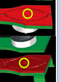

#2 -
The cone-shaped insert near the compression driver is fairly critical. But in all seriousness, these things are really easy to build. My work is pretty sloppy, but if it were me, I'd just eyeball the piece and be done with it.
Home Depot sells some cone-shaped bits that are designed for furniture. The idea is that you hammer the piece into the bottom of your chairs so that they don't scuff up your hardwood floors.
Another option is to go to a crafts store. They have all types of odd shapes. (Jo Ann Crafts has this stuff.)
The reflector at the mouth is there to redirect the sound that exits the slot. Again, I'd just eyeball it. Go to Home Depot, buy a piece 1" x 1" x 96" piece of wood, then cut it at a 90 degree angle on your table saw or even with a hand saw. When you cut the piece of wood you'll end up with a piece of wood that's 1.414" at the base.

So here's my new idea. Swap out that compression driver and replace it with a dome. While dome tweeters are usually a terrible idea when you're making a horn, I think the Paraline is a bit of a special case. If you look at the pic that I've drawn above, I think you'll see that the path lengths of a dome tweeter aren't just good, they're arguably better than a compression driver.
For instance, in the top pic I've illustrated a Celestion CDX1-1425. I took mine apart, and measured all the dimensions. Basically the CDX1-1425 has a 1.4" aluminum dome that's focused into a 1" exit by the phase plug. Unlike most compression drivers, the dome isn't inverted. (I think this is mostly because the dome is so small - it's less than half the size of a B&C DE25. Because it's so small, Celestion gets away with a fairly crude phase plug.)
Anyways, the CDX1-1425 hits a 90 degree reflector at the throat of the Paraline. Now if we replace the compression driver with a dome tweeter, we can ditch the reflector. Basically the dome of the RS28 is touching the wall of the Paraline. I'd add a little bit of felt to keep it from buzzing.
