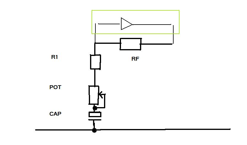

Not in parallel, but like this... although it's just a series chain the pot goes in the "earthy" end to minimise noise pickup. The resistor R1 adds to the resistance of the pot, preventing the gain going far to high. Just use a good quality commercial grade electroylitic.

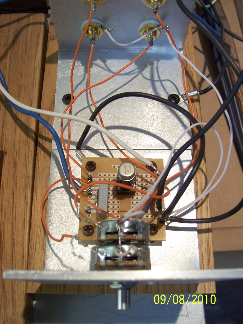

Another thing I've had going on regardless of the chip is when I turn the gain all the way up it makes some nasty noises. I'm thinking oscillating but I don't really know how to identify oscillation. Any thoughts?

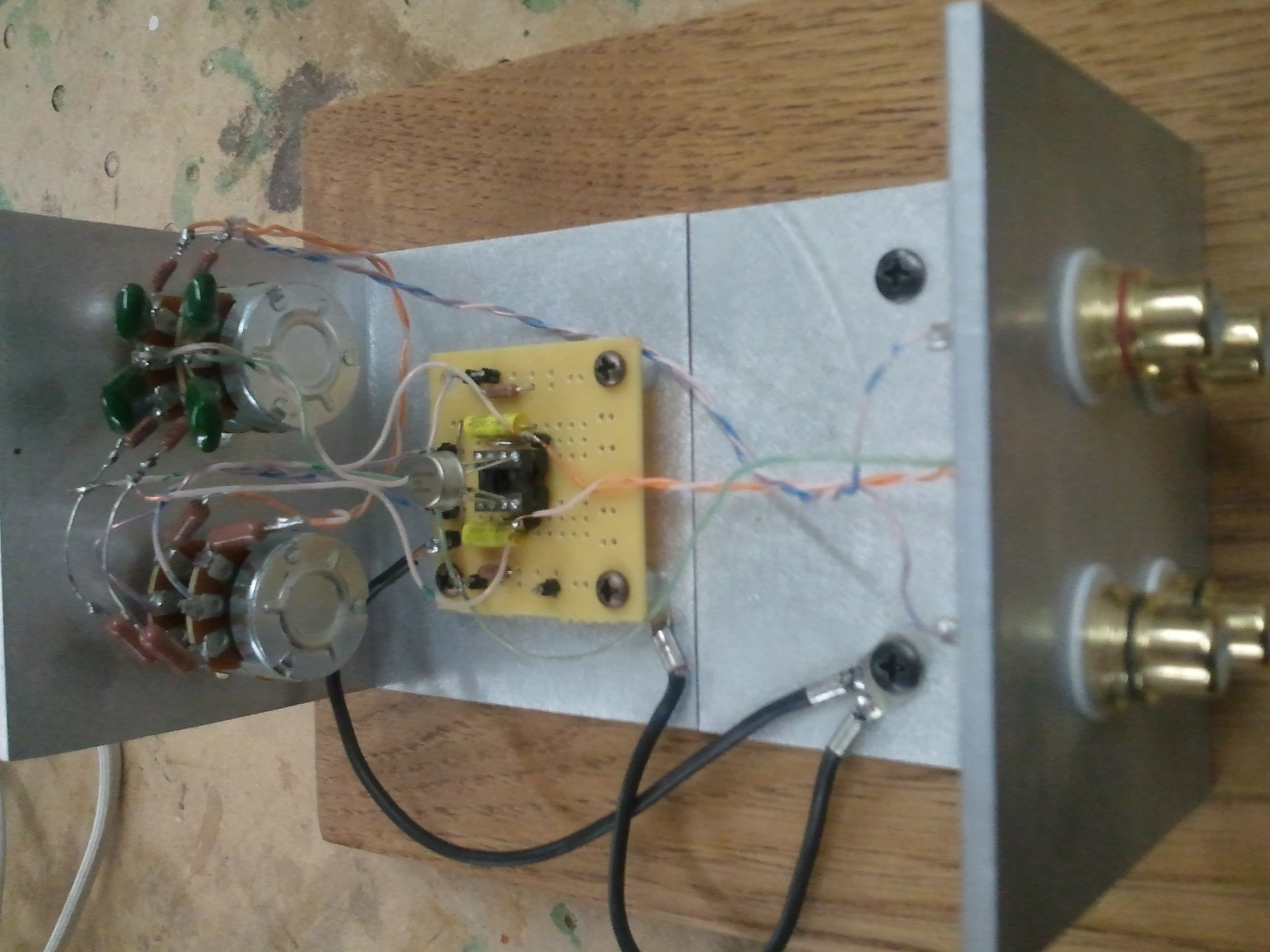

Noises... there's a lot of wiring in there isn't there

First... pot's don't like DC current passing through the wiper. That's not an issue with the FET opamp, it is with the bjt though. The cap would stop that. Also just if you wondered, the FET one can still be used with the cap in place for the bjt so you can swap and compare without changing anything.
Is the noise constantly there with the pot at max gain ? or only when the wiper is moving ?
You can short the pot out temporarily to see if the noise stops. That gives max gain.
Also have you got a small cap across the PSU pins of the opamp (4 and 8) ? You should have Something like a 10uf electroylitic... but try anything, even a 0.1uf will stop oscillation.

Yeah that wiring is out of control! Believe it or not the board and the wiring were very tidy for a while. A bunch of experimenting and tracking down grounding issues has made a mess of it. I'm going to rebuild the whole thing when I get it close to right. Probably with a different circuit board that I found.
The noise is always there at max gain.
There are no caps on the PSU pins.

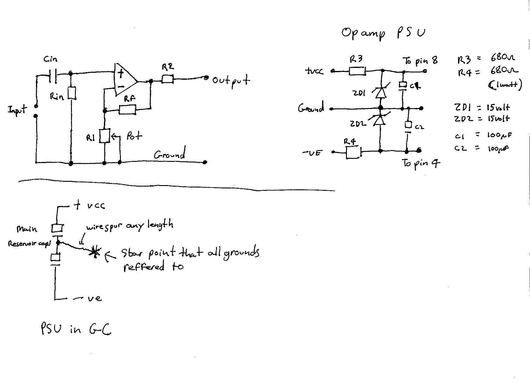

Yes you can run two stages (or more) off the zener supply. You can always drop the value of the resistors feeding them a little if needed. If the output (the voltage across the zeners) is lower than the zener voltage when it's all connected up to the opamps then that means the resistors needs lowering a little.
Aim for around 10 to 20 milliamps flowing in the zeners. If you add a 1 ohm in series with each zener you can measure the volt drop across it and calculate the current.

Andrew, I read in another thread that you posted in "Never mix Signal Ground with Power Ground through a common trace/wire".
Going back to the gain circuit. Where would you make the separation between signal and power?
I'm planning to run Rin to signal ground.
The 100uf cap in line with the volume pot to power ground
a wire from signal ground to the main star ground in the gainclone
a wire from power ground to the zener stabilized supply ground.
Can the ground from the zener supply originate from the main star ground in the gainclone?

the inputs at the extreme left are:
upper = +IN = signal = hot,
lower = signal ground = signal return.
The signal ground must be connected to the -IN and to the feedback.
This is also where the input filters are terminated.
Bottom right of the diagram shows a horizontal connection from feed back to a pin. Fit a resistor//diode//inverse diode in the line between feedback and pin.
This pin is the Power Ground.
The output Zobel and the Decoupling connect to the Power Ground PIN.
