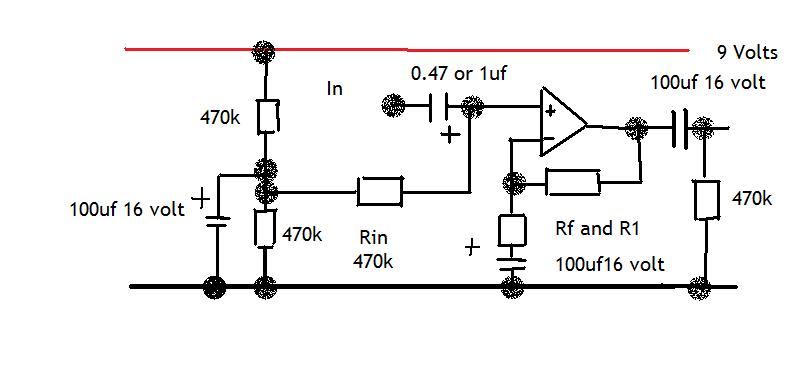

I've been playing around with this circuit and different op amps. I've decided I want to use the LME49720HA. I'm having problems with DC in the output. With the gain cranked I've got over 1V of DC. You can watch the woofer suck in as I turn the volume up.
I found this great article on op amp problems Working with Cranky Op-Amps and it sounds like I may need to balance my input bias current. I understand the equations he states to do this but I'm not sure how the 25K pot effects all this.
Right now I have a 25K log pot in line with a 1.2K resistor for R1 on the circuit in post #37
RF is 22k and Rin is 470k
Does the 25k pot with the 1.2K resistor make a value of 26.2k for R1?
Any help sorting out this DC problem would be great. Thanks

Couple of points.
First you are using a bjt opamp so as the circuit stands what you observe is to be expected. A FET opamp would not do this... that's why I specified them.
To minimise the problem if you want to use the LME then you must AC couple the feedback return, which is the R1. RF and Rin should be equal... which again is a problem if you want to keep Rin at 470K.
Try the cap and see what that brings the offset down too.
The pot and resistor give a maximum of 26.2K and a minimum of 1.2K.

Thanks Mooly and Andrew!
Andrew, I get your point. I've moved on to a Not So Simple Stereo Gain Stage. I built two of these circuits so I think I'll go back to a fet chip on one and put it in use. The other one I think I'll continue to use as my learning tool.
Mooly, I did recognize that you specified a FET op amp and Now I see why. You're right, the opa2604 does not have this problem.
So to Ac couple R1 i use the cap in parallel with the pot/1.3k resistor?
Would you use an electrolytic or a film? --edit-- Just looked at Mouser, doesn't look like films an option for that big of cap. I'll use a Panasonic elec.
Once again thank you two for the time and education. Scott
