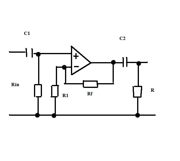

I'm in the process of putting together a system with a Audio Sector Gainclone kit and a Pass Labs B1 input buffer. My main sources are a phono pre and a CD player. I will also have a mini jack input for my ipod or computer output for streaming audio such as Rhapsody or Pandora. Both my ipod and computer have a pretty low output. I want to be able to match the gain on that input to the level of the CD player which has nice output and the phono pre that has a gain control. I'd like to have all the levels equal before they go through the selector switch and then into the B1.
Is there a simple gain stage circuit with a pot that I can run the ipod/computer through to give it a little boost to match the rest of the sources?

Easiest solution is a simple opamp gain stage... do you know how to configure one ?

Thanks Mooly! I thought that might be it.
I have no idea how to configure one, I've just started learning about electronics and DIY audio. Any help would be greatly appreciated.

Here's the normal circuit...
The input impedance is set by Rin, so a normal value would be say 470k. That give a high input impedance that won't load any source you connect.
The gain is given by the formula Rf + R1 / R1.
So using standard values if RF were 22k and R1 were 10k the voltage gain is 3.2
What gain do you need... the only realistic way to find out is to use a pot for R1 and see. Then select a fixed resistor to fit in it's place (preset pots are horrible in audio circuits )
The two caps... are good practice C1 certainly.
C2... I would say yes. The output of the opamp will be at zero volts DC... but again it's good practice to include it, however if the opamp is already feeding an AC coupled circuit then omit. The resistor R2 just defines the end of the cap to ground (100k).

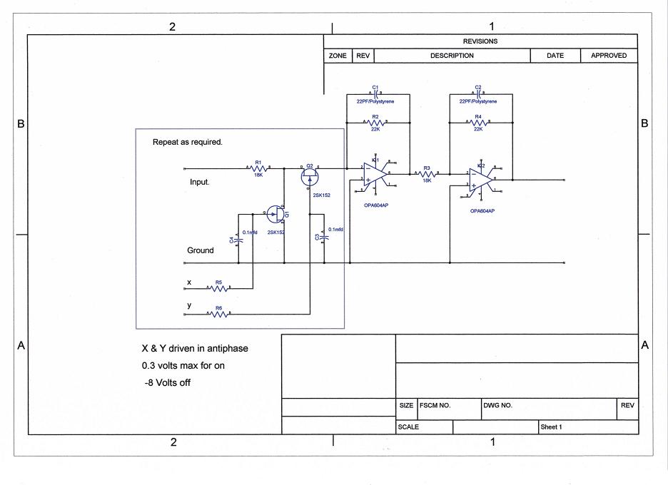

Another thought is to use the virtual earth configuration.
Have a look at this, which is the circuit I designed for my amp. Forget the FET's which are for electronic input selection.
R1 sets the input impedance. The gain of the opamp stage is just -R2/R1 (- because it inverts). The second stage inverts it back again.
This configuration is a "mixer" and each input has it's own R1 which allows each input to have it's level set to what is required. Different value of R1 for each input.

Is that a single 18 volt rail ? In other words ground and +18 volts ?
If so, it's no problem...
Yes, just an 18 volt wall wart.
I'll redraw it for a single rail... now you can make this as simple or complex as you like, but for a single gain stage we'll keep it simple.
Thanks! simple is good for me at this point.
You need two "opamps" one for left one for right.
Opamps come in singles such as a TL071, duals, such as a TL072, or quads, such as a TL074.
I would suggest a dual, and on this forum wouldn't dare suggest any particular one
But you need something to use, and the TL072 is cheap, very good, and easy to work with. Use a socket and you can try others at will. Personally I prefer the OPA2604, but lets not go onto opamps and their merits.
