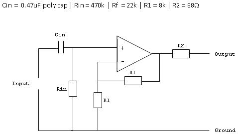

One thing about the OPA2604 and using a pot. As I have shown it the gain is variable over wide limits and as the pot resistance is reduced, the gain increases, with no limit, until at zero resistance, the DC stability of the circuit would be lost and the output would swing to one of the rails, which isn't good practice really.
If you really want a pot on the front panel of the amp it probably makes sense to limit it's action by adding a resistor in series with it so that the minimum resistance of the network is always say 4K7 for example.

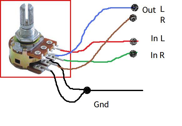

no the output of the opamp goes to the in pin of the volume pot.the IN leads got to the - ins on the opamp?
I think my understanding of this has got me confused.Rf and the pot. I have kept the pot in the "earthy" end of the circuit to minimize stray pickup
How about this.no the output of the opamp goes to the in pin of the volume pot.
The opamp + output goes to the in pin on the pot
The out pin on the pot goes to the + pin on the rca out
Two main choices,
fig 1 avoids the problem Andrew mentions. The load (your chip amp input) has no effect on the output of the opamp. The downside is that the opamp contributes noise, admitedly this can be very small, and not much more than just the pot on it's own, but there is the real possibility of extra hum and noise due to less than 100% perfect layout/shielding/grounding. Also the opamp needs a fraction of a second to stabilise at power up... and that is passed to the power amp unattenuated. Again not a problem with a foolproof power on delay on the output.
Fig 2 has the drawback that the wiper of the pot is "loaded" by the power amp input. If there's a small capacitance present it forms a low pass filter, the responsr of which alters as the pot is turned. In practice with a 10k pot the effect is minimal, I would have no worries connecting like this with a 10k pot. A 100k pot... no. Also the noise and switch on noises although still present are much attenuated as the control will normally be nowhere near full.

Ok, I have it hooked up using figure A so my inputs go through the pot and onto the opamp. It's powered up off the gainclone supply and seems to be working fine. But, the overall output seems a little lower than if I run the mp3 player straight into the gainclone. Do I need a different RF value?
I did have the pot wired up very wrong the first few times I tried the circuit. I heard all kinds of crazy noises and had over the top gain. Maybe I damaged the chip?
Draw what have done with the values... it's difficult just going off descriptions. Picture as well ? That should tell us why the gain is lower.
Unlikely to have damaged the IC... what IC are you using in the end ?
