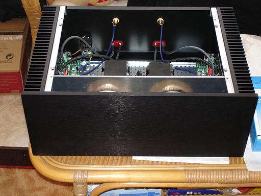

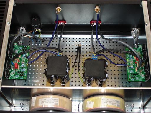

No noise...at last!!!
Finally, the amp is "dead quiet"!!! There is no noise and yes...it's the quietest amp I've ever built, and all these thanks to Greg's advices. I posted some photos of my final construction. The wiring was correct from the first time, so I guess there's something got to do with my previous layout. I want to thank Greg for his constant support...and the most amazing thing of all, is that he found what was wrong by only looking to a photo that I sent to him!!!
I strongly recommend the GB150D!!! Just built it and take a listen to it...this is one of the best amps I've ever heard;Greg is a great guy, he'd never got tired answering to my emails( and believe me, they were so many...more than 50)
Thanasis.

Hi msamkl
Excellent news :cool: Very nice layout :cool: What was the problem :att'n:

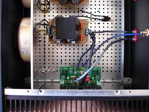

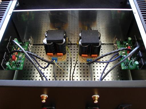

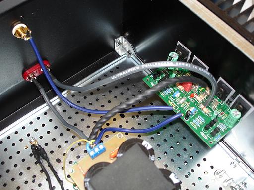

AndrewT said:
Hi Msamkl,
tell the cure/change that brought about silence.
I'm not sure, but I think that since the ground wiring was correct all the time, it had something to do with the distance between the amp's modules and the psus(in my previous layout, the psus were closer to the amp's modules). Also, I had the power supply wires from psu connected under the amp's modules. Greg, advised me to take the psus away from the amp's modules and connect the power supply wires on the upper side of the amp's modules. If you take a look to my first picture of the layout (post #135),you'll notice the differencies.

msamkl said:
Nice rig msamkl! :cool:
I like the power trannies in their own compartment.
Terry
