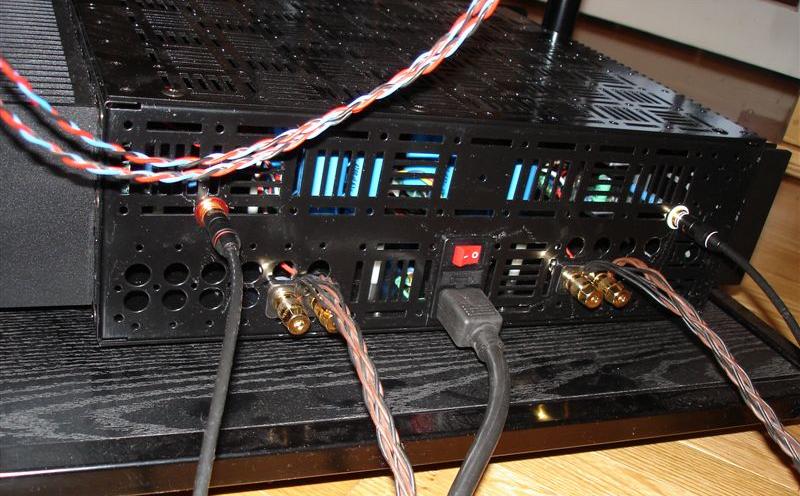

GB150D finished and playing
SKA GB150D finisished, view from the back. Vampire rca connectors with dyi belden 89259 cable (Jon Risch) Vampire connectors, Cardas CCGG binding posts (Sonic Craft), Volex power cord (Carlton-Bates) all mounted in a designbuildlisten chassis. I've left the back in a fairly "industrial" condition - not visible from the front in any case - doesn't seem to affect the sound :)

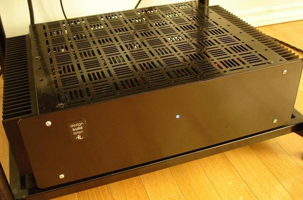

GB150 completed - front view
Listening to Jazz at the Pawnshop last night was so impressed how this amp has made my old Celestion SL6s's come alive and sound so effortless. Switched to Emma Kirkby and The Academy of Ancient Music rendering of Mozart's Exsultate Jubilate - clean, sweet, detailed, effortless Emma. All this coming out of an uncanny "black" hole silence. Still can hardly believe I'm getting this out of a diy project - not to mention the price of admission!

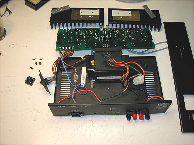

I've read messages for 2 hours but yet to see a simple description of the size of the PCB for this amp. Can someone please tell me it width and length and height (with FETs attached)? Thanks a bunch.
Also, does anyone have a guess as to whether the heat sink in the picture below is suitable for one channel? The heat sinks are 8" X 3" X 1 3/4" and used on a 65 watt per channel Hafler 9180 amp. The main board on this amp is badly damaged so I thought to replace it with a pair of SKA amps. Any guesses?

Thanks for the guess on the heat sinks.
Statements about the SKA being a more efficient circuit made me think smaller heat sinks might be OK.
The transformer in the picture is the International version and can be set for either around 58 ±VDC or 29 ±VDC.
This amp at this lower voltage will still play quite well, won't it?
But, what is the size of its PCB?
The GB150 is efficient with the rail voltage, considering the use of vertical mosfets.
For 50W/8 you need a bit over 1.75 Amp bias, at the exact current for 50 watts you're in the non-linear crossover zone.
Mr Ball advices less than +/-32 volts(unloaded).
I've got a heapload of dual secondary 25 Vac toroids, so i'm running it a wee higher.
For class A use Mr Ball prescribes a heatsink under 0.4 C/W, IMO that will give a very hot running amp. Lower than 0.3 C/W is much better, either a BIG heatsink or one with a vent.
Hi Dick,
those 8x3inch sinks should easily cope with a GB150 for domestic duty.
In classAB the Pq is quite low for this amp and the sink temperature will be very low (I would guess less than 6degC above ambient temperature). The sink has to dissipate about 60% of output power in addition to Pq, so for domestic duty the average power levels for conventional SPLs will be at least 20db below maximum and probably 30db below. Louder music power levels will average 10 to 20db below maximum, otherwise clipping on peak levels will occur. Peak dissipation will only happen for short period music peaks and thermal inertia of the heatsink will easily cope with this.
I would wire up one amp block to your proposed heatsink and run it pretty hard, monitoring maximum temperatures and from that information make the decision on whether one 8inch sink could cool two GB150 amps.

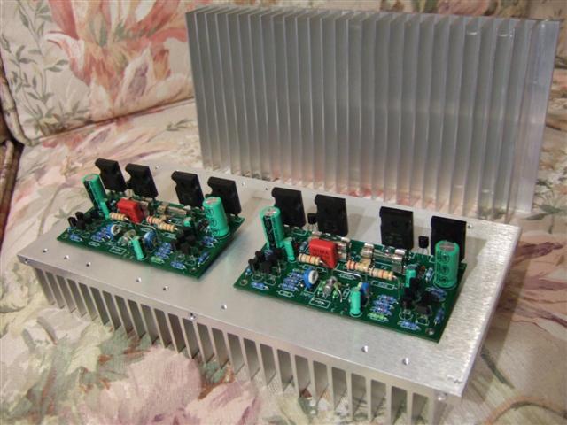

GB150 monos almost ready
I finally found bit time to amp. building.
I have 4 monoblocks in progress. First pair is ready for testing. If everything goes well, i hope to get some sound from them in weekend..
Wiring is still bit messy. Transformer is quite near module.Do you think that something can be improved if i put metal box around transformer?
I made "service door" under the module, so service/tweaking is easy without need to unfasten anything.
Some minor "tweaks" are done: Trimmers are replaced to multiturn cermets, 330uf caps are bypassed with 0,1uF PP:s, some critical resistors are made from 3 paralled (2 soldered under PCB) to improve temp coefficient.

Re: GB150 monos almost ready
Hi Pasi P
Sounds terrific ... look forward to reading about the results :)
Wrsto the metal box around transformer, A farraday box/cage would be better! A way to achieve this is to use Aluminium flyscreen ... cut it and fold into a box shape around the transformer. Make sure you scrape of the protective coating on the Aluminium flyscreen when grounding it to the chasis. Also, make sure that the chassis is grounded to the earth pin of the AC connection.
