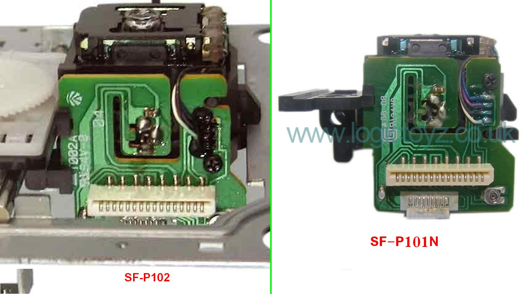

I found such info but can't confirm
Could be used, but some modifications need to be made - from what I see optical connector is reversed. So, this SF-P102 is not a direct replacement in Shiga MKII or original JVC.
Tibi

In PHILIPS MCM8/22 pickups SF-P102 and SF-P101N can replace
as russian forum confirms.So they are after all similar in point of pin to pin view.
According to your previous post http://www.diyaudio.com/forums/digi...kii-black-builders-thread-76.html#post4023642 , ribbon cable may need to be reversed ... but this is only a guess as I never seen SF-P102.
Anyhow, thanks for this info.
Tibi
