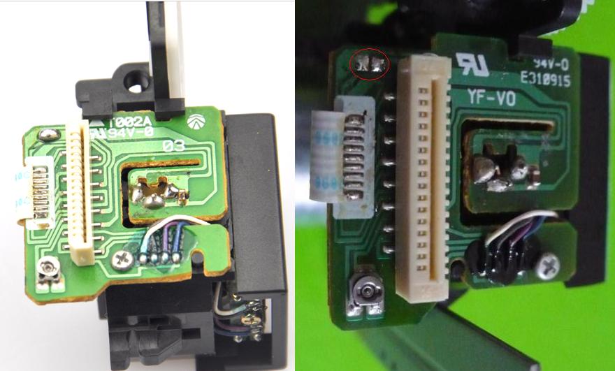

Hi Dimitri,
I am getting ready to mod my gold ribbon version of the Sanyo mech which I know you have done. I used the recommended caps on the standard mech I have done but as I remember you did something a little different since the ribbon space was so demanding. I have been searching thread but I can't find. I thought you used silver mica's for both XR5's, do you have any documentation as to which value went to which pads? Thanks for any insight! I have just done mods to mechanics so far as I am working on Peter Daniels TDA1543 DAC which I am putting the finishing touches on now and next move to full time work on transport!!
