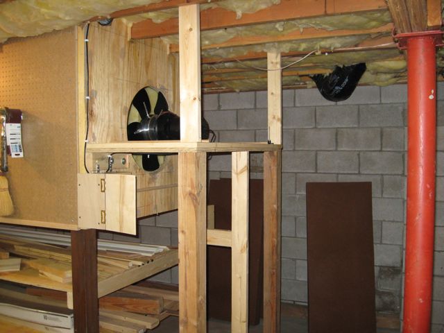

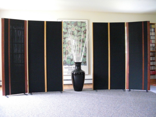

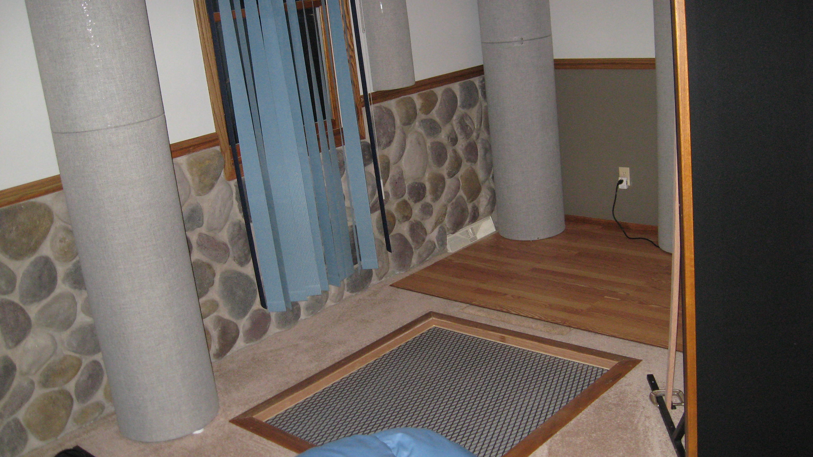

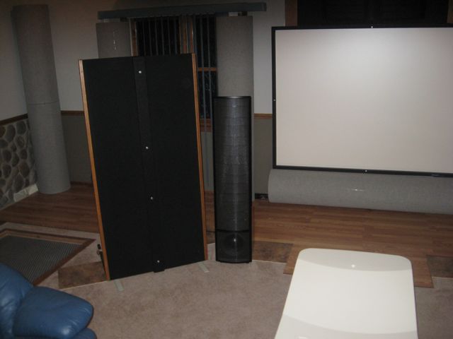

Magneplanar Tympani IV bass panels with Rotary
For extending the response of Magneplanar Tympani bass below 25 hz,
a rotary subwoofer is the answer. A rotary subwoofer is both efficient
and is capable of reproducing infra bass to 1 hz! I have used a rotary
subwoofer for 4 years with Magneplanar Tympani bass panels and the
results are stunning. Transient response, coherency, and efficiency with
all the power one could ever ask for.
