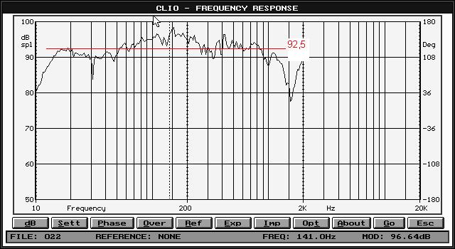

Hi
What i see is :
1- an increase from 310 up to 150 Hz (~12dB/oct)
2- a decrease from 150 down to 30 Hz (~6dB/oct)
3- an increase from 30 up to 18Hz (~6dB/oct)
4- a decrease from 18Hz down to 10 (~24dB/oct)
Feel free to believe it confirms the "well established" roll-off prediction.
It's my turn to be not convinced, particularly because of the same value of spl at the beginning, the center, and the end of the domain you chose for your observation : for 310Hz the curve is at 90dB, and too for 30 Hz, and too for 15 Hz.
The average SPL line drawn by Infraplanar is horizontal, not declining towards the infrabass.
Measures confirm : 92.5 dB for : ~18Hz, ~53Hz, ~260Hz, ~350Hz to 850Hz. And a small elevation of 2.5 to 5 dB between70 to 220Hz.
Not too bad for me.

If I can (Yes I can), I profit of this curve to mention that Infraplanar present the other advantage to cover from infrabass to almost 1000 Hz. It's not so often with other classical subwoofers...
That permits to have a very large zone of superposition with any planar, so that it is possible to find the best cut frequency to relieve planar of the burden to produce bass notes.
Each time you can upper the cut frequency, you can observe that your planar benefit of a real gain in richer, clearer, smarter sound for the smaller domain of sounds it has now to produce.
This a very comfortable & convient advantage when you have to re-equilibrate your system after adding a sub.

Anyway, this 6dB per octave roll-off, if real, could
very easily be "equalizable" with DEQ2496, or others.
Nothing easy about it as the rolloff is baffle loss, for ever increasing
excursion as you drop in frequency for normal response. Add in EQ
and the excursion becomes a serious problem at low frequencies.
Don't tout yourself as an expert on something you don't understand.
It is real, it is inevitable, and it makes planar a very poor choice for
ultra low bass, to the extent it is essentially practically unworkable.
rgds, sreten.

What i hardly understand is a scientific that do not believe in a response curve.
The issue is what you measured- near field and in open space.
And yes, I've heard large planar systems.
