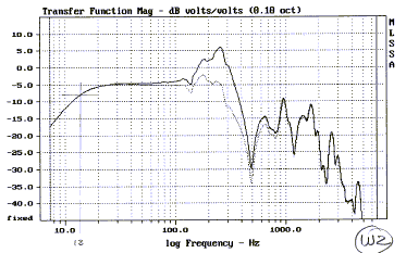

The fact remains though, if you take a nearfield meaurement of a dipole loudspeaker you will not see the 6dB/octave roll off that they will show in the farfield.
Here is an image of LW doing just that and are we going to say that this configuration has extension down to ~20Hz? Of course not, because it does not, unless of course you're going to listen to it with you ear pressed up to the opening of the baffle.
Once you start measuring in the farfield you end up seeing the expected roll off as LW does here.
There's no magic to this, except that to get accurate data down this low needs a complicated outdoor arrangement where you end up lifting the loudspeaker far off the floor to remove any unwanted reflections. Note that you still see the roll off when there is no room interaction, reflections are not needed, nor are they the cause of the roll off, but when added in, just like if you start letting reflections in with a normal gated farfield measurement, they end up marring the accuracy of your results.
In other words here, if the planar loudspeaker that this thread was created around, was measured using a nearfield measurement, then this cannot in any way be used as a reference for what will happen when you actually listen to it in the farfield. Now nearfield measurements are the norm when wanting to see what the overall extension of a monopole loudspeaker will be like, but this does not translate to a dipole.
