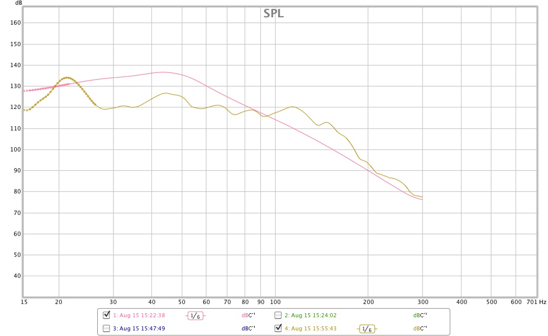

Here's a little somethin' for those who believe the theory that proves the bee can't fly. Measurements I took a few minutes ago.
The smooth line is the drive voltage to my giant OB (yes, it is equalized and crossed-over, don't ask). The other is a REW curve using a Radio Shack meter (the calibration boosts the low bass output a small amount) about where my ears are when listening to music in a heavily carpeted room about 10x16x8 feet. 1/6 octave smoothing (which isn't hiding any secrets really). The ancient Stephens woofer has a free-air resonance around 20 or so.
The giant OB is kind of funny shaped. But if any waves wanted to sneak around from the back, the shortest path would be just 30 inches to the meeting place. No kidding. Longest path maybe 60 inches to the common meeting (or 100 Hz cut-off).
15-300 Hz. dBc scale is 10 per box. No fudging around with mic positioning... first curve (after doing a fair amount of test due-diligence).
Looks pretty good to me and maybe to others who have the nerve to publish their real-world results as I am doing. Umm, big roll-off below 20 Hz. Must be that phase cancellation stuff catching up with me. Just kidding, we all know another reason it is rolling off there.

If it is equalized, your only proving the "pro physical laws" position. The original argument in this thread was that it could be done(10 hz?? Sheesh!) without EQ and with "normal" efficiency(What is normal efficiency? Equal to the mains efficiency at 1 khz, and measured at the listening position, with the same amount of wattage going to both..) In fact, a mono sub would need to be 3db more efficient than each individual mains, because the mains are doing bass at the cutoff point in tandem ..
It can be done without EQ, though, if the woofers have a very high Q and a low resonance frequency- in a box and in a nearfield measurement, the peaked bass is evident. See the Bob Carver speakers for an excellent commercial implementation. Whether through EQ or high Q, the issue still is the tradeoff between extension and efficiency/displacement (read: distortion). But this is irrelevant to the claim of using "reflections" from the room to make up for the inherent comb filtering and cancellation at longer wavelengths, which is utter nonsense.
If it is equalized, your only proving the "pro physical laws" position. The original argument in this thread was that it could be done(10 hz?? Sheesh!) without EQ and with "normal" efficiency (at the listening position)..
How many times do I have to repeat that I have no problem with the principles of acoustics? Why are you implying I am a moron or a fool? Do you think I practiced voodoo when I worked at Bell Labs, Murray Hill?
I only argue that the analysis of open baffles in real-world rooms is naive.
Do you want me to say it one more time?
In places the equalization bears a loose resemblance to the well-known suggestion of Linkwitz. In other places, not. In some places, I bet you could eyeball an XdB/8ave drop in speaker output and in other places... a rise.
The net result seems to be not so bad, given the widespread expectation that open baffle output go poof at the half-wave dimension and everywhere south.

I thought that Toole put the notion that anybody can hear comb filtering to rest, as best as I can recall. Engineers love to talk about comb filtering because it is so compelling from a math standpoint even if a non-starter from a hearing point of view.
Can you point to those comb filtering artifacts in my chart? Or could it be that the hypothetical room reflections are really doing a great job masking the hypothetical comb filter faults? And if that is true, then we are back to my point that the "bad rap" OB get from naive theorizing is excessive.

With smoothing, comb filtering doesn't show up in the measurement, but the lumpiness in your curve is suggestive. The room reflections aren't helping, they're one of the root causes!

Naturally, anyone would want to be prudent in disagreeing with Sy. So, until I get the energy to "drill down" with the curves some more, I'd just say there are always dips and peaks and they always look comb-like. I like 1/6 smoothing as my favorite compromise and as I said, it hides nothing important here.
With any kind of theorizing for practical design purposes, always a choice how deep you want to go. I don't think there is much value in taking a model of a circular baffle (or any other mathematically tractable surface), put a point-like source in the middle... and then try to generalize to an odd-shaped OB in a room at an angle to the walls.
Can we agree to disagree on just where it is productive to draw that line?
