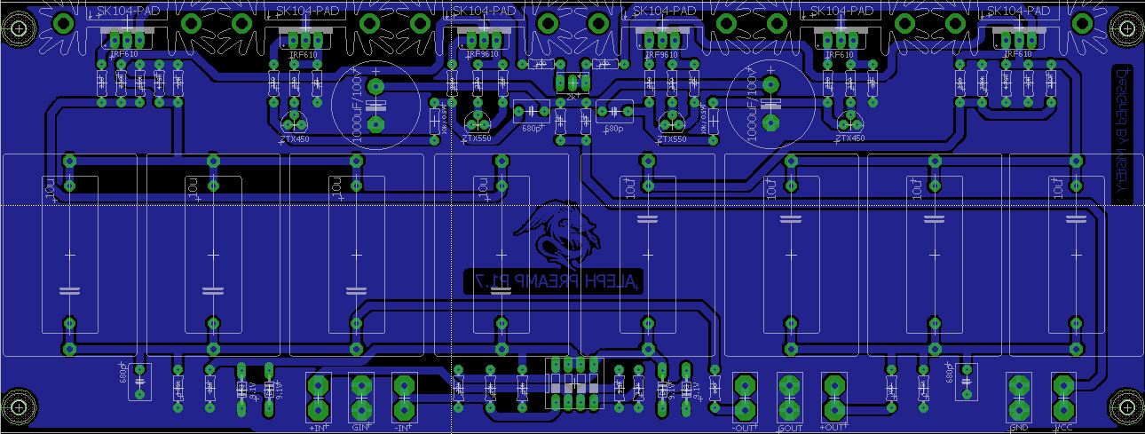

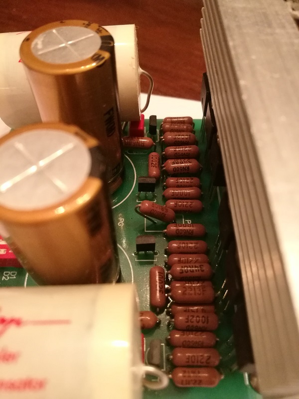

Hi
Anyone familiar with this PCB?
I'd like to know a smart option for volume control and the correct use of VR1 2K and VR2, VR3 50R.
I will use it balanced after DAC so only one input.
Thank you!

boredom to look for bucket pics

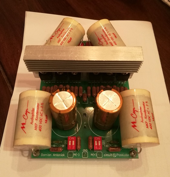

anyway , 2K trimpot is definitelly for gain tweaking , while (by value) 50R trimpots are definitely for fine tuning of Iq , left and right side
take proper pictures of trimpot area , so we can see few resistors around, to give you some guidelines how to set it
any other text info , besides Pass P1.7 ?
vol pot - same as in original schematic , on output
I would use 4k7 log pot there ........ 10K max.

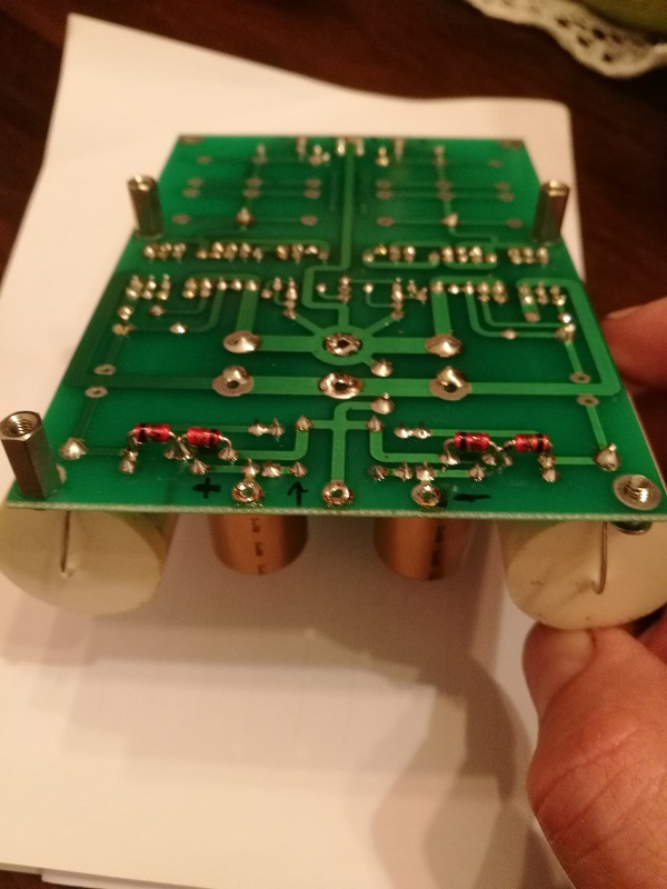

give me exactly same angle, but underside of that last one picture (showing 50R trimpot)
be sure that (LQ2) mosfet pins are also visible

The 50 ohm pots look like they could be in the upper 30ma current source circuit. They may be for adjusting the current which will also adjusts the DC output bias on the output. You could easily check this with measurements. There really aren't that many spots in the circuit where a low 50 ohm pot value makes sense.
I'm asking to see traces , to be able to tell where exactly to measure , while setting with trimpots
Thank you!
set trimpot to have 400 to 450mV across adjacent 22R resistor , and to have same reading on all 22R resistors
or , even better approach, set them (trimpots) to have approx. half of Vcc at inside sides of output caps ( at drains of input mosfets)

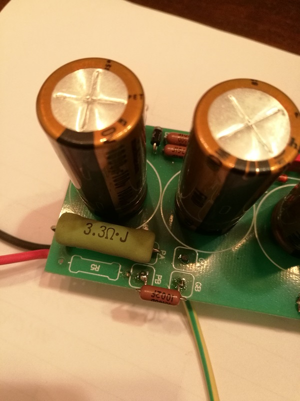

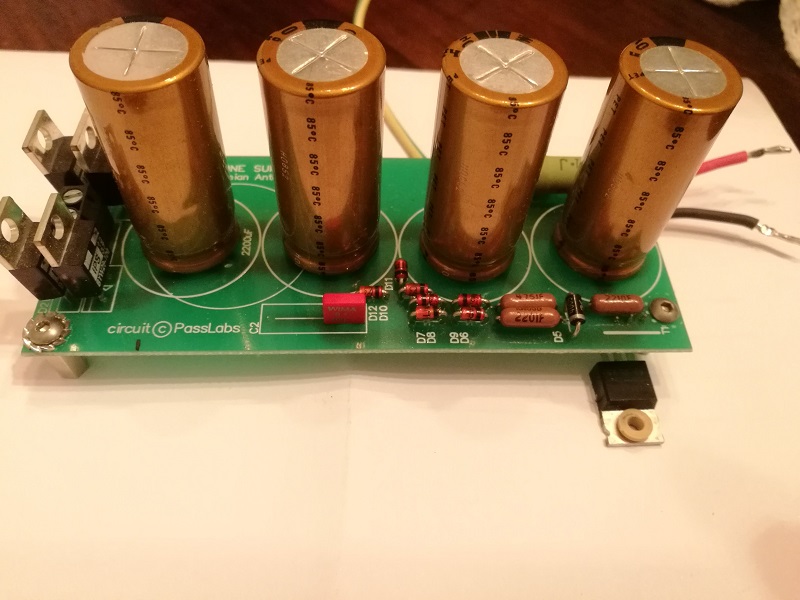

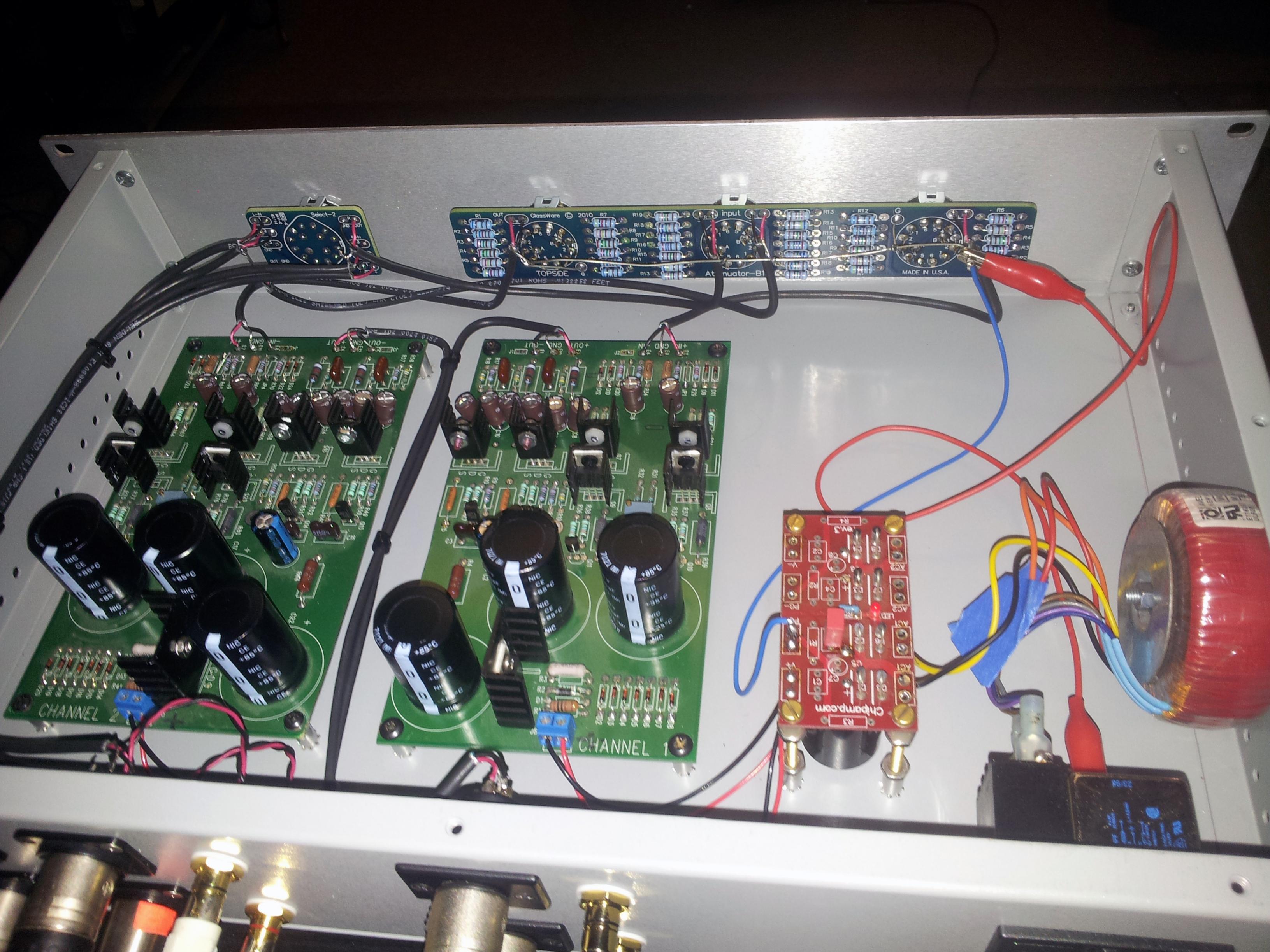

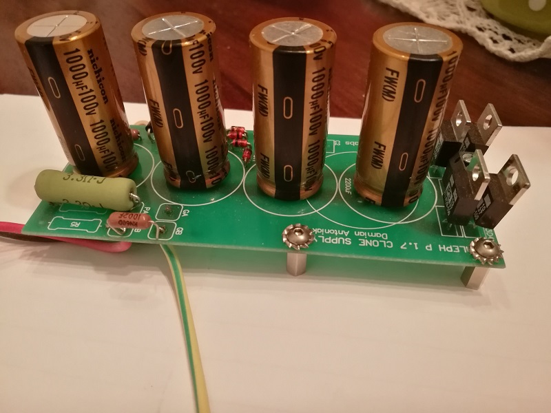

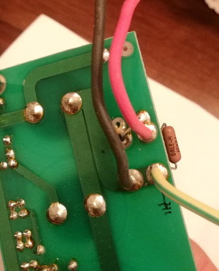

Hi there,
this was most recent topic/post regarding aleph p1.7, so instead of opening a new topic I choose to continue this one..
Anyway, thanks to local diy audio member, I acquired disassembled aleph p1.7 (not literally, just PCB's are not connected).
Preamp was working, it was just replaced with valve preamplifier, and box/case reused.
So before connecting it all together, any hint, advice, measurements?
And yes, I am missing (sort of, it was diy project which need more attention than rest of preamp) volume control, and finding some 4 track locally is a challenge, I may be forced to put 2 stereo pots.
If I understand correctly, I need some lower value, ie 2k or 5k?
Also, there are some "things" on preamp boards needing attention (like instead of trimmer there is fixed resistor, previous owner sad he did it the right way (once adjusted he replaced trimmer with resistor).
Some photos enclosed (I have lowered resolution, but have hi-res is someone needs it.
Thanks!

I see ...... fixation on original parts - Dales and ZTX
always funny , when European guys are in question
regarding pot - some prefer to use pot where Papa put it (was it 5K on output ?), some prefer to install regular valued pot (25Klog , for instance) in more common position - preceding preamp stage
if you pount me to exact schmtc (on which pcbs are based) , I can tell you what's important to check
I used the Glassware Select 2 input selector and balanced stepped attenuator. They are good sounding, come with decent resistors and are quite inexpensive. I am pretty sure I put mine on the input side, my speakers are low efficiency and the 1.7 boards are dead quiet.
