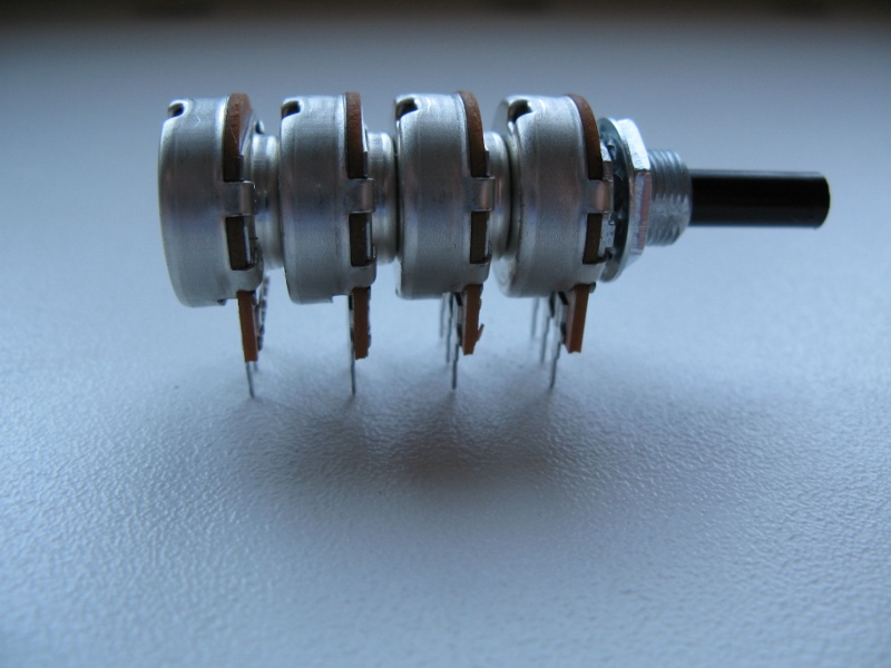

I will do a test with 2.2k pot. 4 gang at the output.
Just curious where you found this pot? I don't think I've seen one with
resistance that low.
Thanks,
Dennis
It was special made by company Omega limited.
They were not too happy for small orders.
Omeg Products
Omeg Products
A Dutch surplus webshop has different pots in stock, down to 1k.

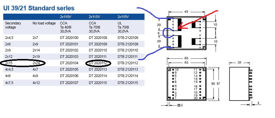

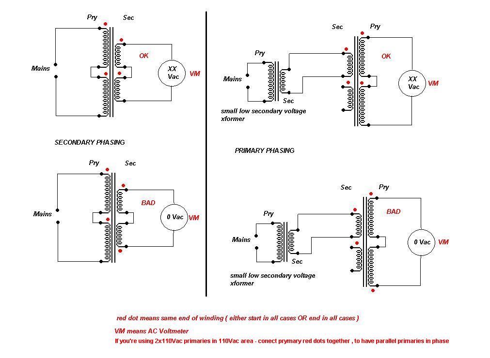

I have started putting things together so that I will have a nice pre amp but today when I should put the transformers to their first test I experienced something strange.
Ok, I have two separate transformers for the Aleph P1.7 boards and those seem to work just fine leaving me with 63.2 and 63.4 Volt respectively. So far so good!
I also have a Dantrafo 2020112 that is supposed to leave me 2 x 15 Volt on the secondary to run the relays on both the Aleph P1.7 and signal board and volume control. It is built with a primary side consisting of 2 x 115 Volt that I understand should be hooked up as the picture is showing.
Here is the problem, when I connect it the fuse blows with a nice little flash, phuff!
I checked all cables and they are correct, and when I check for continuity from upper blue cable to lower blue cable in the picture I should receive a signal but it is dead quite, no sound not even a bip.
I think that my primary side is gone bye bye! Am I right?

It turns out that Dantrafo don't connect their trafo the way you generally do but connect incoming AC to 1 and 6 and you put jumper on 5 to 10. Apperantly the bugger is sensitive to directions so I will check later this evening if it still is alive otherwise I have to get a new one on monday.
