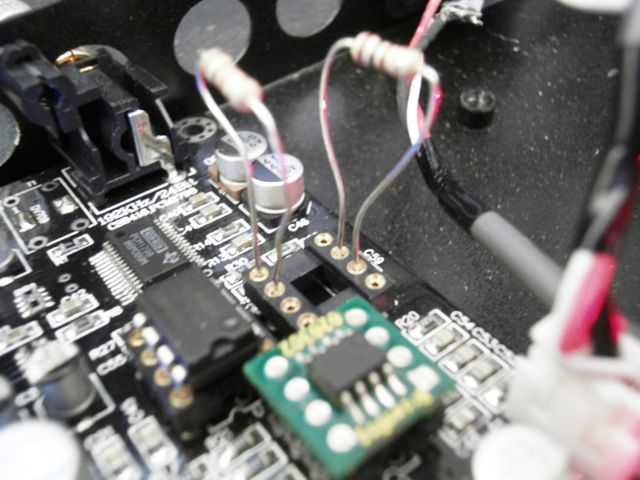

measure the AC voltages across pins 2 and 3, and across 5 and 6. If you don't get a clear result, do the same on the right op-amp (U12) to compare.
Thank you, Highfieldrebel, i very much appreciate your help.
I first measured wild variances, but then decided to burn a 1k tone cd from a .wav file off the web and played that into the DAC via coax.
I now measure a very steady .082v across 2/3 and 5/6 with the 100ohm resistor (probes on each leg of the resistor, not from pins to ground). My DMM reads exactly the same on both U11 and U12 on both 2/3 and 5/6.
Is that good? :eek:

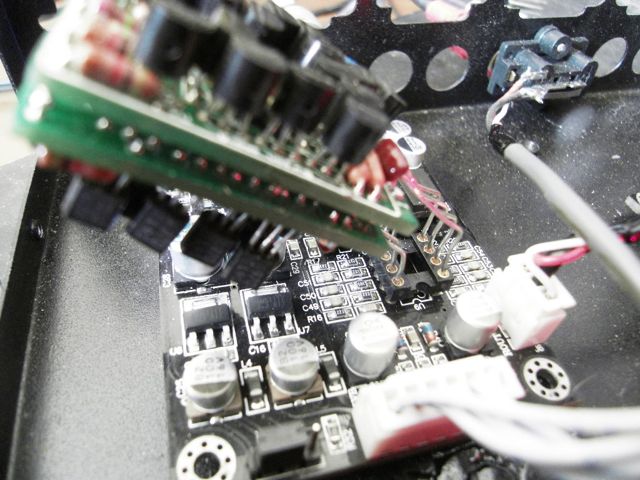

I messed up. After tracing things down (per your helpful suggestions), everything up to the final opamp sockets seemed fine... what happened was i had loose socket holes resulting from stuffing the fatter Burson op amp legs in, then removing it to substitute another to try to diagnose the gain distortion i was getting. I flipped and fried the substitute, then was afraid to put the (expensive) Burson back in so i was using regular skinny-legged dual opamps which didn't make contact on the Rt channel legs. Oy vey. All is fine now with the Burson back in, thankfully. Doh!
I still have what i believe to be too hot an output level for my preamp, resulting in that familiar over-driven distortion clipping on louder musical passages, like you'd hear if you pegged the meters on your old cassette deck. Is there a way to attenuate the signal somewhere before or after the Burson to make my preamp happy? With my ripped 1k tone which shows +3db in DAW (LogicPro), i measure 1.45v Left and 1.43v on the Right outputs. I get about half that on most CDs, but say on louder passages of Regina Spector's "Begin to Hope" I hear distortion on loud passages and DMM reads over 1.0volts during those. That's too much output, no?
Thanks in advance.
Hi Mootzeroni
that's excellent news, and I'm amazed at the size of the Burson. If you press ahead with transformer outs, you can compare the two. A quick look at ebay suggests they're similarly priced?
The analogue chain now has two op-amps in series, is it helpful to upgrade one rather than the other?
Re your saturation issue, I'm using the DAC instead of a preamp, I'm doing source selection on the digital side and I have a stereo pot between the DAC out and power amp in. This leaves me with an unresolved remote control issue, but that's for another day's bodging. If you will retain your pre-amp, I don't see an issue with putting a resistor divider in the DAC box ........ does anyone know better?

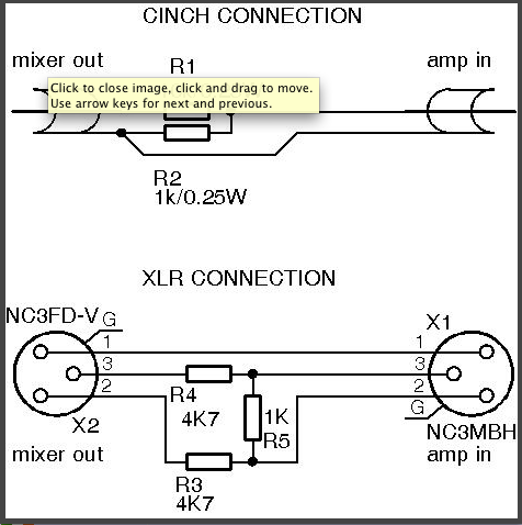

I tried simply adding a 100ohm resistors as a shunt(?) between the RCA terminals, hot and ground, right at the back of the RCA connector. This has reduced the distortion on the loud passages dramatically. Is this bad for the DAC or expensive op amps? Is there a better way, like biasing the op amps? Should i use a series and shunt to ground instead? My integrated amp has 47ohm impedance, fwiw.

I think the input impedance of your amp is more likely 47 kOhm.
What I think is happening is that you are drawing so much current with the 100 Ohm load, that a significant amount of the DAC voltage is developed internally, and you are getting a voltage drop. This is not a good way to go, it guarantees distortion as the op-amp circuit output impedance will not be flat with frequency.
I suggest this: make a resistor divider with two large resistors, say 47 kOhm and 10 kOhm. Solder them together, put the free end of the 47 kOhm resistor to the DAC output, put the free end of the 10 kOhm resistor to the RCA ground, put the junction of the two resistors to the RCA centre conductor. The output voltage should drop by (10/(10+47)).

Ah, i get it... I think i saw this elsewhere...
http://www.diyaudio.com/forums/parts/90918-diy-line-attenuator.html
and as a product:
Attenuators
so the 47k resistor is in series and the 10k goes from the signal to ground (and same for the other channel). I just tried it with lower values (1.5k and 220ohm) and there is less distortion on the louder passages... i'll try larger values. Will 1/4watt resistors suffice? THANK YOU!!!

ideal resistor divider
Hi Mootzeroni
apologies, I lost the thread updates...
I've attached a sketch of an ideal divider (I hope it comes out, I've not tried this before)
Anyway, imagine a Vin (the output of the DAC) driving a current i through two resistors, i=Vin/(R1+R2). Then approximate that no current leaves the line Vout. This is nearly true if R2<< whatever we connect at Vout (your power amp), might be the case. The voltage across R2, which is Vout=R2*i, from before this makes Vout=R2*Vin/(R1+R2).
And that's it in the ideal case, more careful consideration will bring into the equation the capacitance of the cables, but let's not worry about this today.
To reply directly to your post: the 47k and the 10k are in series from the DAC output to ground. The 10k lies between RCA output and ground. And as Grael pointed out, power rating of the resistors is not a problem. Can't see a smilie that represents crossing your fingers the pdf comes through...
