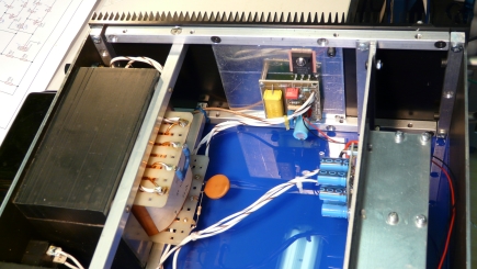

Lundahl did EI's ?
Footprint of the OPT looks like a Sowter, right bottom corner, hope Jan doesn't mind to posting the pic.

Judging by the pictures of the Nemesis on Jan's home page, the transformer he used is not a Tango.
Looks more like a one-off, only Jantheman can tell.
A substitute for the JP original would be in the $300 to $400 each range. (original is an FG50S, replacement could be a 65 Ohm primary Sowter SE14)
My transformers were original Nemesis as sold at the time by La Maison de L'Audiophile in Paris. AFAIK they were custom made when orders came in, largely handmade and the labelling at the terminals is also hand written.
It's a very heavy E-I core with of course an air gap which is required when you run DC through the primary. That airgap decreases L so you need more core and copper to bring L back up, that's why the thing get's pretty big and heavy for a 6-8W SESS.

ZM, for us staring from behind an Iron curtain, there must be someone locally who can wind such a tranny?
I think a good transformer guy should be able to do the design, based on the following:
- power handling 10-12 W
- turns ratio sqr root of (64/8) for prim 64 ohms, sec 8 ohms
- DC quiescent current about 1.3A
- lower freq resp say -3dB at 20 Hz, high freq response say -3dB at 20kHz.
