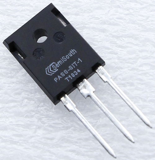

OK - I'm very interested in this. Thanks Nelson and Jan!
I never built the Nemesis but spent a good deal of quality time with Hiraga's build of the amp at the shop in Paris. Heavy booger! And it sounded very nice. Mono blocks, IIRC.
Now that we have a new article and new transistor, let's return to the transformer. What can be done about it? Bud P's remarks are discouraging, as he certainly knows his transformers. But transformers for this DID exist - I saw and heard them, Jan bought them and used them.
Could we approach Edcor for a design? They would charge $40 for the custom design, then transformer costs. If they are similar to the GXSE series then they'd be about $40 a piece for a 15W transformer.

Pano,
This transformer has a DC current of about 1A so needs an air gap which means a lot more iron than you think for 15W.
Lundahl informally quoted several times the price you mentioned.
Don't know what Elektraprint were asking.
jan

OK - the current is high so the gap needs to be bigger and thus the core needs to be bigger. Is that what you mean? So an EI core the size of the Edcor GXSE15-8-1.7K would not have good bass response at Nemesis powers?
What's the size of the transfos you have? Have you measured the primary inductance? That would be a huge help in building a new one.
Administrator
Joined 2004
Just had another read of the two original Nemesis articles from 1985. The transformer is a bit of a "cheat". It would have been 1H and weighed 50Kg if done full on. But a little bit of NFB saves the day and an OPT of 250mH primary inductance was used. The gap is 0.4mm. Weight was said to be 6Kg. I remembered it was heavy!
Very low DCR on primary and secondary windings.
