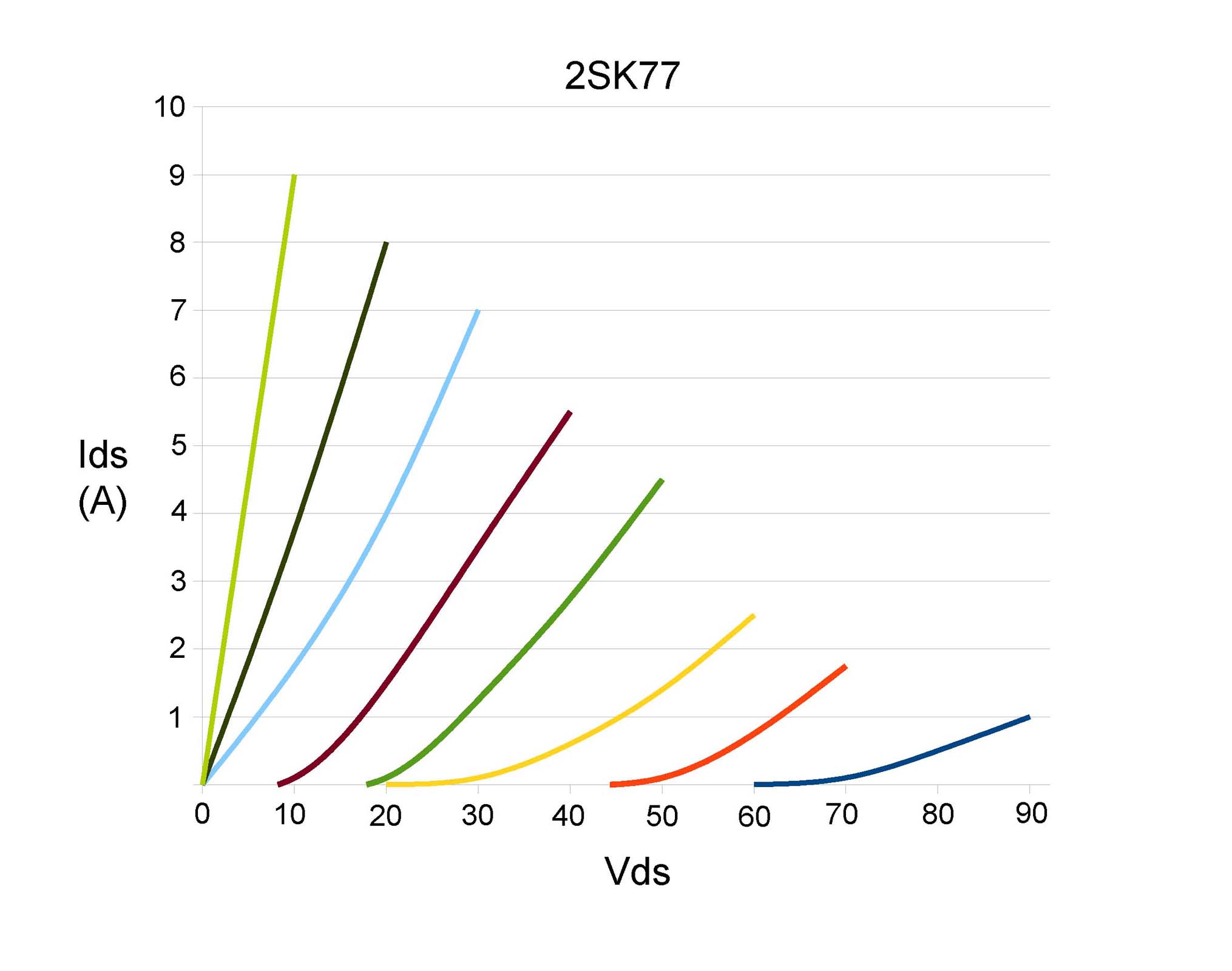

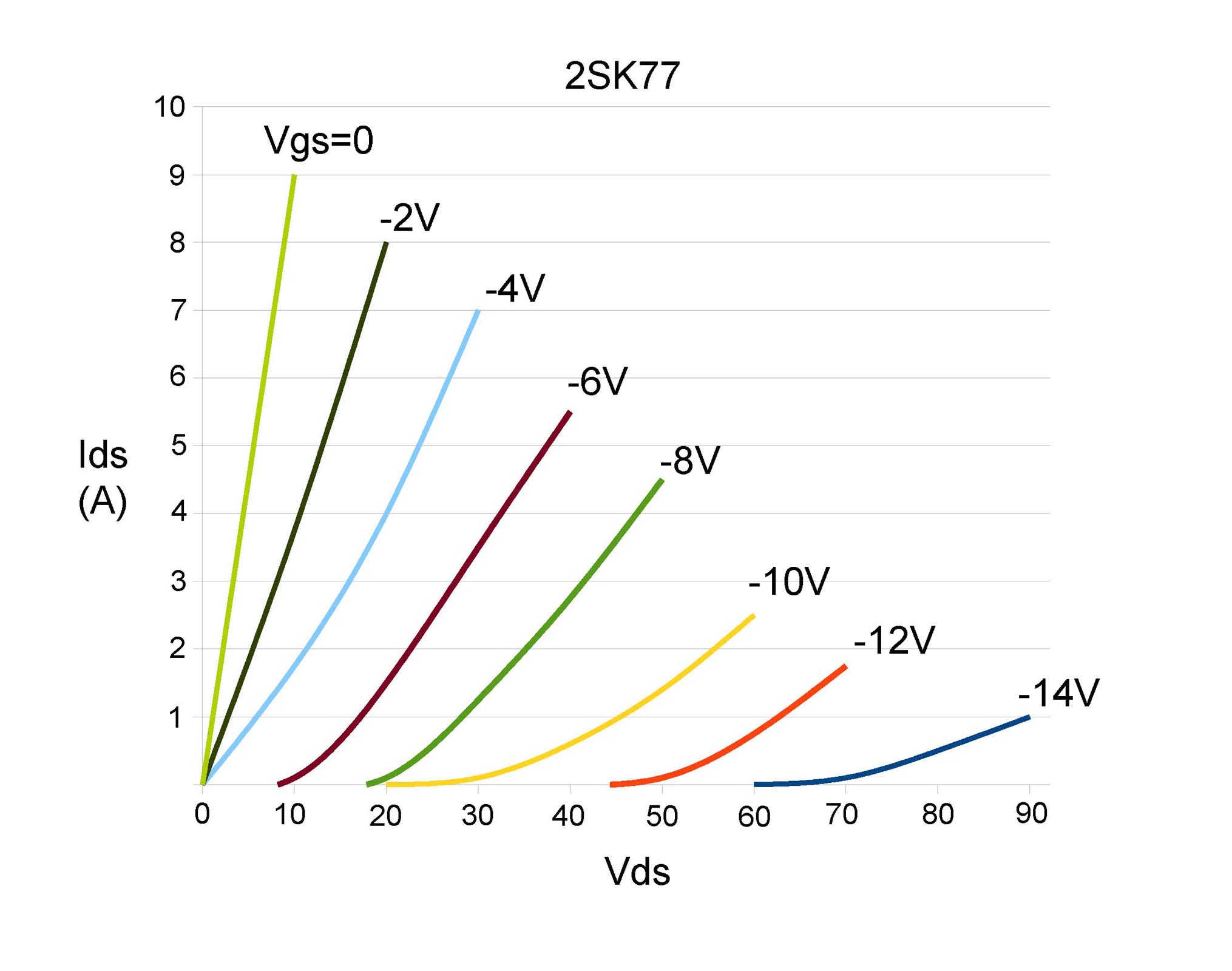

Easily done, But what would become of the loadline. More bias current always seems to be a major part of the sound of these devices. What effect would dropping this into the mA region have on final sound?
With SITs the load-line is the thing, otherwise you would pick a nice Mosfet
or Jfet and operate as if it were a pentode.
With SITs we see that the "mu" is relatively constant within a reasonable
range so that the voltage and current parameters (load-line) can be
optimized for a range of load values at a fixed wattage and not wander far
from the sweet spot. This character is dependent on the specific device.
I have tested my parts to 64 ohms (the Nemesis primary) and down to 2
ohms without the relationships falling apart. As the parts are not voltage
rated to replace a 300B, I am not expecting that they will practically drive
more than a 500 ohm load at 10 watts (for example).

Here's the Yamaha 2SK77
:cool:
