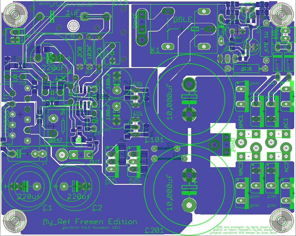

Hi Marce,
I've read all your links, some were known, others not... a very interesting reading

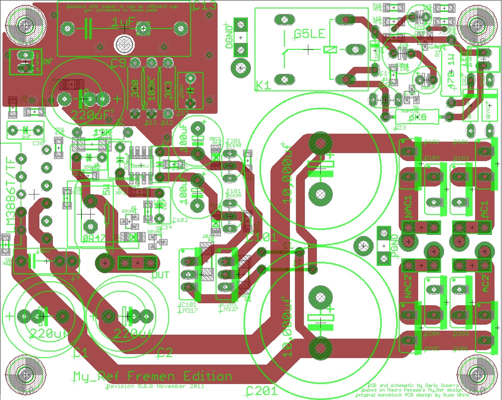

Basically the PCB is my effort to apply such suggestions but, since this is the first PCB that I design, I've a lot of doubts...
I've also took inspiration from various real world PCBs of audio gear from my service manuals collection...
I would appreciate very much if you can point me to something you consider critical on the PCB or suggest one or two improvements, in fact I've started the thread for this reason...

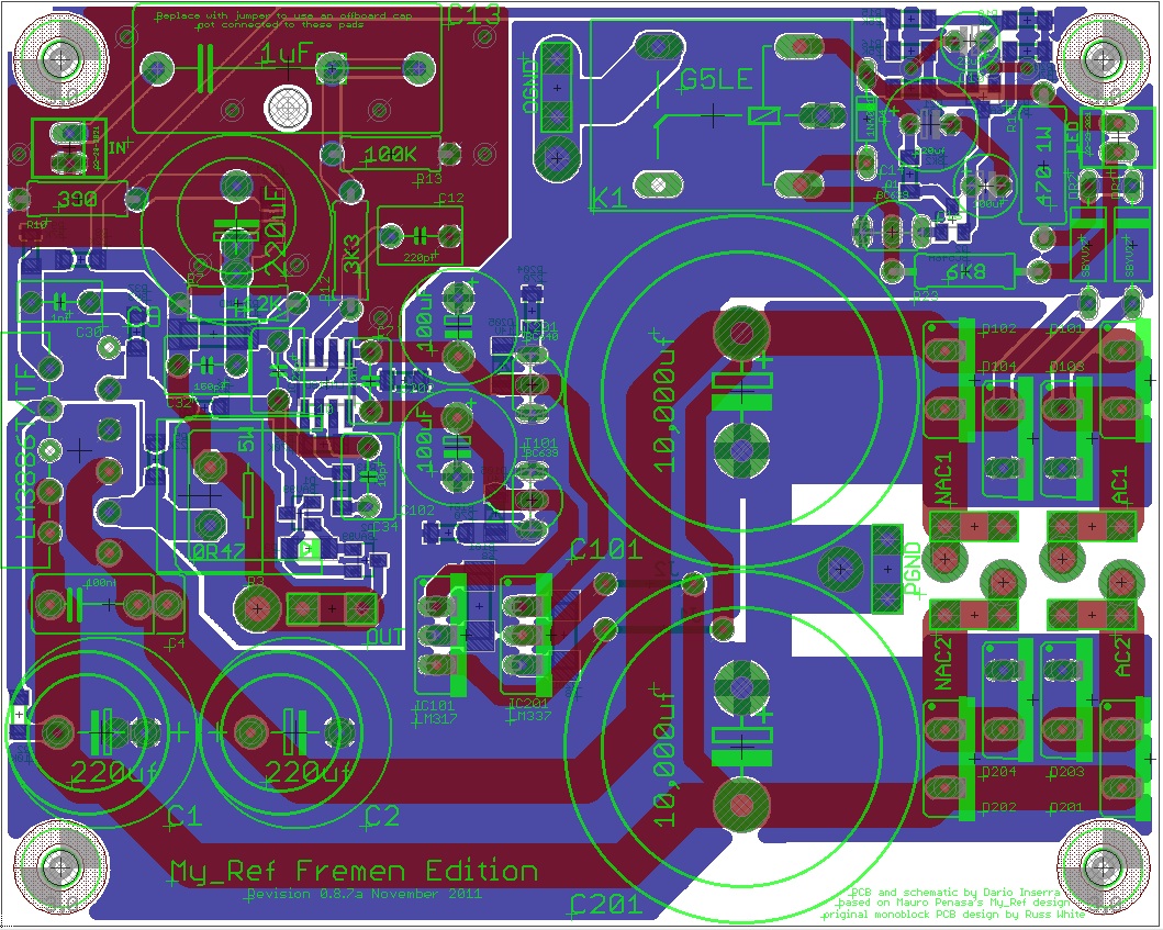

Marce,
maybe the attached design is a step forward?
Dear ClaveFremen,
I like the fact you consider a ground plane design. Thanks to the help of Marce on this forum and Henry Ott I succeed successfully in commercial designs to incorporate ground plane design for multichanel high and low current circuits all on the same board without any humm or noise whatsoever. My subjective opinion is that audio designs with good designed ground planes sound much better.
If you want to do it really good, I advice you to raise the cost a bit and go for a 4 layer PCB. Make layer 2 a unbroken ground plane.
The problem with 2 layer designs and ground planes is, That the plane is broken on many places. The return current above certain frequencies want to follow the path of least inductance. Broken ground planes can block those routes.
If you see the circuit as a shower and a drain and visualize it that way, you can actually control big and small currents better then one might think. It is all about discipline of circuit and component placing. Close all current loops individually and make sure the low current circuits aren't in the loop of the high current circuits. Shower and drain....

Generally we don't want returns too much in parallel with it's signal trace if the currents and voltage variation is above a certain levels, unless they might exactly cancel out.
I've attached the Eagle files, so, if you want, you can have a more 'inside' look...

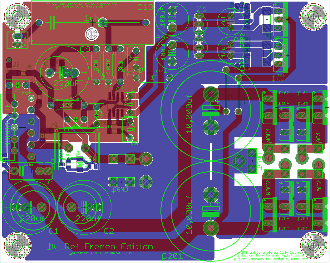

I've made a new revision trying to follow your suggestions, you'll find it attached.
Any opinion is welcome.

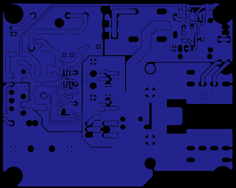

See the attached top and bottom PCB traces, to me the top 0V and GND planes seems good.
The bottom 0V and the GND planes are there just to better isolate traces and reduce crosstalk, at least this is my goal...
Dear ClaveFremen,

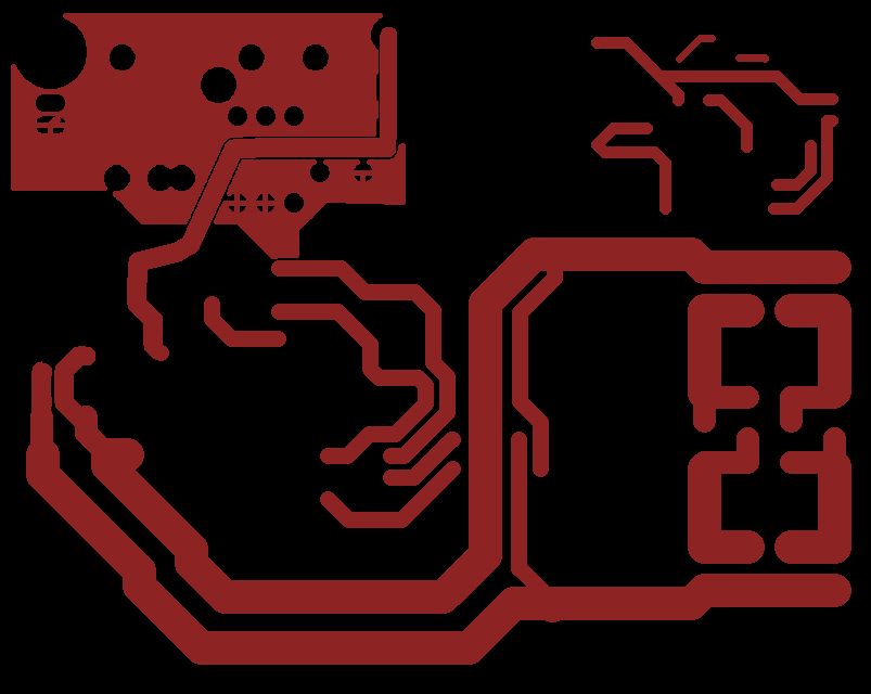

I like what you did with the power amp PSU traces. And it is indeed a very good thing that the ground-plane underneath those traces isn't broken.
It would be nice if you can do the same for the opamp PSU traces, which are not yet totally a parallel pair.
Personally I am not really fond of having two ground-planes overlapping on different layers. I would stick with just one ground-plane only on the bottom layer.
I think you nailed the design down in many ways and you did a very good job. However if one would nitpick, it would be even nicer if the opamp wasn't buried between on the left the LM3886 and on the right the PSU rails. (It is kinda in the "U" shape). The magnetic fields from both sides will radiate through the low current line stage.
If possible and you want to go that far, Try to keep all the high current on one side, and place the op-amp together with the rest of the line signal traces on the other side.
Also, why is there a cut between the PGND connection and the rest of the ground-plane? Can you remove that one?
Hello Bas,
thanks
I've tried but I can't figure out how with those TO220 LM3x7, or with transistors and caps is a so tight space.
The test circuit (on breadboard) is using TO92 LM3x7 but they get too hot, 66°C, aren't they?
I'll check but I like the idea of having some copper to shield that delicate area.
Sadly, in 100x80mm (the maximum size allowed by the free edition of Eagle) I don't have alternatives...
The shielding plane is there in hope to mitigate this problem
I've retained that last slot thinking about your shower and drain...
The idea is to avoid that return currents from the power traces passes through the lower voltage LM318 PS.
I know that in that way they probably radiate but I really don't know what is better...

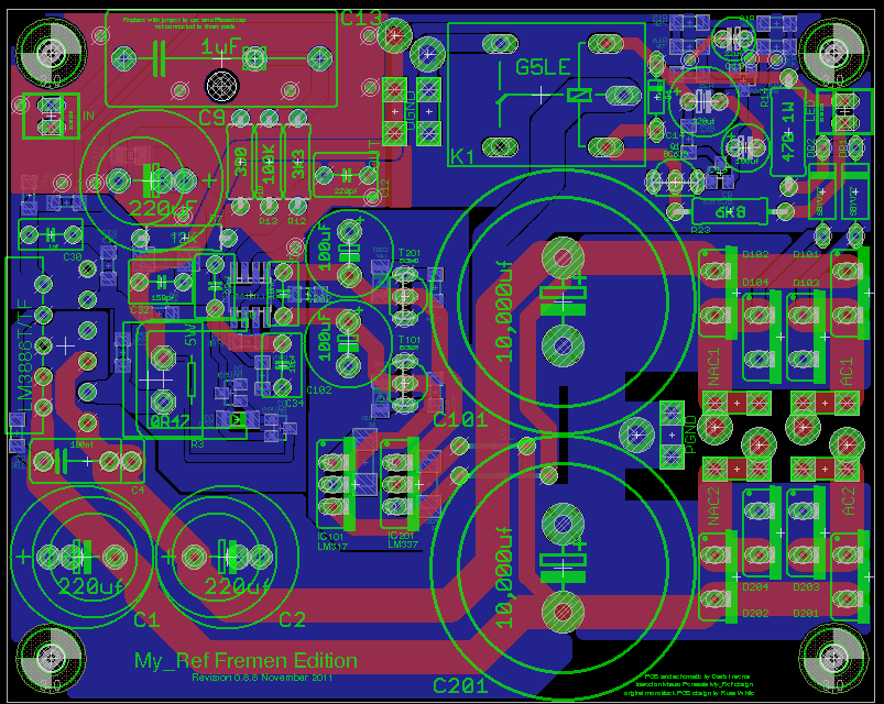

Dario, great work so far. The one thing on the original layout
which can be improved is the placement of the Out terminal.
Here's a quick-n-dirty stab to give an idea what I mean.
The txt file is the Eagle brd file renamed to make the forum s.w happy.

I think the OUT and return should be located further away from the small signal components. The last thing you want is the electromagnetic field coupling induced signals back though the gain stages to be amplified again.
Dario, great work so far. The one thing on the original layout which can be improved is the placement of the Out terminal.
You're right but I can't agree with your solution, look:
Soongsc is right, IMHO, instead, maybe, we could move the OUT GND near OUT... reversing the position of the DC protection circuit... I'll check.

I second this comment. There was one design that did not separate these in another amp, and the sound was messed up compared to the prototype. I had to use the THD measurement (not that I normally use it) to convince them they messed up so my case was supported. When they fixed the layout, the sound quality and THD measurements compared well against the prototype.
Great point.
Sure, whatever is best.

or move the entire power supply to another PCB ? Then you would have plenty of room to try 4 caps, MUR 10100, TeddyReg or even supply for LM318 or LF01What if we dump the DC protection to an external PCB?
Room to grow, room to play ?
What ever you decide, if there is a group buy I want some please sir.
I've already answered to this question on the previous thread.
Penasa was also skeptic about the separate PS.
The actual PS is quite good, if only I could squeeze the space for two more caps (like in the 'eretic')...
No problem, at the end a PCB + smd parts GB is possible.
