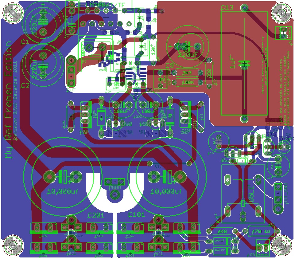

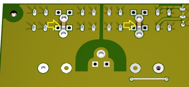

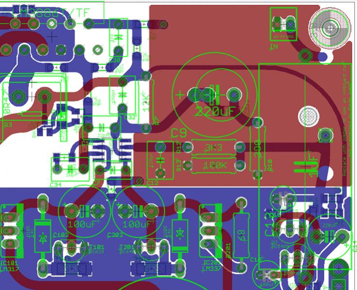

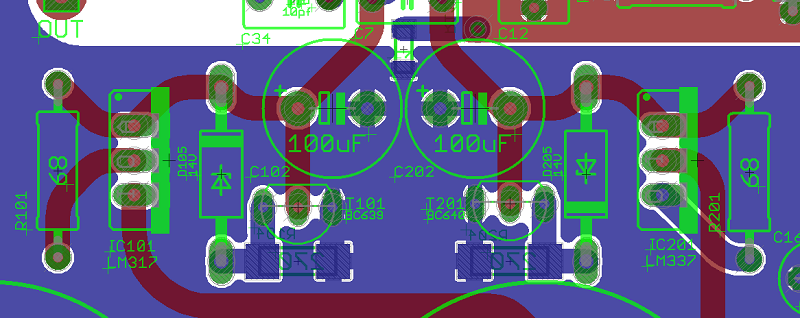

Now that the board is bigger, is there room enough to lay the resistors near the regulators down instead of standing them upright?
Sure, it can... see the attached detail.
But traces are longer and a litlle slot is made to the ground plane, any opinion on it?

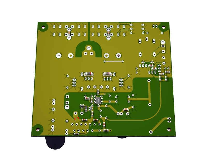

Can you make a little more room around the 318? It looks pretty tight for the caps nearby.
This is more difficult, giving more space between caps would lead to longer traces where lenght is most critical.
BTW I've chosen caps that are big enough to accomodate a quite large set of alternatives.
Perhaps some of the traces with large radius should be straightened again to make the path shorter. I'm not sure what is really gained by using such large curves, but I think a shorter path is always better. Other than extra length, I do like curves.
Can you be more precise? Exactly, to which traces are you referring to?

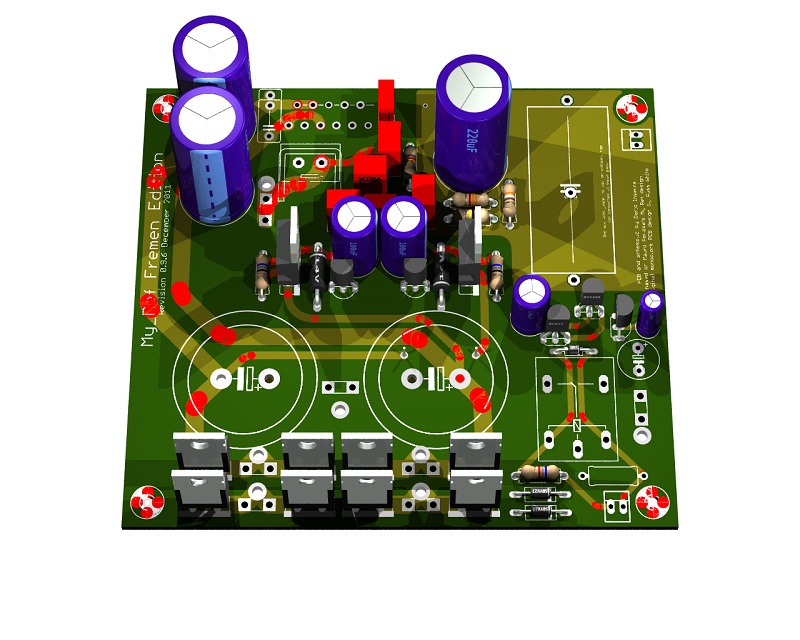

I was also wondering whether it's worth allowing for a larger C13 on board.
When I've started designing the larger board it was one of my goals but the Zn, or similar caps, are way too big to be placed on that board... the Hobbyst Edition allows 100x160 PCBs, unless people is willing to pay me the upgrade to the Professional Edition (840€)...
See the attachment.
Jokes apart it would require enlarging the PCB 2cm more with added cost in production, I would consider it if the PCB should be enlarged for additional circuits, like a second current pump...
But that's a whole new story... The PS would need to be redesigned.

- space on-board for C13
- optional SMD caps for AC input
I think the PCB is ready for the prototype testing.

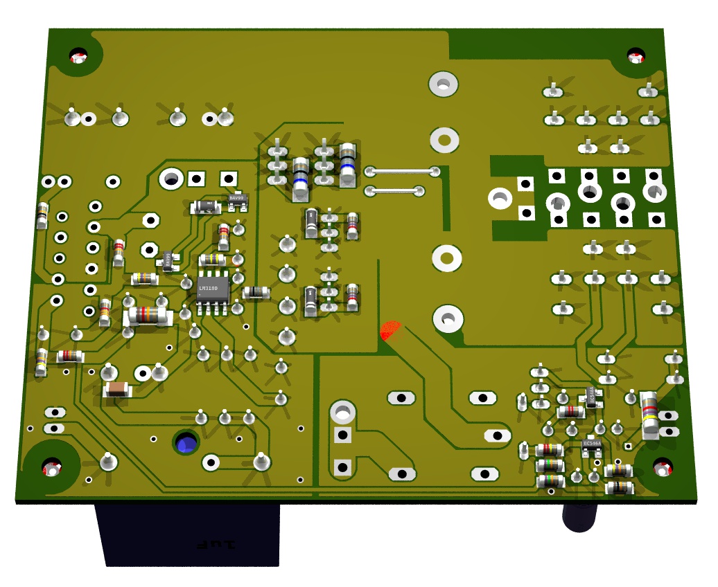

Dario, I think your PCB looks great, I'm following this thread since the beginning, and I will, if PCB ends in group buy definitely build some. For the verification phase I think I don't have enough experience for troubleshooting or measurements.
I have a question regarding the PCB itself, I don't see that PCB is using any terminal blocks or terminal lugs for connecting AC wires to board ? Any special reason for that? sometimes its easyer to work with wires if you can disconnect them without desoldering.

Thanks Maxim
As Soongsc already noted there are both fast-on and cable connection for each AC input and speaker output.
Also signal input and led output are designed for Molex connectors.

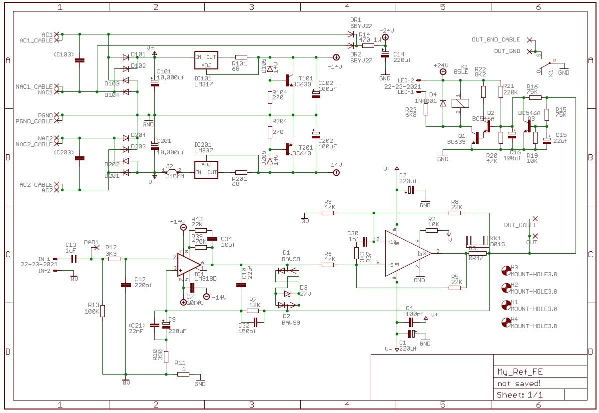

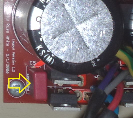

What AC caps are you referring to?
MyRef C had the Lm3886 ground to GND, you said that this board had the Lm3886 ground to signal ground. So which are you referring to as the WoW?
Well, let make thing clear...
The 'AC' cap is marked C5 on TP boards, it's the one on side of rectifiers.
The original MyRef has the LM3886 GND (Pin 7) referred to 0V (signal ground) while the Fremen Edition to GND (power ground).
The wow is obviously referred to Fremen Edition way...
I've attached also the last schematic.
Those AC caps are supposed to be X caps, are there surface mount Xcaps available? I wasn't aware of any, but I wasn't looking either.
Those caps are not specced as X type in none of My_Ref versions, actually I don't think they need to be... they're not on mains voltage.
I've always wondered about the LM3886 ground, but had not tried it yet.
Definitely that mod has a bigger effect than what I was expecting...
I would have expected larger caps for those though.
C5 was there only to damp ringing of the original diode bridge.
With the use of high speed/softrecovery discrete diodes it's no longer necessary, in fact in the My_Evo C5 is no longer present.
