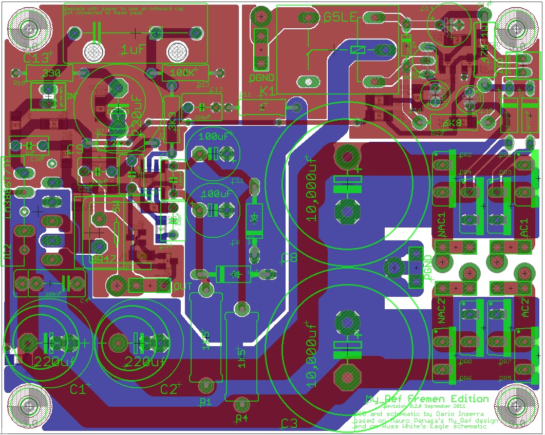

C9 is an electrolytic capacitor, if there is a DC offset across this cap then it's fine. If not, then I was thinking about changing it to an bipolar type electrolytic and add a bypass cap to improve it's linearity. I probably should also try it one one of my chip amps too.
a small dc offset is probable, since LM318 is a bipolar opamp, a bipolar caps works as well, in fact there is people that use a bipolar for C9.
Bipolar caps are bigger though (but the 16mm diameter helps... ).
If C13 is moved off board, then you don't really need an AC and a DC input pad. With a coupling cap, it's AC. Without, it's DC. Correct? Although two pads would allow connection of both inputs at the same time (with two input jacks) and not take up much space, and let the builder decide. Kind of a cool idea. Perhaps just label both pads DC+ input. Then the jacks (sockets?) on the chassis would be labeled AC and DC. Is that what you mean, Andrew?
I can't think of a cap that's equal to the quality of this amp that will fit onto the space provided, so it's just as well to leave it off. Using a hefty film cap to connect input jack to board is exactly what should be done. I don't know what else that space can be used for, but it would allow relaxation of the somewhat tight spacing of other components that exists now.
Perhaps install a mounting hole on that side of the board so builders can physically attach the coupling cap against edge of the board instead of it floating around inside the chassis. I attach mine to the chassis floor with a cable tie, but then I must cut it or detach the cap in order to lift the board.
Just throwing out crazy ideas here.

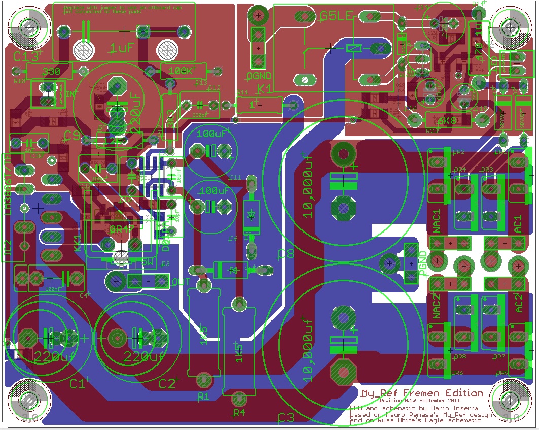

thanks Dario for starting this thread..for me , your design very nice
At the moment for nothing...
And, probably, the input trace crossing R10 is not a problem at all since since between the trace and the resistor there is the ground plane, which should shield...
And that zone is probably the less congested of all the PCB...
Sincerely, I don't think this or the C13 outboard/onboard are high priority problems, first we shoud:
- find any fault of the PCB layout (if possible)
- design the PS for LM318 (here I need help, I'm not good with transistors)
This is a great idea!
Take a look at the attachment, it could be good?
I've also moved a bit the input connector (it was too near to the edge) and used Russ' C13 so the input is a bit farther from the output ground.

the C13 as you describe works fine. just an extra phono socket on the back of the amplifier. This requires a hot&return two pin connection on the PCB.
The Jens' Leach clone was a bit different. It had a single input socket. The "changeover" was done on the PCB using a shorting plug. This requires a hotAC, hotDC, return, three pin connection on the PCB.

Studied the circuit a bit, it seems C13 has to be there mainly due to the floating signal ground which might be connected to the chassis ground of other equipment. The RevC layout allowed convenient means to at a bypass cap on the trace side. I wonder whether it's worth keeping this.
But the concept of the snubber itself is certainly quite widely used and studied. Some people even use it on diodes.
I somehow recall that snubbers are more load transients dependent.
Sorry Soongsc, but I've great respect of Mauro point of view so, at least in this phase, I prefer to focus on LM318 PS and PCB verification.
BTW snubbers can be easily implemented on the prototype PCBs or in the MyRefC, you can test them and then report back to the thread.
Wow, great!
Thanks.
Can you elaborate?
I don't get it...

Dario,
Here's an idea: add one more pad to the right of C13, with a trace to the input path. Label it "DC signal" so that builders can make both AC and DC connections. The label about a jumper wire (and the jumper itself) is then not needed.
When will you be ready to have a prototype made?
