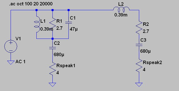

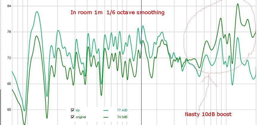

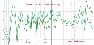

After some PM conversations I would like to make clear I didn't use the Black Beauty original crossover initially because it simulated badly. In the interests of better audio I just spent an hour rewiring one of my speakers with the original crossover and I cannot recommend it.
The result was a very sibilant thin sound and the measurements reveal why. I would recommend that people building this design don't use the original crossover and instead use my design or one of their own devising (as mine doses have slightly subdued treble – for young ears). In addition to these measurements I also found the -3dB point of my speakers to be approximately 75Hz by measuring very close to driver (5mm) at very low volume as to not excite room nodes. Unfortunately I accidently deleted this measurement but there was also a +2dB boost at 100Hz so it might be worth slightly increasing the internal volume of the speaker to get an even lower -3dB and getting rid of the boost. Myself I don't mind the boost at all as it makes the speakers more 'punchy'.
The measurements are far from rigorous conducted in room with the speaker on the edge of my desk at about 1m distance but they do show what I heard. This speaker design is very good but to build it with the original crossover unless your hearing is damaged beyond 8 KHz would be crazy. The scale should be read as relative as no attempt was made to measure absolute SPL and the increase in efficiency of the original crossover forced a reduction in volume to prevent clipping. The microphone is a homemade one using the same capsule as the EMC8000.
The original crossover is to the left and mine is to the right, just used LTspice to draw them.
