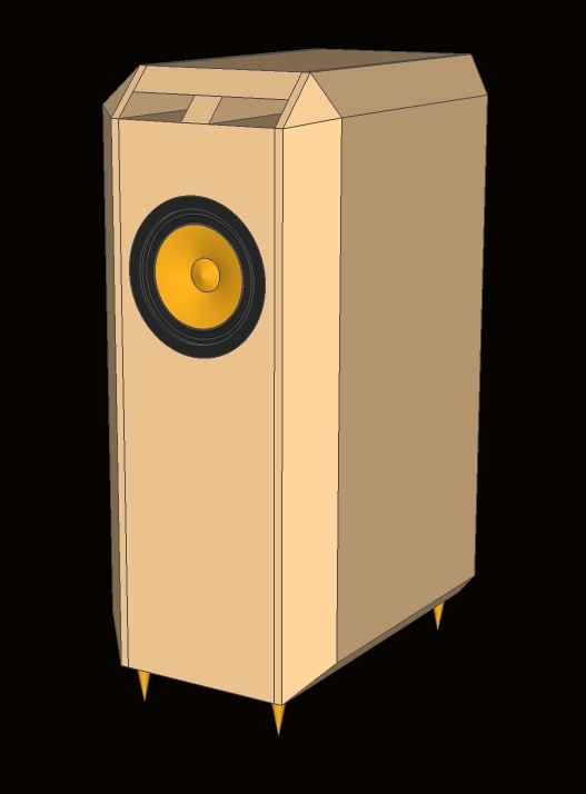

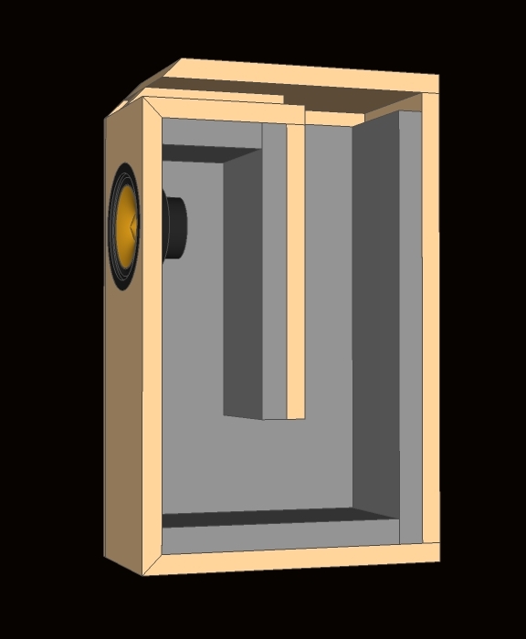

Hi,Dave
Initially I planed to put CHR-70 in Toll70 for my new near-field (1-2m) speakers but then I noticed this interesting project that to my knowledge should have better low freq transient response and maybe go lower than BR speaker (maybe I'm wrong).
The plan is pretty vague about lining of damping material (copy-paste from non-folded plan?) so here's couple of questions:
1. Are you using low or high density acoustic fiberglass for damping?
2. What about lamb's wool?
3. The inner width is only 140mm so one side of 25mm acoustic material seems pretty thick especially at the driver position.
4. The pictures show how I'd like to build speakers and the damping material position. Will that be OK?
Thanks,
Damir

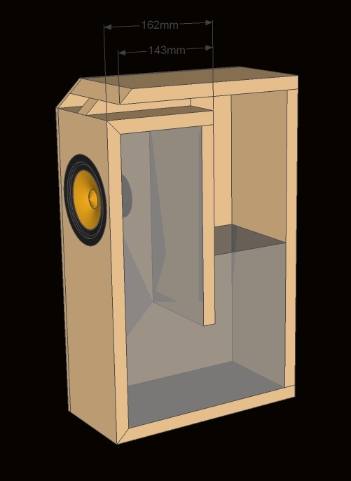

The champher on the top id going to screw up the vent length.
Should notice that I changed panel thickness to 19mm so full lenght of port is 162mm and effective length is (143+162)/2=152.5mm (close to yours 154mm). Will that be OK?
Probably the eeasiest route is to stuff 1st 2/3rds of the line...
Like that? I have the choice of polyester or lamb's wool. What is better?
BTW, is that project for gen. 1 or 2 CHR-70 or both?

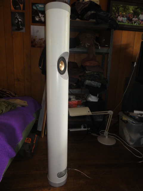

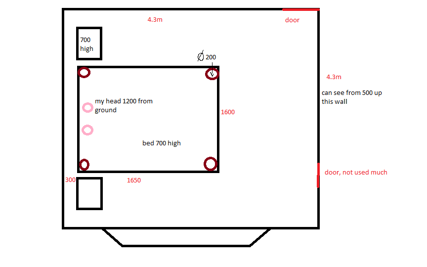

Which ones to build?
Hi guys,
I'm having trouble deciding which cabinets to build for my first project. I was thinking of the pensils but from my listening position in bed I would be looking down on them and they would be partially obscured by the end of the bed and the bedposts, would that matter? I'm also thinking about some speaker on stands that I could put right at the end of the bed or bookshelves on the bedside tables either side. Another option would be on top of the bedposts which stop 400m from the ceiling.
What I have to work with is:
A pair of CHR-70s (not sure which version how would I tell?)
an 8x4 of 17mm pine plywood
A tablesaw and router, drill etc
Attached is a quick sketch of my room. Ceiling is standard height 2.5m?
Any help will be greatly appreciated, I really want to start building asap.
James

milli-sized box mounted near ceiling corners, aimed at bed?
http://homepage.mac.com/tlinespeakers/FAL/downloads/mMarS-1v0-map-231009.pdf
these aren't large, difficult to build, or too heavy for mounting with adjustable wall brackets - and should fit above the door on the left side (you might need to turn sideways?)
Thanks Chris, I never thought about wall mounted, I'll see what that looks like when I get home. Those were the cabinets I initially planned to build until I got this big sheet of wood.
Edit: What about this idea? http://www.diyaudio.com/forums/full...chr-70-application-thread-60.html#post2307533
Also can the pensils be pushed right against the wall or do they sound better standing out a bit?
